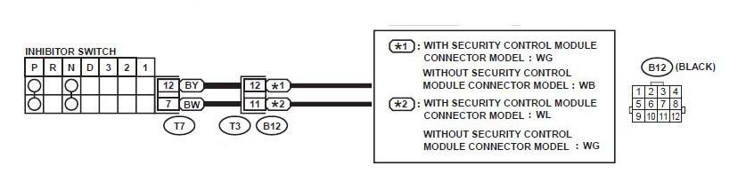

Connector B59 Pin 2 is WB and Pin 6 is WG. Both should be large gauge.
Edited by Rampage
Connector B12 - Pin 12 is White Green and Pin 11 is White Lavender. Jumper together.
Edited by Rampage

the inhibitor switch was left on the automictic transmission I unplugged the wire harness from. Can that same jump be done without it? or should I purchase one?
I see 2 plugs available on the wire harness cluster connecting the inside compartment bulkhead wire harness to the engine bay wire harness. one is B12, I think. can that same jump be done there instead of the inhibitor switch? I didn't see those color wires on the plug I'm looking at, it has pins 11 White Blue and 12 white Green.
Yes, it will be the only 12 pin connector on top of the bellhousing. Lavender looks like blue.
Pin 11 should show continuity to the small connector on the starter. Pin 12 should show 12v when the key is turned to Start. (if the interrupt relay is working OR jumped)
Strip the tape back a little ways and cut the two wires. I would twist and solder them, but you can use a wire nut. If you have silicone grease (dielectric for spark plug wires) Poke the twisted wires in it and then put the wire nut on them. Keeps moisture off the wire. Tape it and the open end of the connector.

B12-11 and B12-12 jumpered together bypasses the transmission mounted inhibitor switch.  Fools the car to thinking its in a safe gear to start up.  I used to have to do this on my 2002 H6 because the inhibitor switch was slightly out of calibration and when the car warmed up it would not start again until it cooled down.   Car is dead when this happens, no crank.  I would disconnect B12 (it sits on top of the transmission), jumper pins 11-12 with a paper clip, start the car, and reconnect.

Separate parts. You know the inhibitor sw. is on the auto tranny gear selector. The inhibitor relay is under the dash. The contacts of the relay and the inhibitor sw. are wired in series. If either one is open the starter solenoid will not get power from the IGN SW Start position.

The automatic uses the inhibitor switch Park + Neutral positions to short pins 11+12 on that connector and the OE manual clutch pedal controls a relay in its place. So both can interrupt power to the starter solenoid.
You could pick up an inhibitor switch and plug it in and put it in park and it would work (until the contacts go bad from never being moved). Electrolysis causes contacts to insulate from each other if they are not moved to wipe off the oxide on the contacts.
