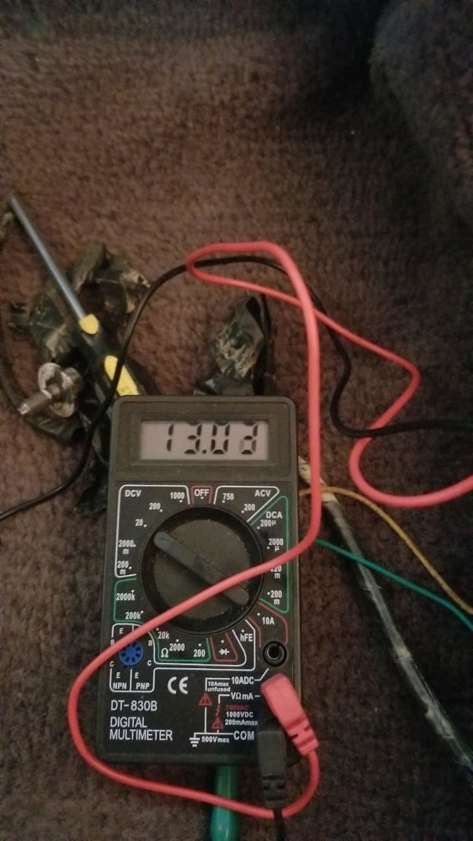

Well it turns out that my dad's Digital Multi Meter is off. It needs calibration and I didnt realize sbout it, only by chance today when I took a cheap one and by chance compared them.. The cheap one reads 12.36 volts on the battery and the other one 11 point something. Now THIS IS significant because I can infer now that the pump receives its needed 12 volts and most likely the car can operate both radiator fans. Ill go down now and work on this. Additionally, the voltage in the car should be working fine.

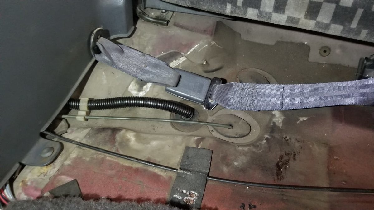

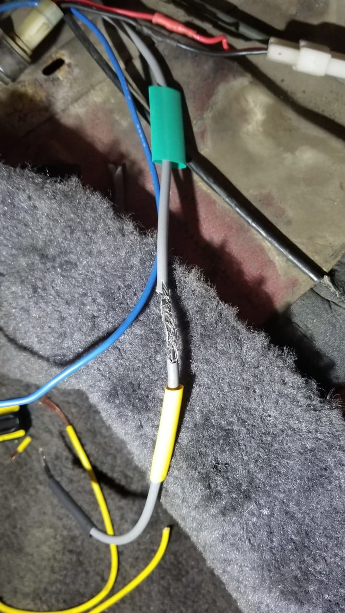

PWM of the fuel pump is highly unlikely.   These cars are way simpler than that.   My EA82s non turbo, the alternator output is low enough at idle to let the battery voltage drop to where it barely keeps up with running the engine.  Especially with other things, like a fan or the ac on.     The voltage goes up to charging level when you get above idle.  The fuel pump obviously drifts up and down with the fluctuations.  The wires to the pump are likely  shielded to keep the noise generated by the commutator and brushes from getting into the AM radio,  etc.
that's what I was thinking but I don't know for sure or have anything to back it up.
I agree with you @DaveT it looks like this shielded wire's purpose is only as a tiny faraday cage/mesh in case of noise affecting the signal coming from the ECU. I have put everything back together as factory specs. The shielded wire does not touch the negative lead of the fuel pump, it stops maybe 10 cm before that lead.
Edited by davepak
content added
Has to be a tiny subsystem to protect against noise, but not to be connected to the negative lead of the pump
As discovered earlier, the DMM is off by more than a volt, giving me wrong readings. So the fuel pump receives the appropriate voltage, (see the pic) which goes up and down as per rpms and battery load..But it is in fact appropriate voltage, the shielded wire's function (the other pic) must be to act as a sheath that suppresses any noise along the wire loom from the ECU to very near the pump as pointed out by DaveT. (now those wires are properly insulated and protected.

Yeah, that angle and stuff effecting the engine running sounds really suspicious.   How does the pump get the fuel out of the tank on this version?   Could the pickup tune have a crack or other failure  that let's it suck air at certain angles  / under heavy acceleration?
Re the sheild - normal sheild practice is that only one end is grounded.   You don't want current flowing in the sheild,  it is only supposed to absorb the unwanted signal.

As per the shielded wire, thank heavens I read your comment about it, I left it as per factory, where only one side is grounded (via the ECU)

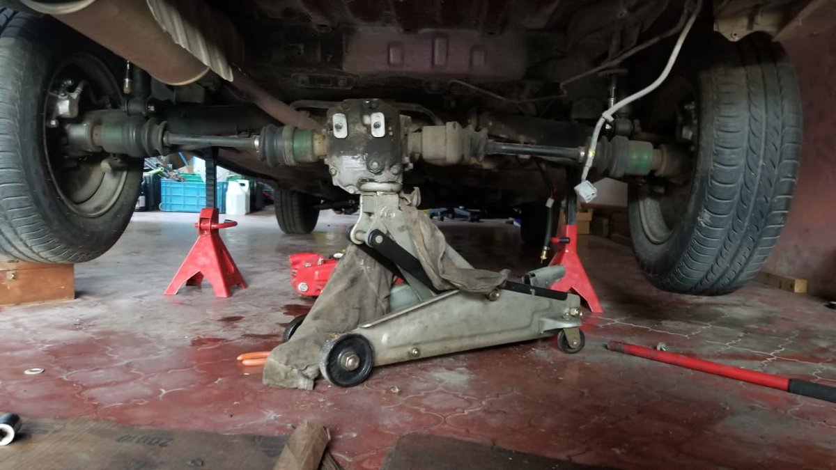

As a PITA as it is, I removed the fuel tank together with the rear differential assembly.

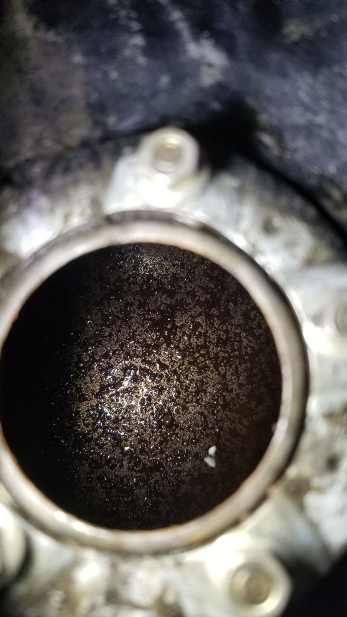

Upon inspection (and plenty of suspicion) I found a lot of debris inside the tank, I also found the tell tale signs of work on the tank before. Someone had already cut the tank to address -most most probably- the same issue. Clogging of the inner filter/siphon assembly. And I mean a lot of debris. Curiously this suction structure is located at the very back of the fuel tank, which in an inclined position will concentrate the last amount of fuel if the tank has little fuel, but also all kinds of grime and debris if they were present. And boy they were.

Is that welding joints in there??

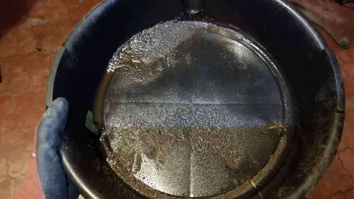

IMG-20210129-WA0022.jpg This is some debris inside!
And the amount I collected on the pan!
IMG-20210129-WA0023.jpgI

When seeing the amount of debris and dirt inside of this tank, I can see why the fuel pump would struggle. Imagine the Gold Rush era, I was holding a pan with so much dirt (looked like ground coffee) that I only wished it was gold!

Debris just like ground coffee, like wet sand, when agitating the tank it sounded like sand inside a giant pan! These are chunks of rust!

Awesome!!!! You definitely found the issue. Well done. You deserve a cookie!  that’s a brutal job to pull the tank - how was it?

That wire of the pump (the shielded wire) was tampered with, here my dad gave me his 2 cents on that, because he knew about PWM, signals, noise suppression and more from his telecom times. The person who tampered there did not know about this and thought a ground point was needed for the fuel pump. But instead, it was a clean, unclogged fuel line what was needed. However, in splicing the negative wire and attaching a lead to the chassis, this would "send loose" the signal to chassis rather than the pulse control as ground coming from the ECU. (A potential additional problem to the ECU)

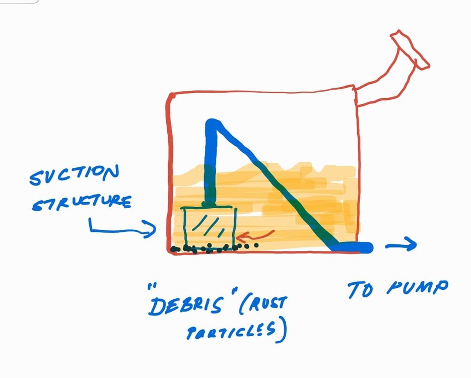

Below is a crude representation of what is inside the fuel tank. That blue pipe ends in what I call the suction structure, right at the back of the tank, where all the debris collects especially if the car is in a nose-up attitude. This will be examined thoroughly tomorrow after washing well the tank and cutting an opening safely.

Oh and @idosubaru removing the fuel tank was not a task for the faint hearted. But not that bad actually, at the end I asked my dad for help in guiding it out. I needed to remove the rear differential assembly (like a crossmember bar that holds the rear differential) quite a bunch of hoses and it was out.

And removing the tank wasn't that bad, but fiddly indeed. I used a jack to hold it in place then my dad lowered it while I held it. Eventually it came out. There wasn't much fuel in it so it wasn't that hard to handle
