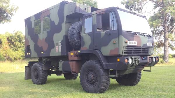

Nissan's are a pain in the neck. If you get anything get a square body GM or a Toyota..... Or one of these (my preference):
GD

One possible route does take us right through it actually. I'm still doing research on which route I want to take. The truck, as delivered to the government, has a top speed of about 50 to 55 so I'm taking that into account. It's also tall at about 11.5'

But remember - truck only goes 55 top speed. Effective final drive ratio is around 7:1
GD

Well..... Looks like we are headed to Tuscon Arizona and up through Nevada and Vegas this trip not up to Colorado. Not sure where you're headed but you're welcome to tag along at our slow speed if any part of the route brings us together.

Oh wow - didn't even think of that! I'll have to ask my guy in TX about that - he has a military museum down there. I wouldn't think they would mess with a camo LMTV with Texas plates but maybe? It is supremely off-road capable so would be uniquely suited to border crossing in the middle of nowhere......
