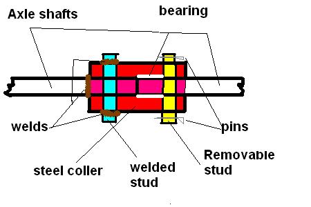

December 16, 200718 yr What about cutting an axle shaft in half.Drill a hole big enough for the "pins" that hold receiver hitches in place on both sides of the split in the axle shafts.Have a strong coller to hold everything together.Then have a bearing in one side so the axle shaft is supported.Pull one of the pins on the street.Put the pin back in place when you want the welded diff. Here is a rough picture I drew in paint.The blue shaft in the picture is a another "pin" for the reciever hitch.just its welded to the steel coller.and the coller itself is welded to one side of the split axle shaft. as long as you are not to hot and heavy on the throttle when you have it engaged it should work...
