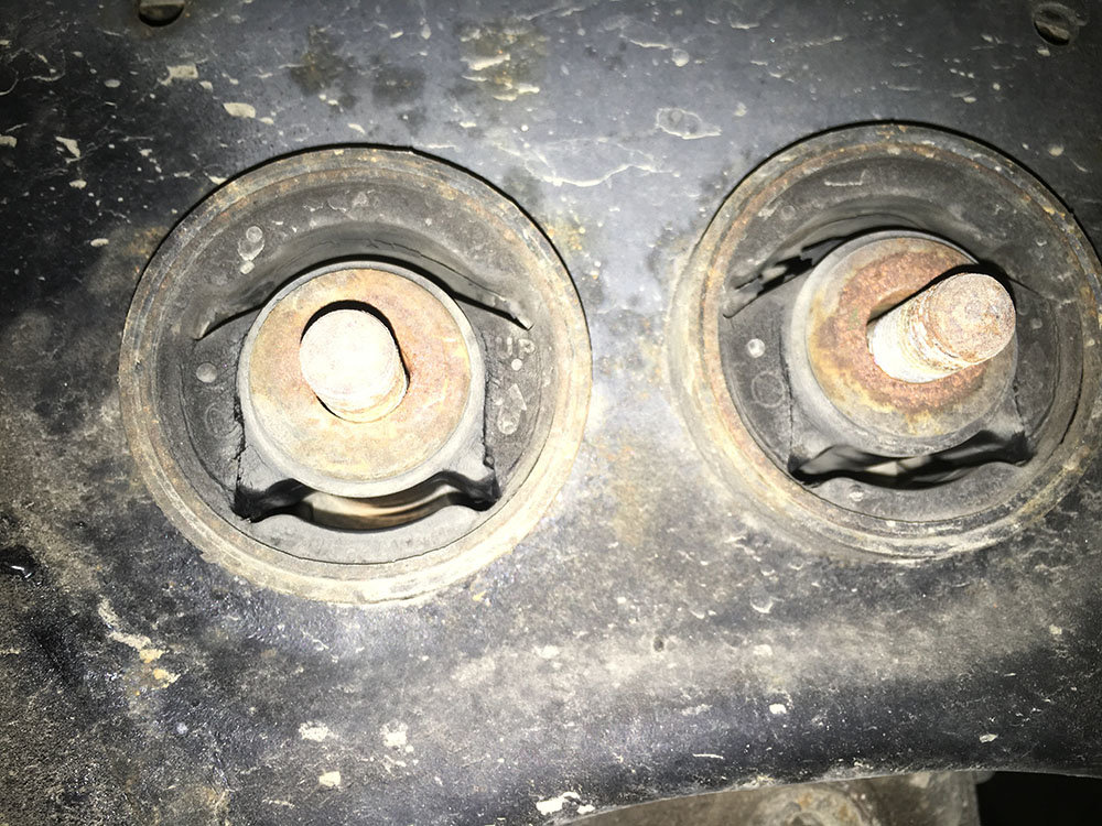

Posted 18 September 2017 - 09:07 PM
Hey guys, i just did this too. Had to trim mine the same.  The bottom of the new insert is kinda bulging out a tiny bit, but i just tightened the bolts and called it good. Thanks for the info above!! The shop was trying to charge me almost $700 for this repair and it took me a whole 15 minutes to complete. 10 or 11 of the 15 was trying to find my sharp razor to trim.  Took it for a test drive and it sure does make a big difference.
I drive a 2001 Outback wagon 3.0 LL Bean  I used Whiteline part number KDT927. Also, did you all tighten your bolts to 50 or 55 ftlbs?
I'll add photos when i re learn how to do that.
Bushing Inserts
Bushing Inserts
Bushing Inserts
Bushing Inserts
