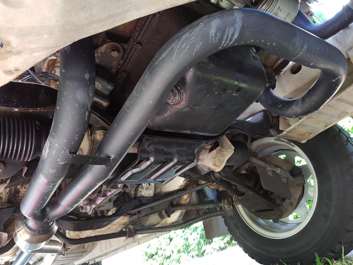

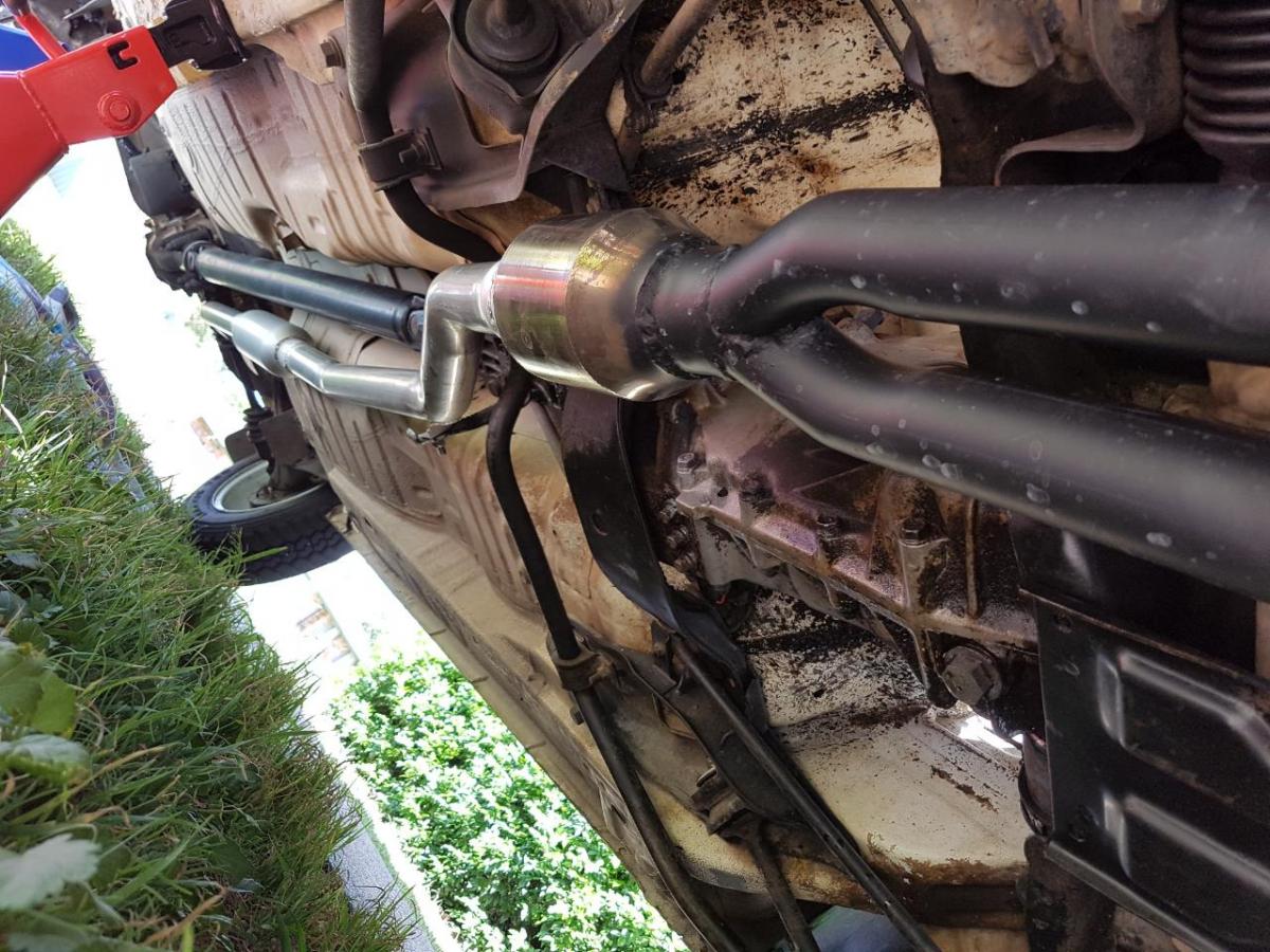

Custom built to my design.
1.75" unequal length headers into a 2" system.
Sounds awesome and makes power !
Attached File  exhaust1.jpg   140.59K   90 downloads

Nice looking header! You weld that up yourself?

Nope. Unfortunately my welding skills are nowhere near as good as that. Found a small exhaust shop that builds custom stuff and gave them a picture I drew the week before.
I knew I was in the right place as soon as I walked into the shop. They had a wrx on the hoist and 3 harleys parked in there.

Uneven length headers don't make more power than equal length, they are less efficient.

Unequal don't make more outright power true. However every dyno print I've seen says they drop 3 or 4hp up top and gain a fatter midrange TQ (where I do most of my driving).
Added bonus is they sound wayyyyy better.
Different benefits and drawbacks, usually decided by space constraints.  In a nutshell, would the extra routing and twists needed to fit equal length headers end up less efficient than unequal length for a specific application.  It's usually not an issue but there are still plenty of examples if you go looking for them.
Mercedes has done some unequal length headers in their cars in the past.  Talking outright power, their 2015 F1 cars had unequal length headers and dominated that season.  Mercedes also did some strange stuff with them way back in the day on airplane engines like having slightly different compression ratios on the left/right cylinder banks to account for the different exhaust efficiency on each side.  You can also find them on high end sport bikes like some years of the Aprillia RV series.  Of course you can't ignore the obvious example of how well they have worked on Subaru's for so many years.
Bottom line is companies with huge R&D staffs full of brilliant engineers have proven that unequal length headers can be a better and more efficient choice in certain applications.  Equal length certainly have more power potential but that is not always true when considered as part of an entire chassis design.  Besides, as you pointed out they always sound better on 4 cylinder engines and that counts for something too.  Glad to hear you are happy with your result.
