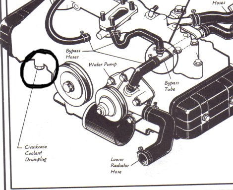

Subaru sells a block heater that works with both EA and EJ engines. On an EA81 there is a plug that you can remove with a 14mm? allen wrench. It's located on the passenger side of the engine. If you look at the attached picture it's the bigger of the two.

Hey... welcome to this side of the mountain!! I live up in Colville. The plug just unscrews and you screw the heater in and run the elect to the sidewall and up to the front of the car into the grill so you can plug it in. They run about 50 bucks but the benefits far outway the alternatives. I would recommend that you NOT use the hose type... they have caused alot of problems like melted hoses etc... The picture of the engine posted before me was too small for me to see it but.... there is a screw in plug on the front passenger side.

Hi, I just wanted to add this picture (it gets big if you click on it).
boing
