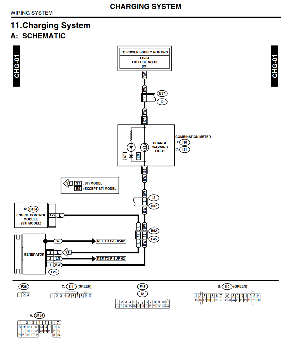

Update- I sourced a used OEM alternator off eBay and it worked for about 2 minutes then stopped charging. Back to the drawing board. Thr only alternator they had worked all thr time is the POS Duralast unit. Just wondering if I should get an old style plug, and wire it in and use the unused ‘98 alternator or might that cause issues with the electrical system?

I replaced the alternator on my 2003 Forester a few months ago with an OEM new alternator. Now I'm finding, with a voltmeter, that either it takes a few seconds to art charging or not at (it takes several starts for battery voltage to go from 12 to 14 volts). I installed a crappy Duralast alternator and it pushes 13.5- 14 volts all the time. I'd rather use OEM than Duralast (it was originally on my Outback when I bought it and I replaced it with OEM on that car). I already have an unused Subaru remanufactured alternator that I had purchased for my '98 Legacy, but sold the car before I could install it. My question is whether I can use the older alternator on my Forester. I'm not that concerned that it's only an 85 amp vs. my current 90 Amps, but the electrical plug is a different shape, although it has two wires like on my 2003 Forester. I figure I could just wire in the 90's style plug, but are there are design differences between 1990's and 2000;'s Subaru alternators that would prohibit me from using the older alternator?
