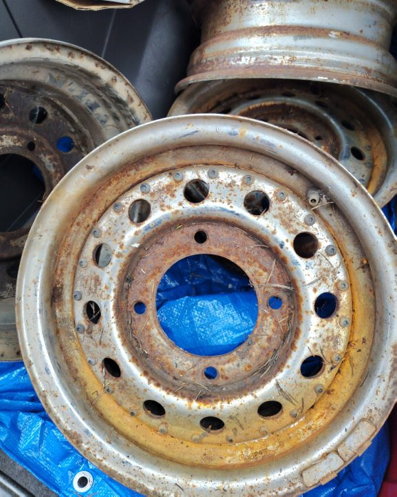

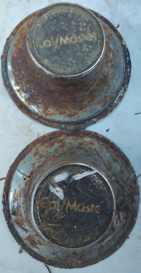

  2. Picked up some was-chrome aftermarket wheels for $50. advertised as brat wheels. Don't know much about them and they need some work and polishing. I'll probably drop them off at a car restoration place. I did find a site the seems to have a catalog scan about the wheels, so I have some specs. https://vintagewheelcatalogs.com/cal-master/ I'm assuming these are Cal-Look wheels for the Volkswagen guys that also happened to be made for Subarus. If anyone's got anymore info I'd love to hear it, like if these folks are still in business or if they got a phone number, also if anyone has any hub caps #1019 I need 2.
