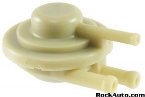

Where do I find the Right EGR Valve?
ihscout54 replied to Sapper 157's topic in Old Gen.: 80's GL/DL/XT/Loyales...
The device has no influance over performance or actual fuel being metered. So ide say no. -
