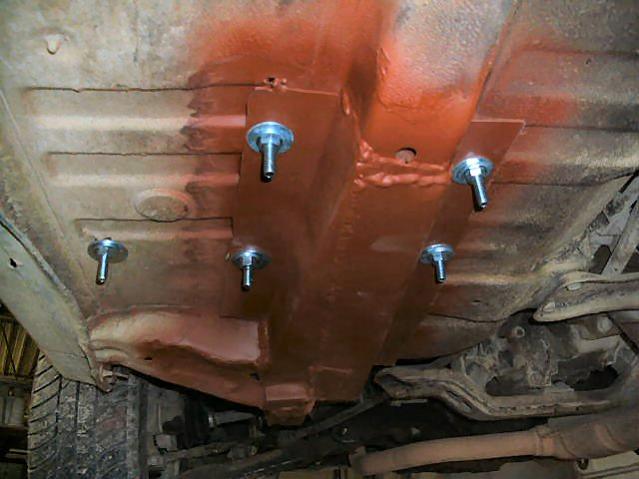

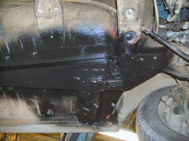

Radius rod mount/frame repair update
It is possible, a little grinding welding, ( 6 hrs worth) , its very solid, i Even welded a 12x1.75 nut and a plate to bolt the radius rod mount to, all i need is 6 hours for the other side, you wont get rich fixing you own Subaru, for sure, but at least when i hit a mud puddle i wont get blasted in the face
