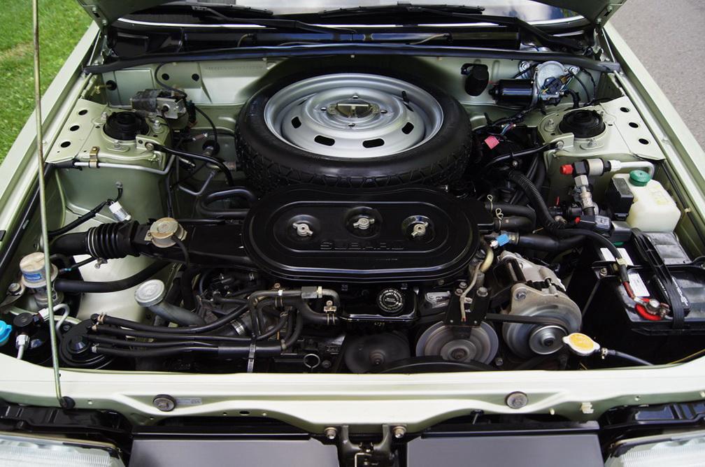

  11. this clean 1985 4x4 sedan on ebay has a weird air set up , it looks like it has been converted to r134a , but the rotation sensor for the compressor is different , is this a retro fit air kit ? , and do the 1985 gl ,s have a black air box. just wondering how stock this is. or has it been restored ?
