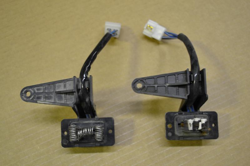

fan resistor coil block
ivantruckman replied to ivantruckman's topic in Old Gen.: 80's GL/DL/XT/Loyales...
i have one here , i have never heard of a switch going bad -
yes i did this same thing to my 86 Gl wag two years ago , no problems -

wow i had a heck of a time getting this out , had to drill 2 of the three screws , soldered some new homade nichrome wire coils in and all set for another 216.000 miles
