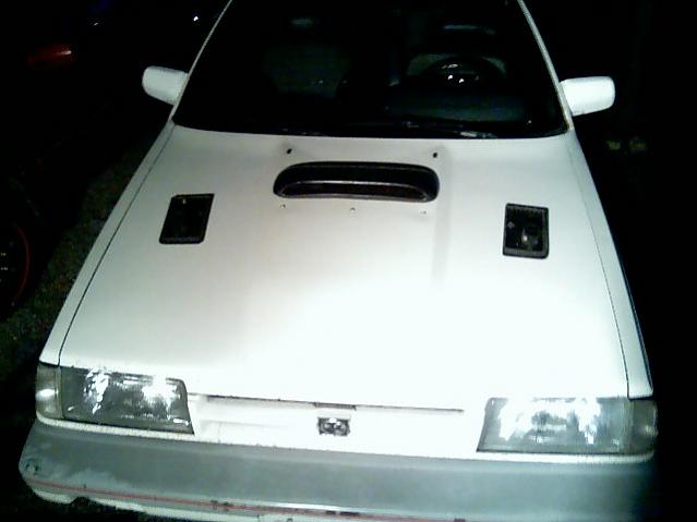

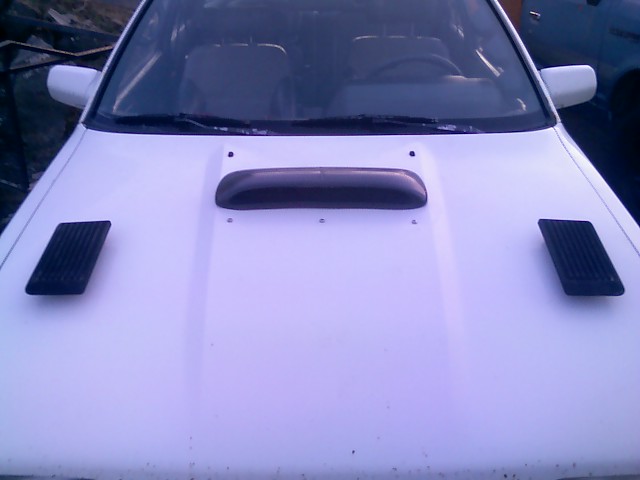

  15. I was driving our beloved Datsun 720 rust bucket at work today when I realized those nifty non functional black louvers (one does go through, but neither accomplishes anything) would look much better on my RX... my boss said no problem, I could have them. After work I popped them off, and laid them on my hood propped up to see what they would look like. I was thinking of those small vents that new Subarii have, but those are $85 a pair and they don't fit a flat hood like ours. So... now I have to make them functional by opening up the faux grill with a dremel and then locating them on my previously butchered hood. I was kind of thinking something near the turbo and maybe doing something crazy with the other side. If I add enough BS scoops it makes me faster, right? Too Nissan-y?
