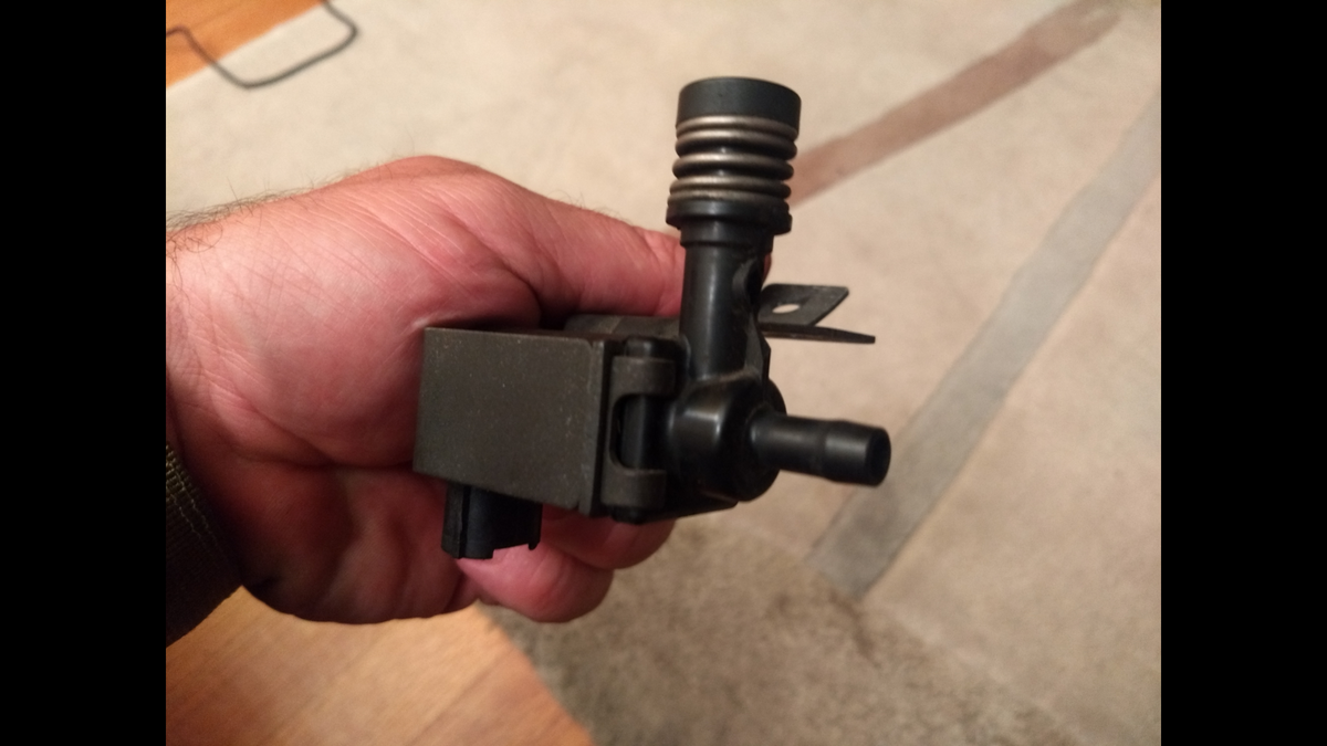

I swapped an EJ22 into an EJ18 car and kept the EJ18 I.M. I snapped one of the fittings off this "vac solenoid" and can't find a replacement or part number for the life of me. I'd rather replace it than glue it. Also, if anyone knows what it does exactly, that would be nice to know. It sits on the pass side of the manifold, just above the purge valve (at least that's where it was mounted when I got the car).

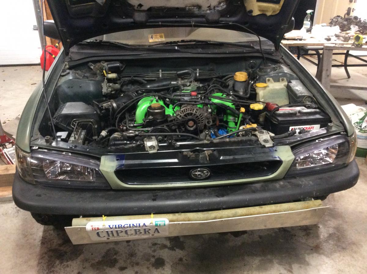

Ok. Everything is hooked up (as far as I can tell) and I'm getting a crank-no-start. It wasn't getting spark until we bolted down two brackets that held electrical connectors on the passenger side where the engine and trans mate up. Seems like an odd ground but I now have spark. Cam gears have the same number of teeth on the rear and I swapped out the cam sensor with no change. Didn't set the timing correctly, perhaps? -

Roof vent done... and for comparatively cheap. The engine is on hold due to missing one flywheel bolt. 8 new ones should be in Tues. then the engine should be going back in.... hopefully.

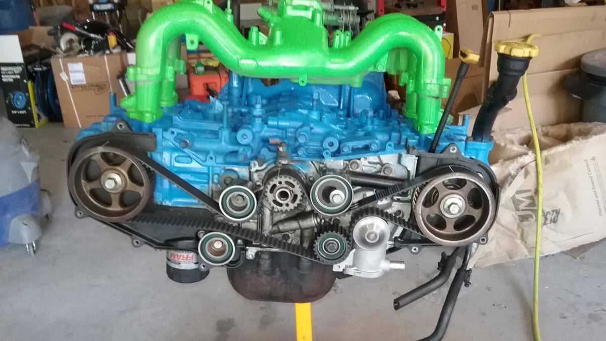

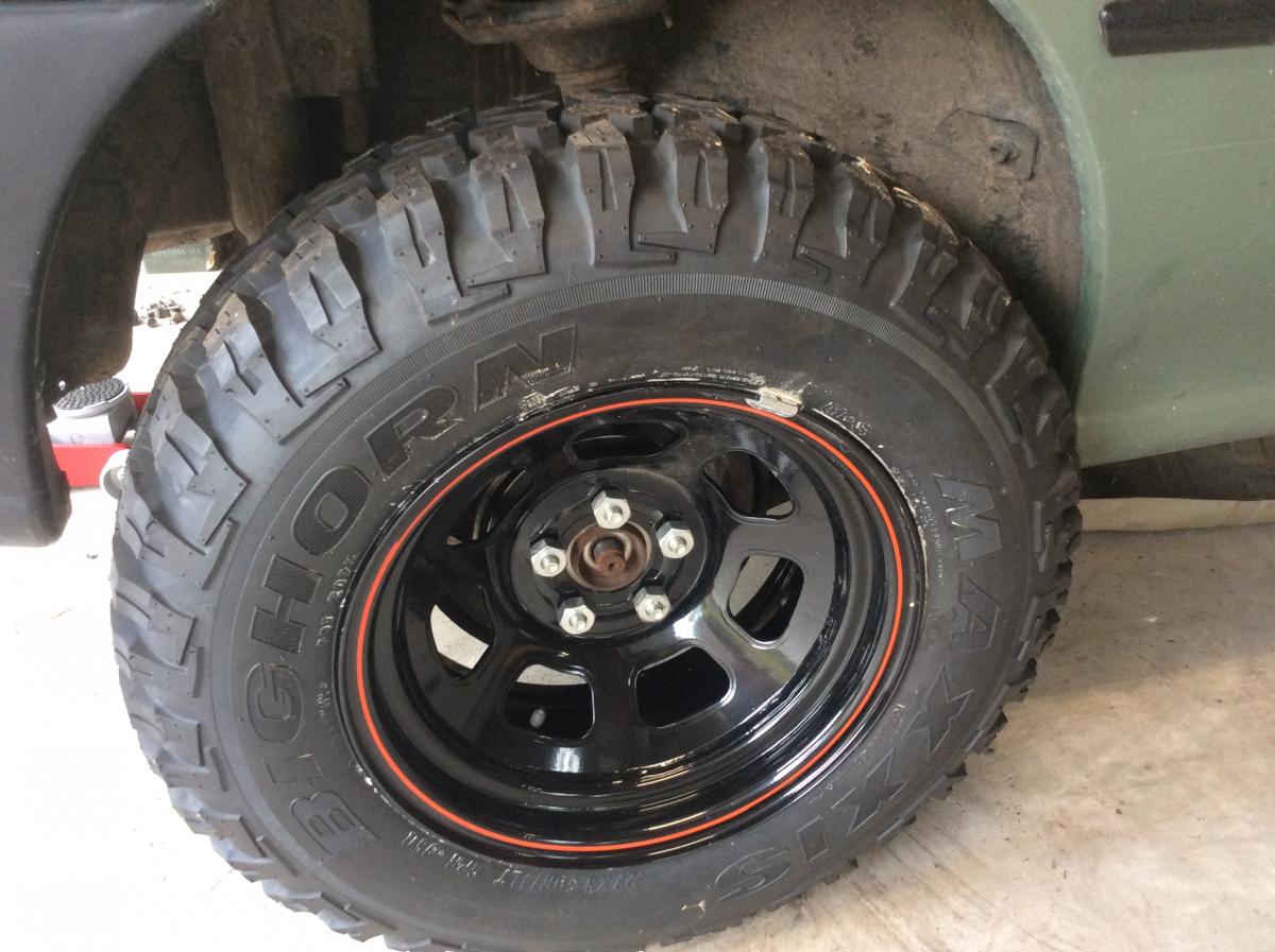

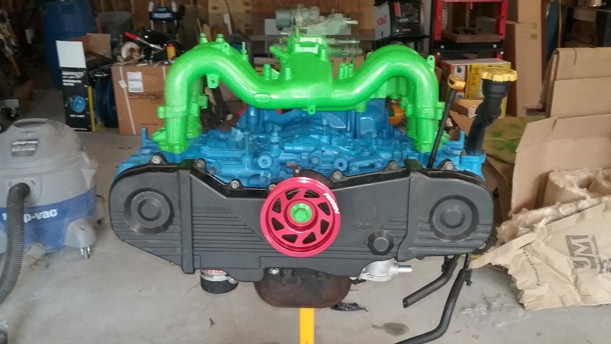

Delta cams installed in the obnoxiously colorful 2.2L and the hubs are re-studded to accept the steelies wrapped in maxxis bighorns. Intake manifold needs to be assembled and installed. Then on to the body and suspension.

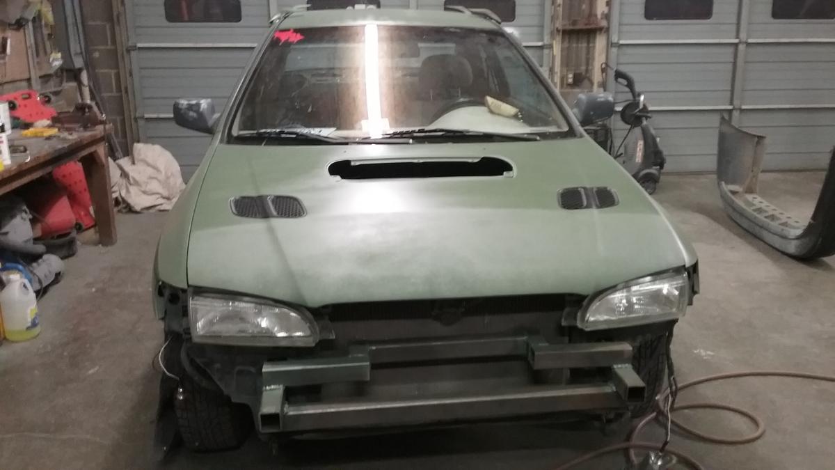

Headlamps and modified corner markers/turn signals are in and the oe rear bumper is back on until spring. Now to get the intake smoke tested in an attempt to find the vac leak.

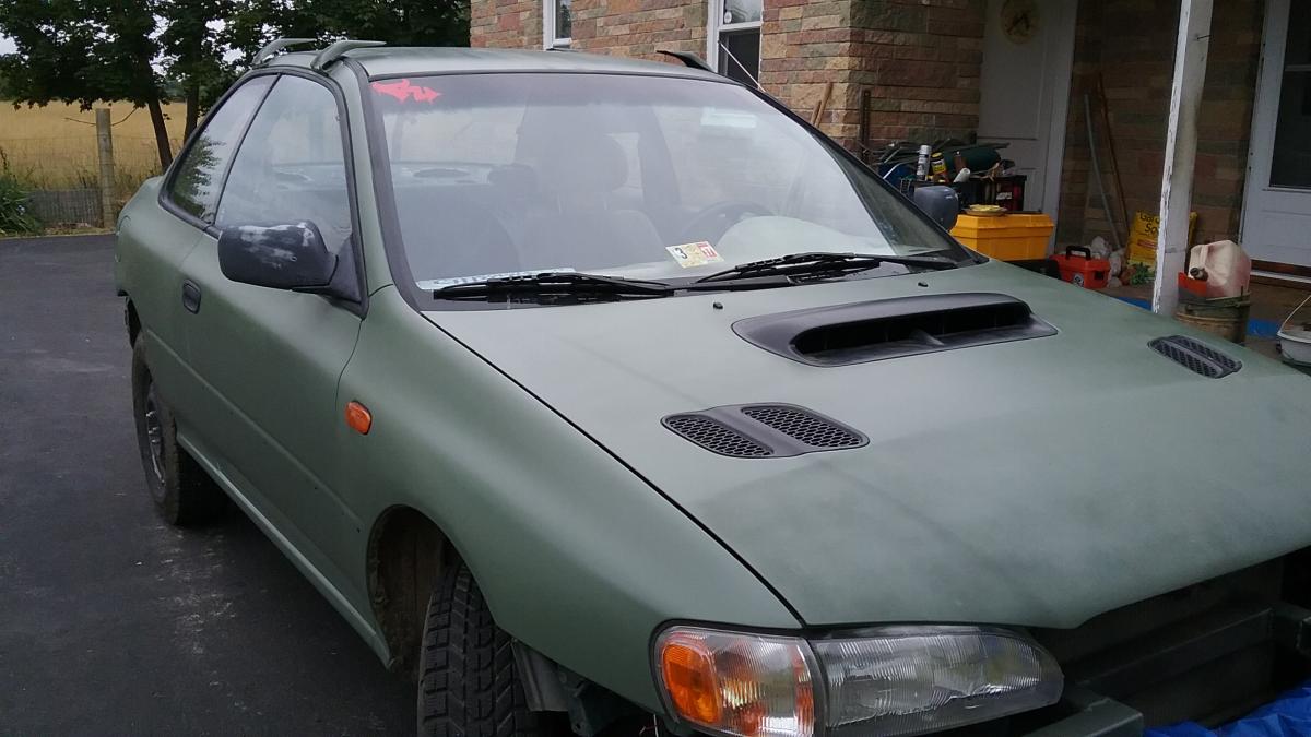

This project has been sidelined multiple times due to work and training but here's where I am, 9 months in. Interior is 80% and all of the shift linkage parts came in. The door locks are fixed, skidplate installed, antenna replaced, and aftermarket headlamps are nearly fitted.

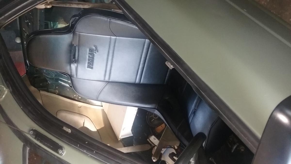

Four months later the little beast has a new color, a winch mount, new seats, and roof rack mounts. It's slow but makin progress.
