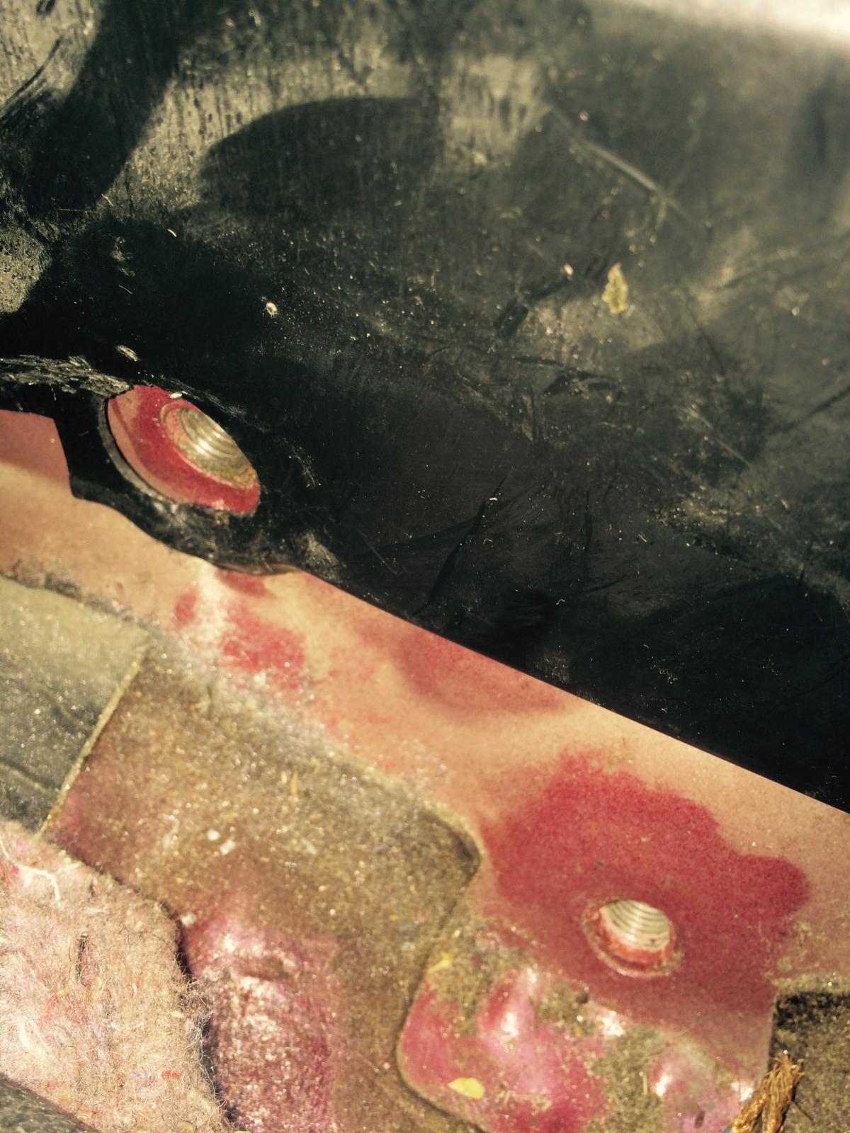

  14. Ok, you know when you one of those DUH!!! Moments...well. Did you notice the postion of the retractor?? It was right in line with the center pillar... Mmm, not correct postion. There are two bolt hole locations, and I only saw the one... The wrong one. The one lower and back is the correct location to anchor retractor. Question, why are there two?? For non-automatic seatbelts

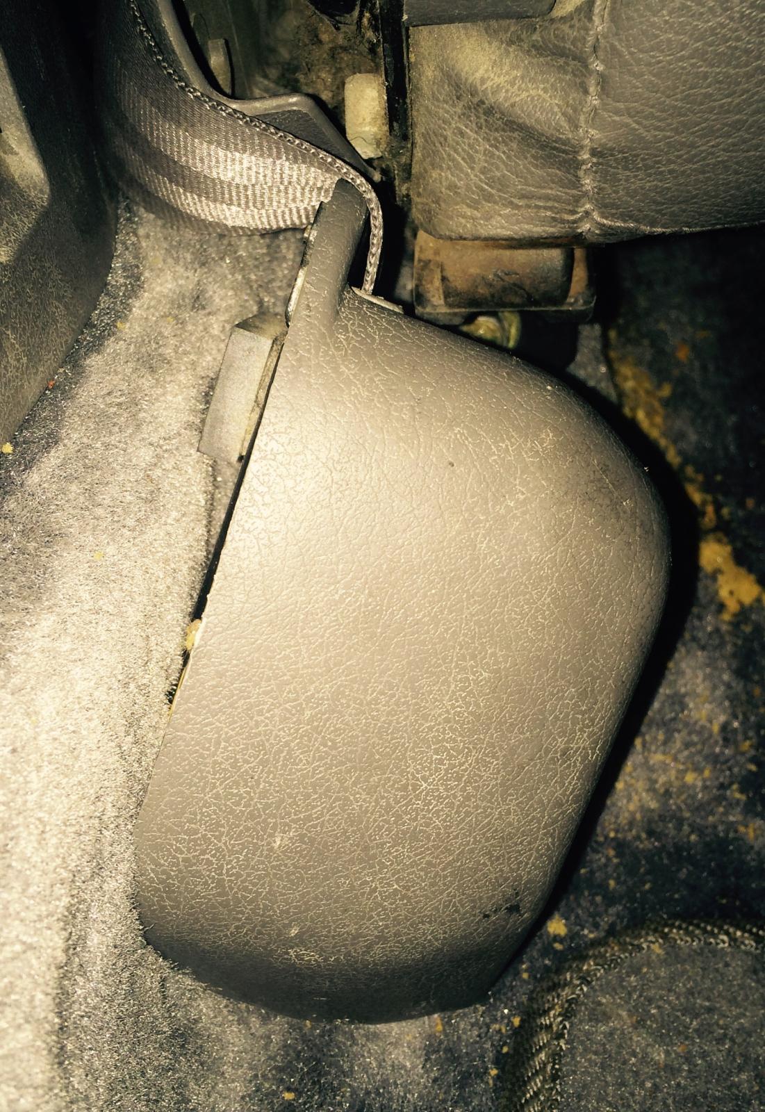

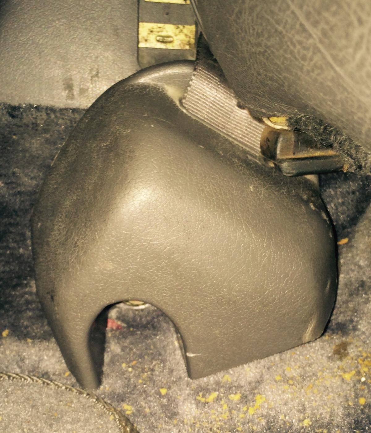

  15. Maybe will help. This is with seat all the way back
  16. Also, when seat is moved forward the the tensioner works... Its a really pain in the rump roast
  17. I replaced the carpet from an 87 d/r ea82 donor, and it looks great. The issue is that the retractors (door side) on both front seats block the seats from moving all the back. I have tried postioning them differently but same result. When i have the tab with two spikes faced to carpet the tensioner, cocks to inside of the car.... Well really any postion it cocks inboard. This postion does not allow the front seats to move far enough for any person height to sit in front seats and the seat belt are locked. I have searched here and with Google and found nothing. Your assistance would be appreciated. Thank you

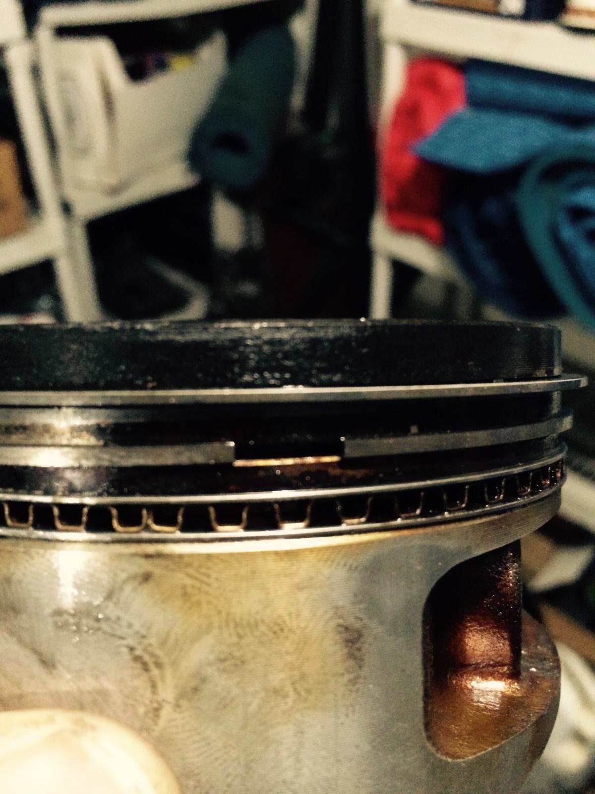

  18. As you can see tge ring is flush with piston.
  19. Well now you know what I know. Sorry, it took so long to update. Oh, and by the way engine transplant was a success. Thanks to I75eya!! Magpie's heart lives on!!
  20. Edit added correct quote: Both of you called it!!!! #1 middle compression/wiper ring is totally stuck.edit** correction Edit*. It was #3 middle compression/wiper ring is totally stuck, not #1 I removed and cleaned it but there seemed to be a rough spot near the gap where it was stuck. Also even with out a feeler guage, there seems to be a tolerance issue. Very tight still... Maybe using a piston ring cleaner would really clean iout.
