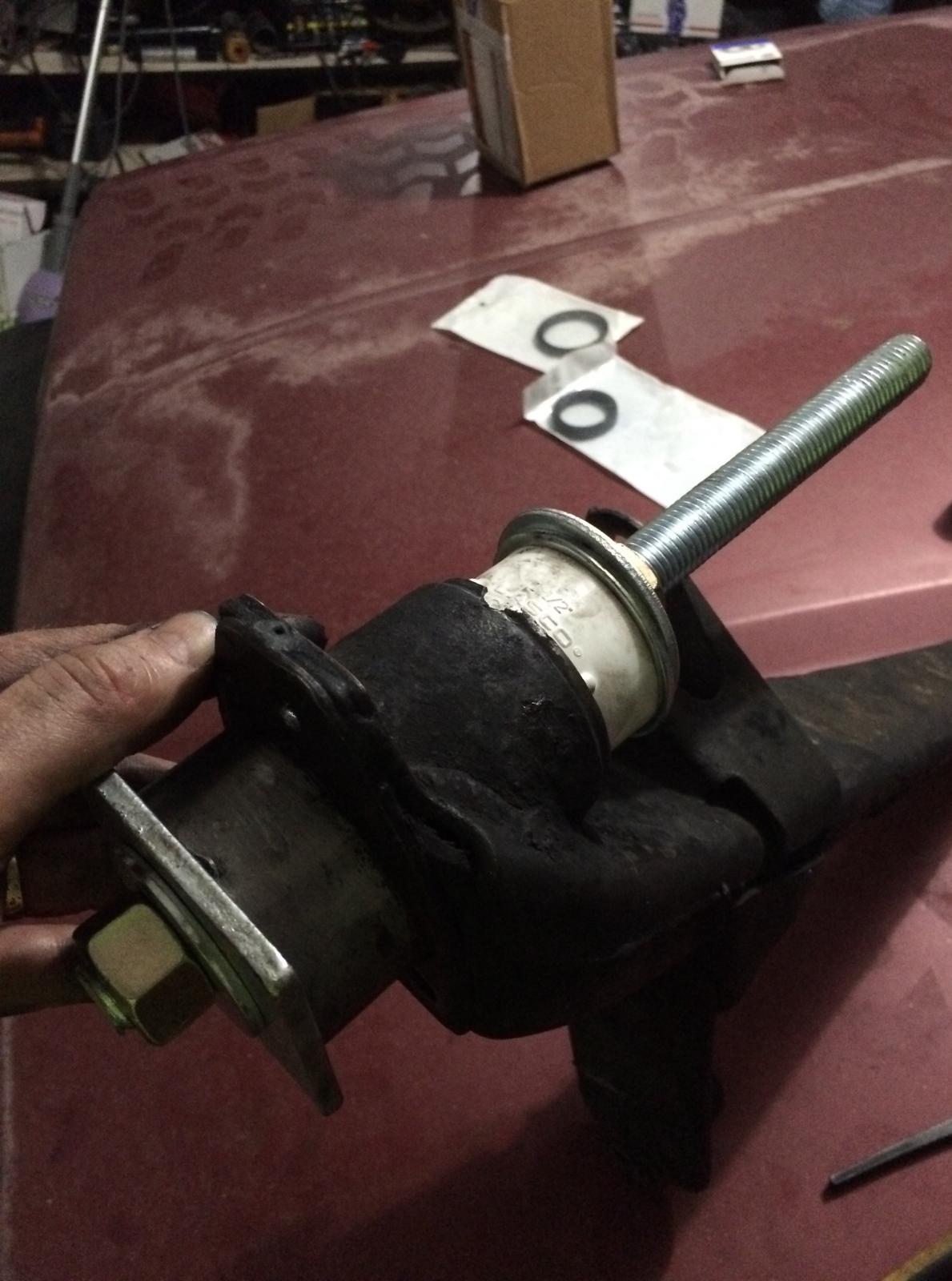

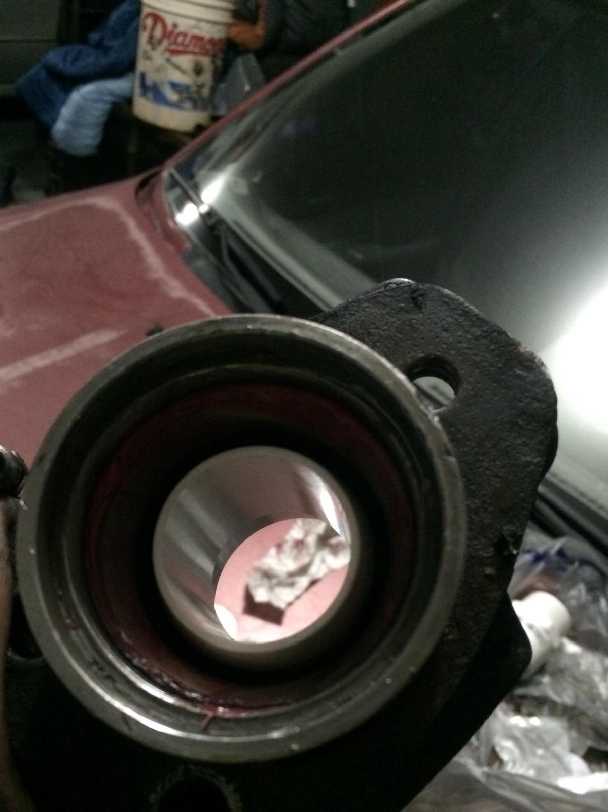

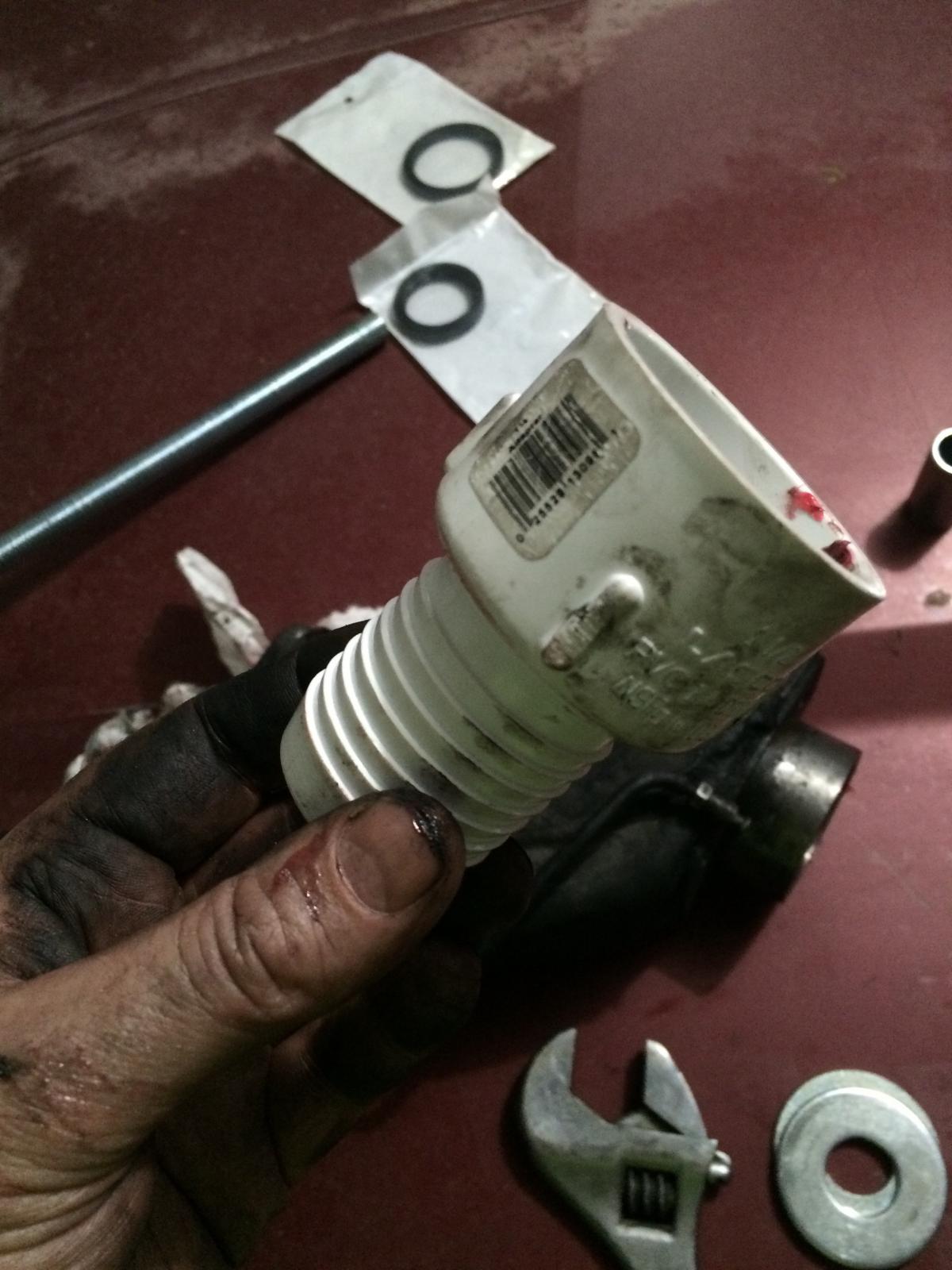

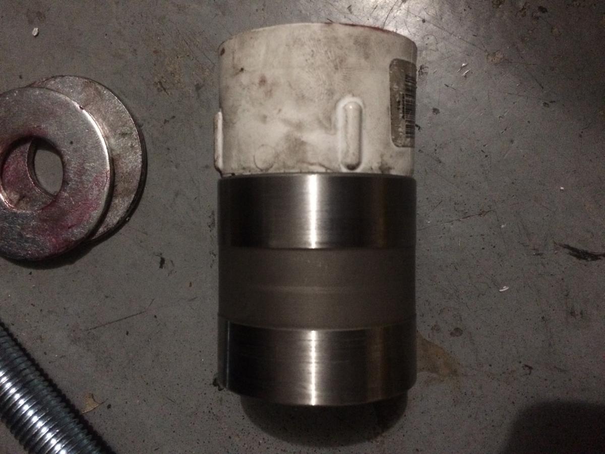

I followed the 4WD bearing guide that 987687 submiited and created my own tool to press bearing sleeve in. Might be helpfull to those that are just discovering there awesome cars. Note: carefull not bang the double jack to far while removing the sleeve it may damage the builtin bearing stop surface. Used 3/4" x 12" allthread 3ea 3/4" nuts Edit: 2ea 7/8" 2-1/2 washers(used over size hole size to make small adjustments) 1ea 3/4"x 3" sq washer ( i used slotted) 1ea 1-1/4 pvc adapter(perfectly tapered to fit inside the sleeve) Edit: used 2ea 3/4" x 2-1/4 also on both ends Center bearing and tool a slowly tight and recheck centering. Then slowly tight inside nut and it just slips in. It will feel like it resisting, continue to tighten slowly.. Till full seats against bearing stop. I going to replace my other bearing soon, so think with some mods it can used to remove bearing as well.- Pictorial wheel bearing guide. 4WD rear.
I made this DYI tool to press in Rear 4wd bearing sleeve in my 93 Loyale wagon 12" x 3/4 allthread 3ea 3/4 nuts 1ea 3/4" x 3" sq (slotted) washer 1e 3/4" x 1-1/2 round washer(placed on top of PVC adapter) 1ea 3/4 x 2" Round washer 1ea 3/4 x 2-1/2 Round washer 1ea. 1-1/4" PCV adapter this was perfect fit As you can see the PVC Adapter protects the bearing sleeve from the allthread. . Just place the bearing sleeve straight in and place the PVC adapter in the sleeve. Then slide allthread inside and place washers/nuts on either end. Tighten but not a lot , just enought to take slack out. Then center the tool , and make sure that sleeve is still striaght. Make small adjustments as you tighten by hand. Once centered... Start to tighten inside nut slowly. Bearing should move easily, i encountered only at little resistance when 7/8 through. Just countinye to tighten till it is a firm stop. Remove tool to check if fully seated. Leave the PVC adapter in place till tool in removed to prevent damage to bearing sleeve. I'm sure all of you get the idea, just though it might helpfull to add to this great write up.- What Have You Done to your Soobie lately? (Please post in here and keep it going)
