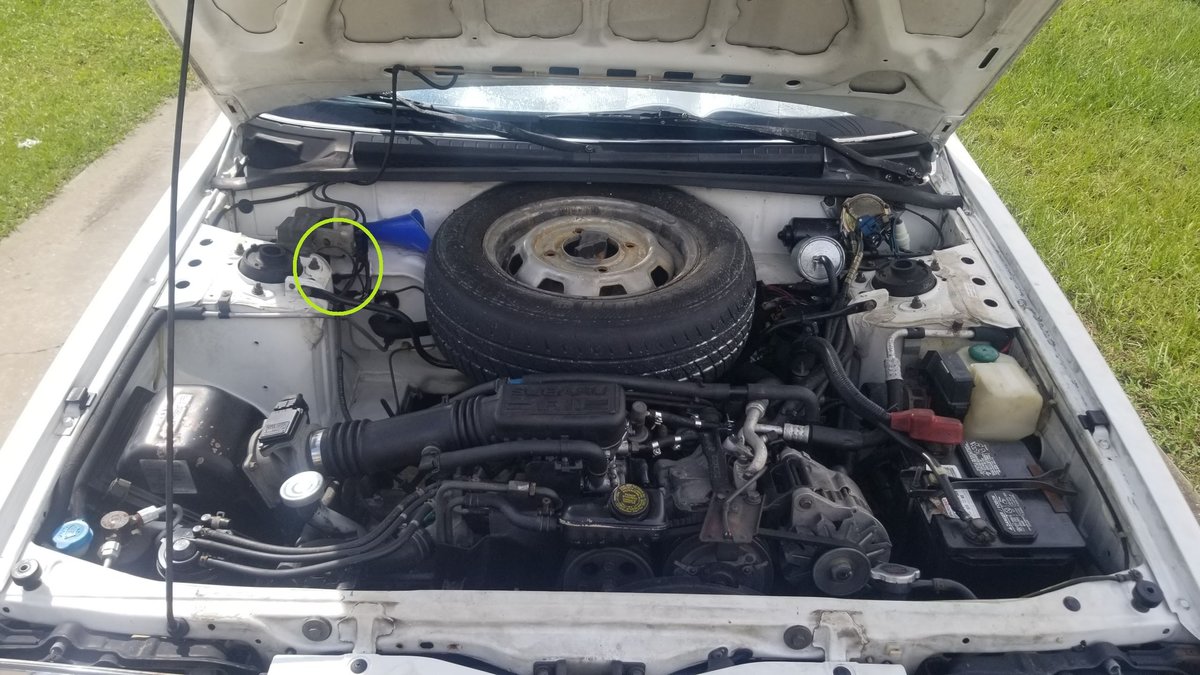

What are the 2 wires by the AC relays for? Behind passenger side strut tower, there are the 2 relays for the AC fan, the vacuum canister, and two loose wires with female spade connectors. Blue with yellow stripe and black. They are right here, you can see them in front of the bracket for the relays/canister:
Ionstorm66 replied to 6 Star's topic in Old Gen.: 80's GL/DL/XT/Loyales...
