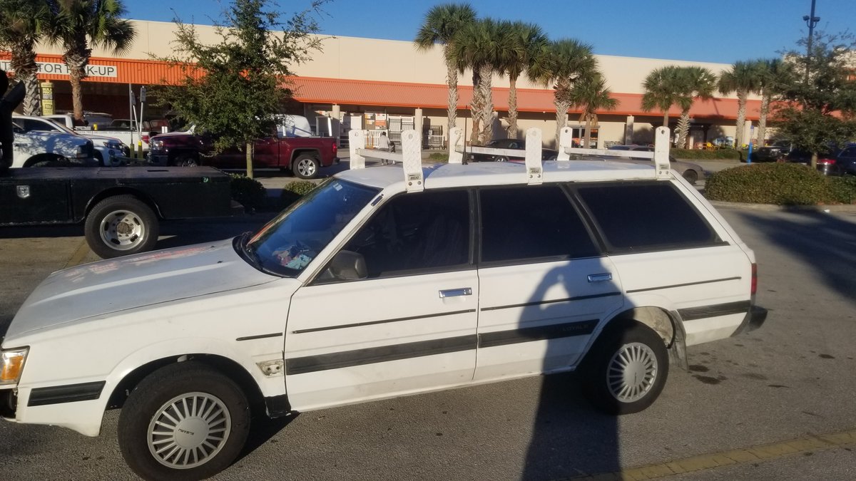

So I scored a dirt cheap set of ladder racks for a van. Fit on the wagon perfectly. Was about 1/2" from being all the way collapsed. 100% overkill, looks like it's ready to be picked up with a crane or helicopter!
