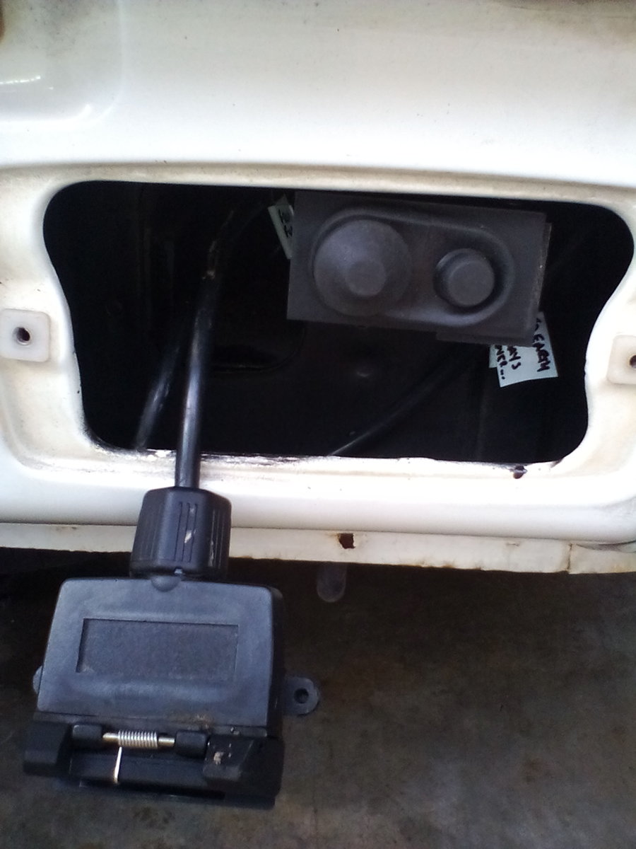

This is my cord tidy The rubber booted door switch provides the Earth for relays to boost the trailer volts up to Voltage for trailer LEDs , only while cover is removed, cord is out. It would have been easier to fit old bulb style lights to the trailer- EA81 indicator circuit voltage loss B.R.A.T.

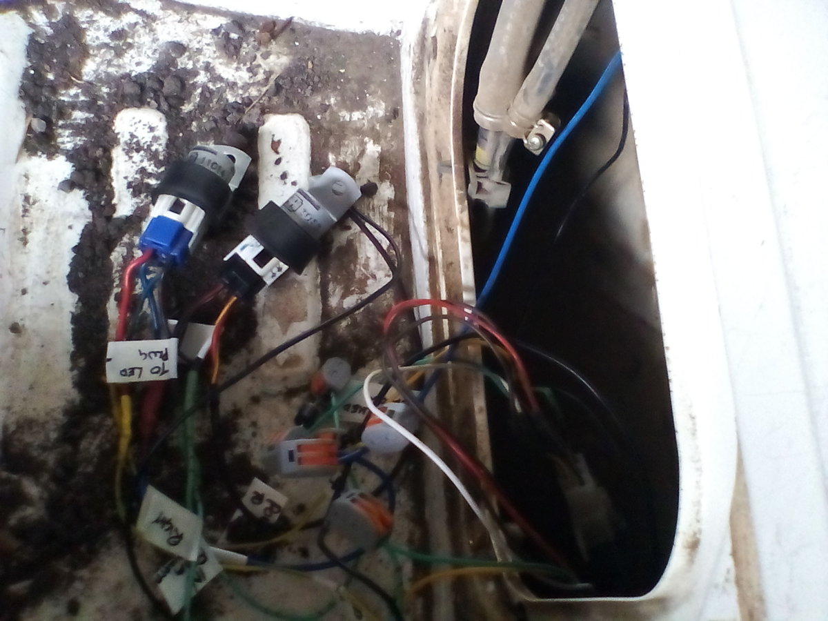

Working like a charm with my little mess of wiring and relays. Going to use our factory relays in their rubber mounts mounted on the inside of the square panel. I left the diodes out for a learning experience The diodes were not needed to stop exciting the coils when trailer not connected ONLY for the hazard light circuit. But with engine running to power up my unused fuel pump circuit now used for powering up LEDs and then to use indicators by stalk, the relays still clicked despite earth cut, until the diodes went in installed my Earth disconnect switch for the relays to not even click when not required With Earth disconnected I could hear a soft click inside , as opposed to operational click. One diode at a time from indicator loom resolved this. Also helped to hook up diodes correct orientation- L Series Front Bumper on a Brat?

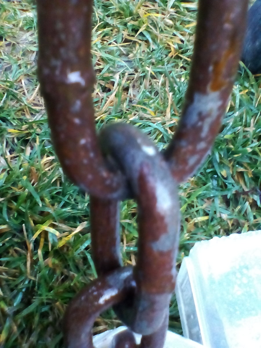

16 hours and this chain was clean! A light scrub with nylon brush and it was all like new. I then soaked more length including first length. So very tidy. I then pulled out a wire brush with brass looking bristles. Scrubbed clean but looked like a golden colour coming over it. Two or three hours later in the cold but drying sun - it was a shiny rust fine dust film of rust again. Totally coated again! Back to square one, but must be prepared with carb soda to neutralise things, heat gun to warm it up and some spray paint- Vinegar + salt + 16 hrs rust eater ! PICS
OK this trick may be handy for some of our old girls bits n pieces. My Brumby attaches to this chain whenever she goes a trailer so post should count as relevant. Was not solid chunky, flaky rust but just fine dusty rusty surface all over. Cheap as white vinegar not watered down, about a litre in a cut down two litre milk bottle, about two desert spoons of table salt and for good measure I left the alfoil in the mix. I was using the foil to scrub the chain after just a few hours but almost felt I had been tricked Have successfully cleaned silverware in boiling water, spooning salt and added foil to water, that goes black with gunk off silverware It rained overnight so some water likely in the mix, butcheck out the chain as I pulled it out. Yet to touch to see if the brown crud comes off easy. Don't think the grey bits are where I rubbed with foil- EA81 indicator circuit voltage loss B.R.A.T.

Been sorting LED light issue on my trailer. Problem is the indicator orange operate but at such a dim light level they are almost impossible to see in daylight. All lights of ute are fine and dandy, so too the stop n tail of trailer I had to install a diode for stop tail circuit to fix problem occuring likely due to pos switching of one circuit, neg switching of other when it comes to stop n tail circuits and only one earth wire in light fitting for three functions. Stop tails work fine since No ballast resistors needed or in use I have found rear indicators and trailer plug only have 8.7 V In case dmm display is too slow for the blink I bridged flasher can to stop the blink - still 8.76V Fuse panel on the blink circuit has12 volts Drops to 10 7 at battery input of flash can Fortunately the 8 volts is enough to excite a relay coil so gonna run new 12 v wire from....well I was gonna say up front from fuse panel but just remembered a life saver.... I have no use for the fuel pump power plug I found in the tray cavity behind front driver side cabin! It should have 12 v IGN in supply to power up a relay for each side, will contain an Earth as well Glad I thought of this before any contortion issues working under dash I did bench test to see trailer plug work a relay from trailer plug to a relay with bike battery to save on wire rigging and it worked Curious if others only got low 8 v at trailer plug on EA81/ BRATs/ Brumby/ MV1800 If you can add input/ findings suggestions appreciated- EA82TT !
