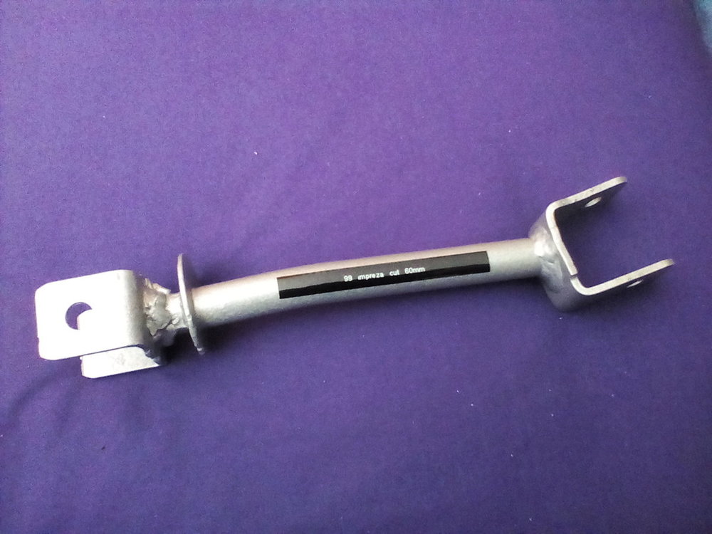

  2. You mean also, don't you Bennie? I am doing this for my 92 Brumby. Taking the opportunity to do the prelim fit. Gearbox just sits in there no flywheel or clutch for convenience. Noticed the stay rod alignment engine to body firewall needs a big think

  4. Cut 60 mm from my GF8 EJ20 AWD 5MT gear shifter and shifter stay rod in an early effort to run the 99 Impreza running gear in my 92 Brumby Yet to prove it works yet so don't take the 60 mm cut at the end near big flat washer to be the way to go just yet
  5. Cut 60 mm from my GF8 EJ20 AWD 5MT gear shifter and shifter stay rod in an early effort to run the 99 Impreza running gear in my 92 Brumby Yet to prove it works yet so don't take the 60 mm cut at the end near big flat washer to be the way to go just yet
