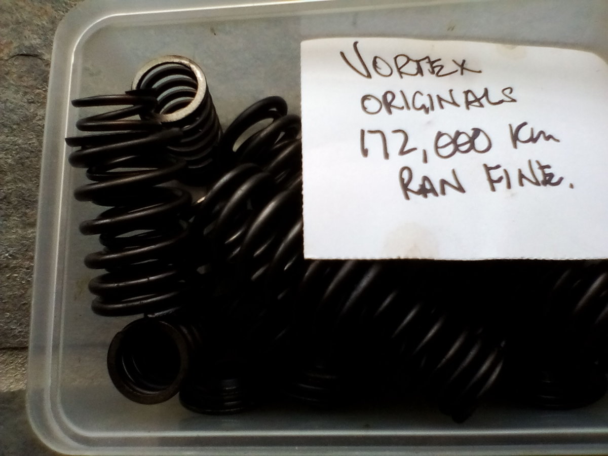

  10. My XT turbo 87.5 valve springs are inner and outer
  11. Ido, when you said learnt the hard way about springs up the wrong way....what symptoms did you have ???
