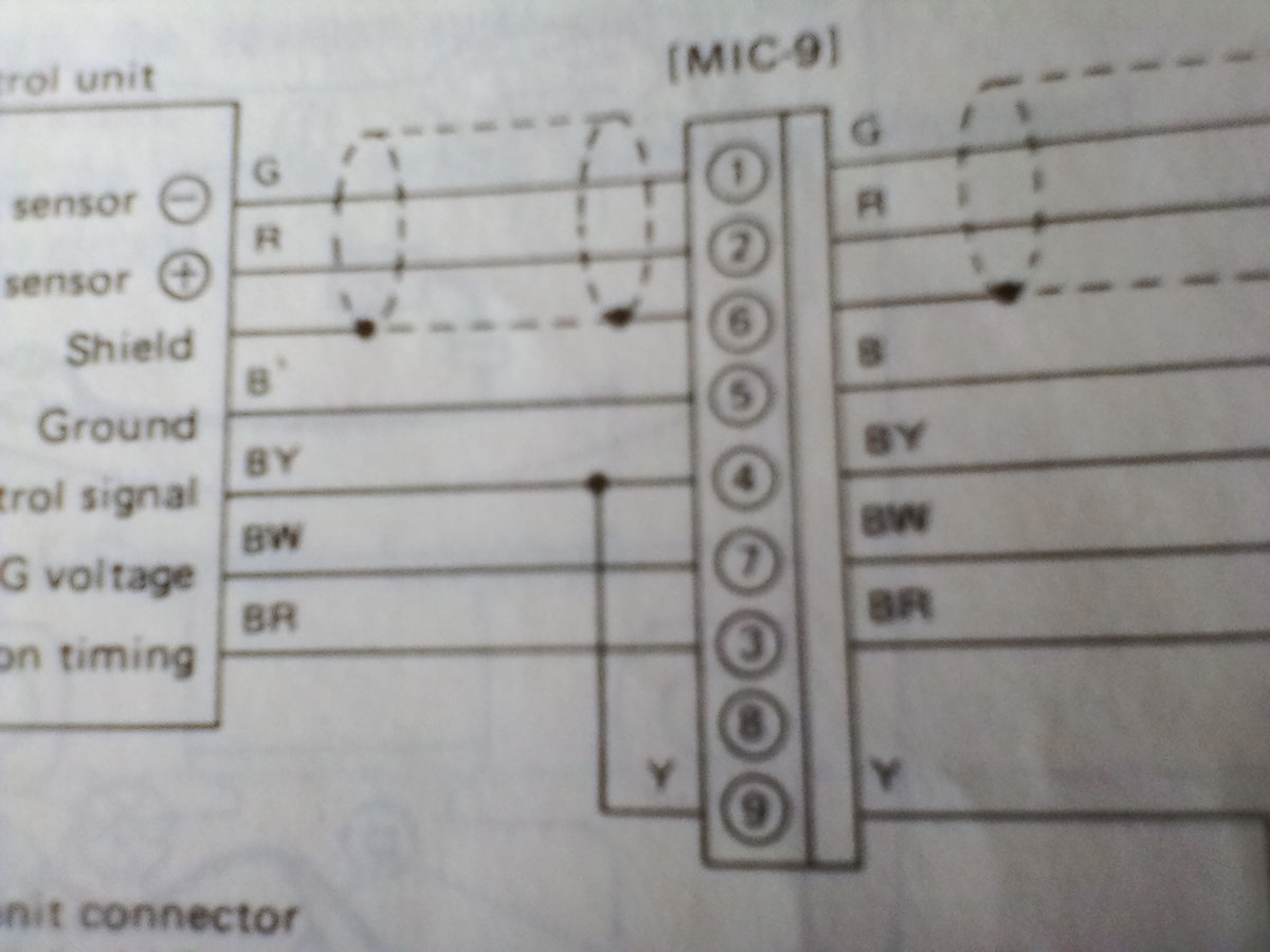

  6. Anyone understand the code used in FSM for such things in wiring electrical Above a sketch is (MIC-9) I think Male Inline Connector 9 pins? It sounds right description of the diagram drawing wise But the diagram showing the actual layout of the corresponding plug is (MIC-9M) A round connector plug (ECJ-8F) It has 8 pins in total And they be Female Circular plug But at Check Connector III (MIC-17F) I think we're Female Yes 17 pin size plug Inline Connector just two rows Then the Yellow wire at coil negative is (LA105) no dash between alpha and numeric. Same at Engine Ground Another check terminal in the loom is a single , white, female, plastic has (MCA-1F) At the two wire knock sensor is a Circular plug (ECJ-2) Circular and 2 wire Should not have C for Circular if C is for Connector so think both incorrect Might be one for General Disorder??
