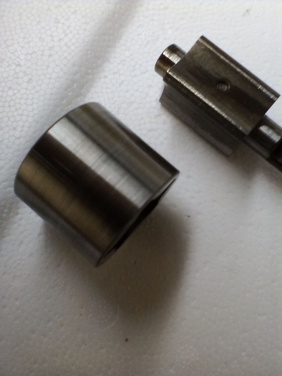

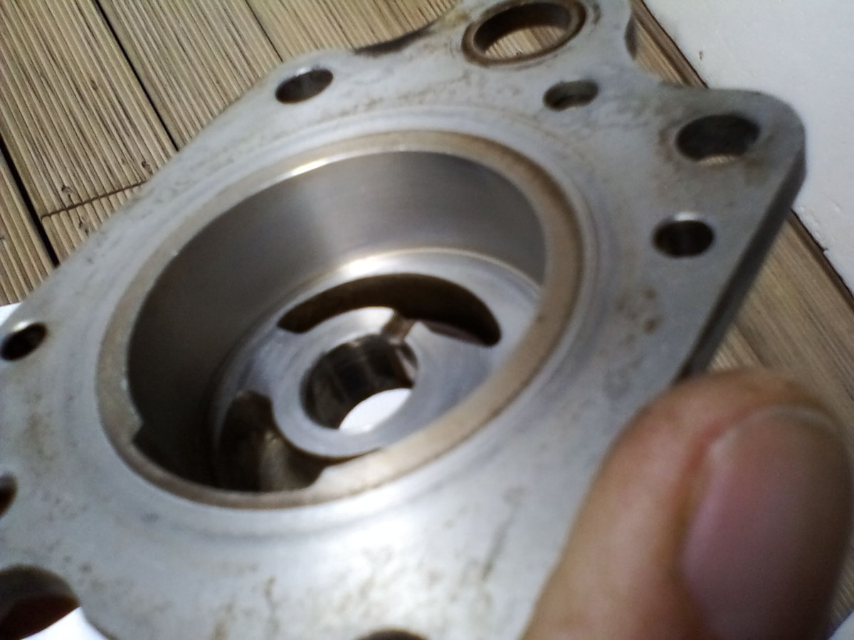

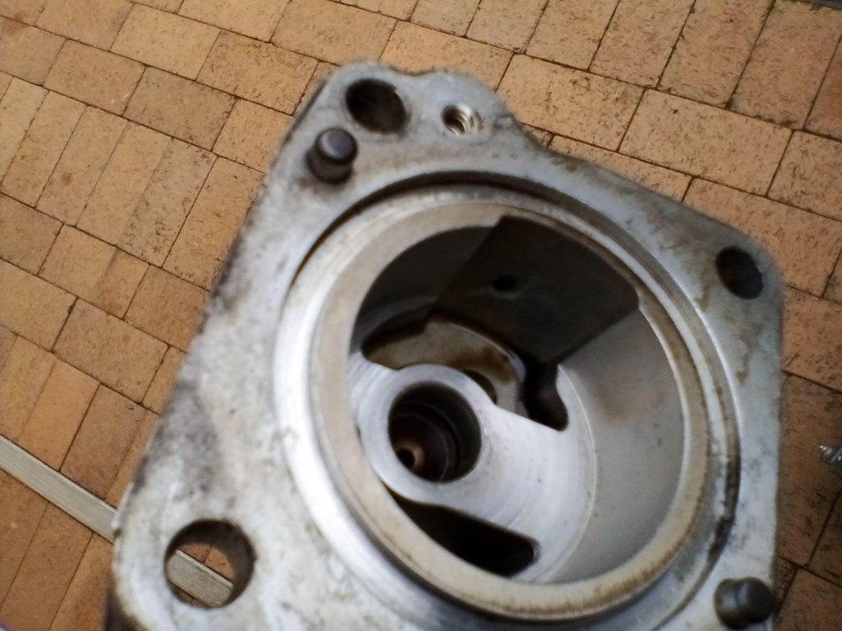

  8. Here in Australia we cannot understand the US needs for oil pumps. Every rebuild I do is devoted, new slugs, bearings and head service The oil pump gets a once over visually, a clean up and run the feeler gauge against manual specs. Here are pics of one of mine, it is yet to be spec'd , has some minor scuff marks where the mating faces are but alloy housings are nice. I had no oil pressure gauge on this engine but maintained oil pressure idiot light sender units so things worked as expected. Weighs 780 grams. Am thinking of listing on ebay Show us your knackered oil pumps ??
