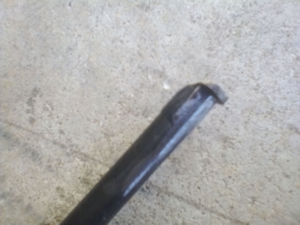

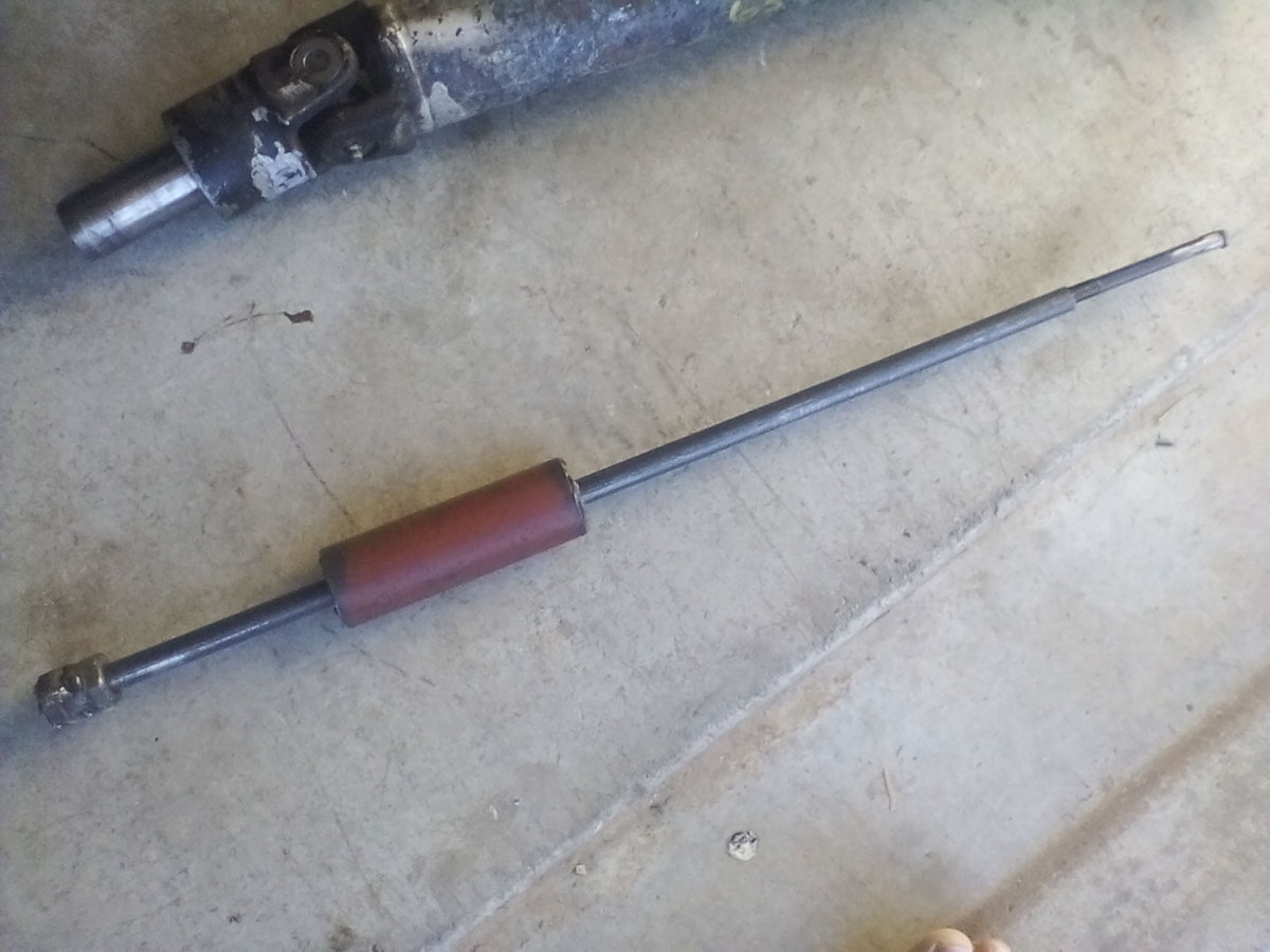

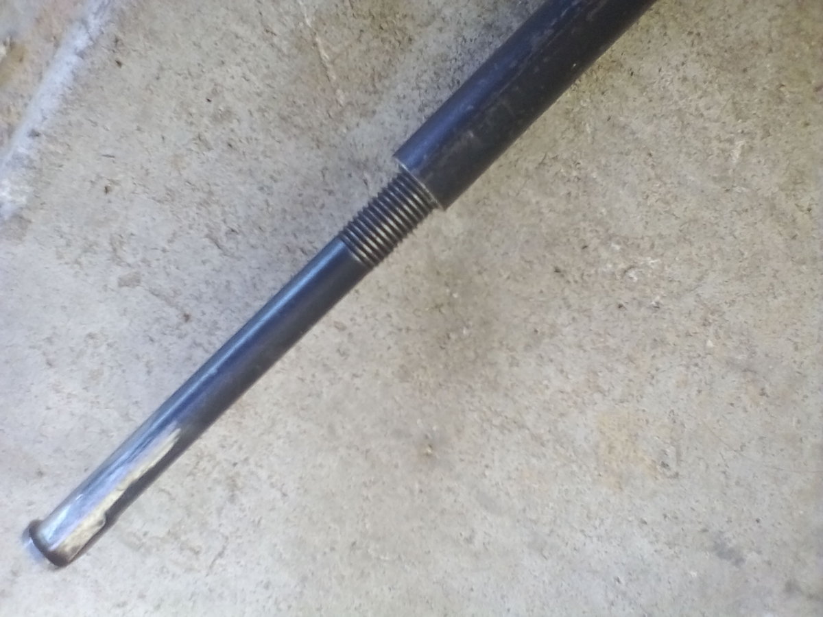

  20. Keep the oil pump and all the belt drive cogs off crank and cams Ricky. The EA81 gudgeon pin extraction tool Part # SUB 399094310 STEPPY Made from an old head bolt if some old Ford, ground down to make use of a lip. Plain mild steel rod then drilled, tapped same thread female as head bolt, add slide handle from steam pipe, washers etc. Strong enough to pull block around floor as I ease gp out
