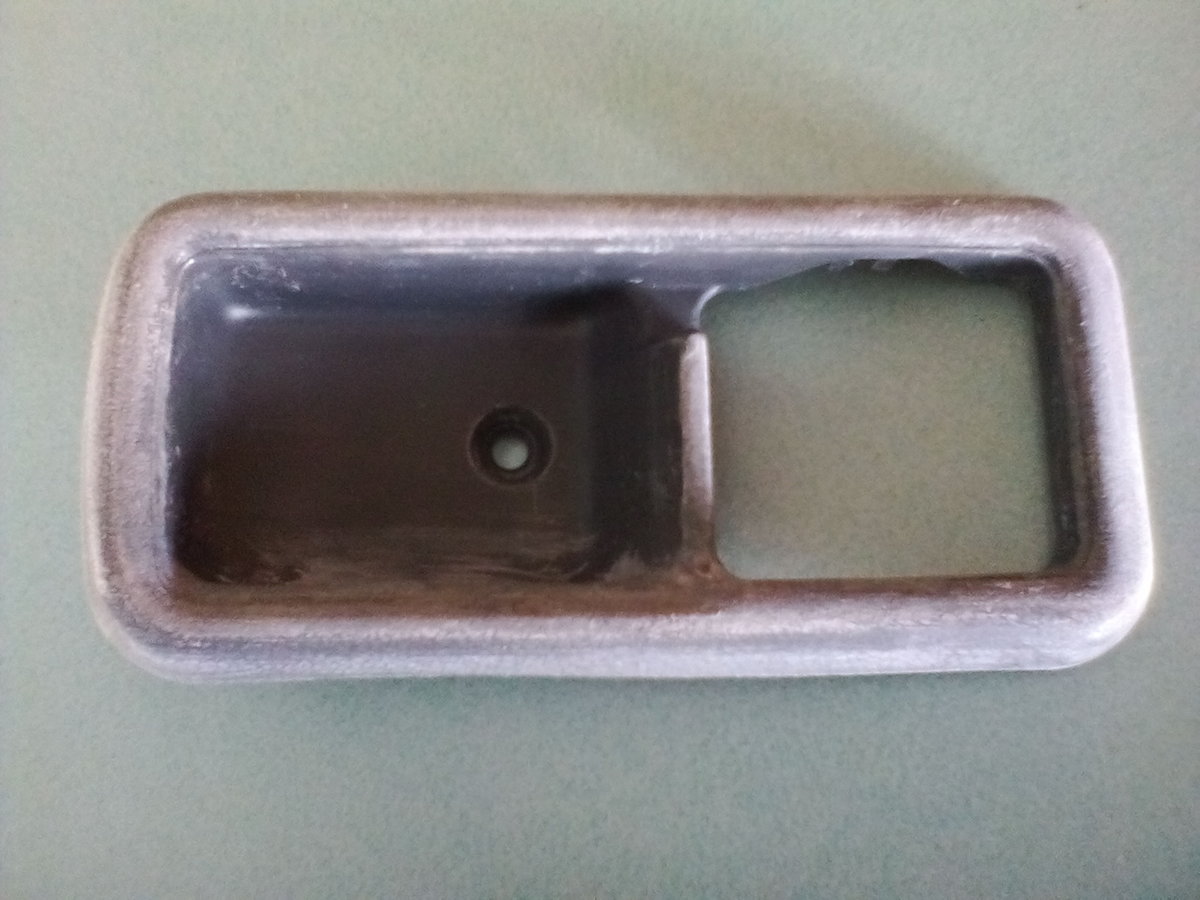

  3. Proper part name ? Trim ? Trying a restoration on this one.. Have had many years extended life by painting my first set with a hammer tone epoxy 20 years ago Just scored these... Front and rear doors appear to be the same, just handed for each side Gonna try a few with vinyl spray...until someone goes repro
