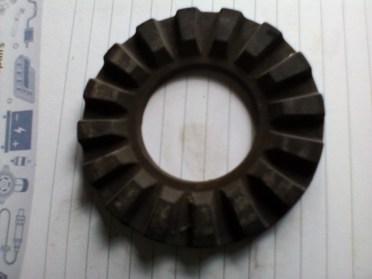

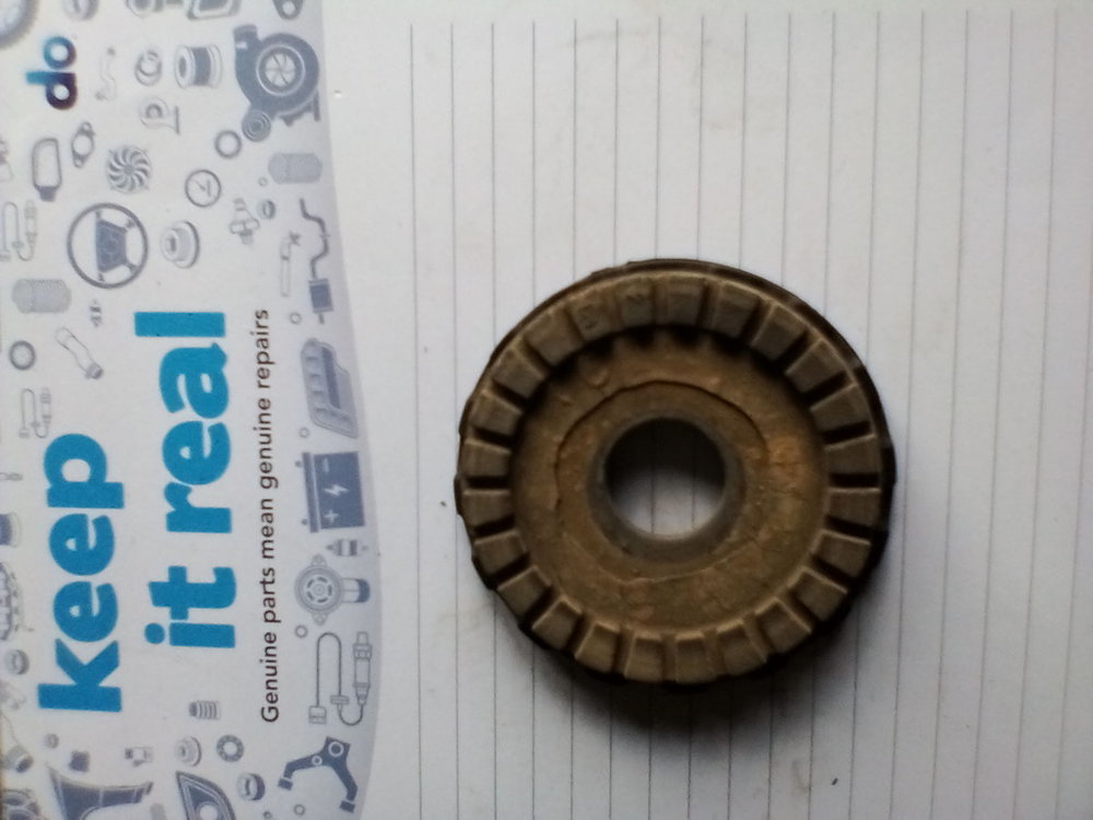

  8. These washers with bonded rubber insulators can look pretty ugly by now. I found an update repair option a few years back on 99 Impreza front suspension. Lower control arm, rear bushing location. Just the rubber, figuring we can glue to original washer. Probably about 4 mm larger diameter that gets swallowed up pretty easily. The first pic is actually original unit overlaid on the Impreza insulator, you might just imagine you can see this looks like a shadow They look to be a better quality or more robust rubber ring. Thought worth sharing with pictures here. If it went to Facebook it likely just be seen, forgotten, never to be found again
