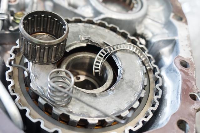

Hello, I have a 98 OBW 200+. Bad torque bind, AT light flashing. I opened the tail end of the transmission and things just dropped out. Does anyone have any idea what that broken metal band is to? Also the end of this gear looks sheered off. How bad is this?
