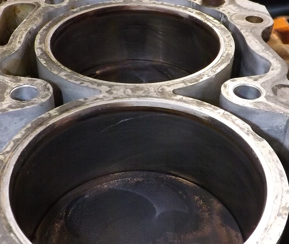

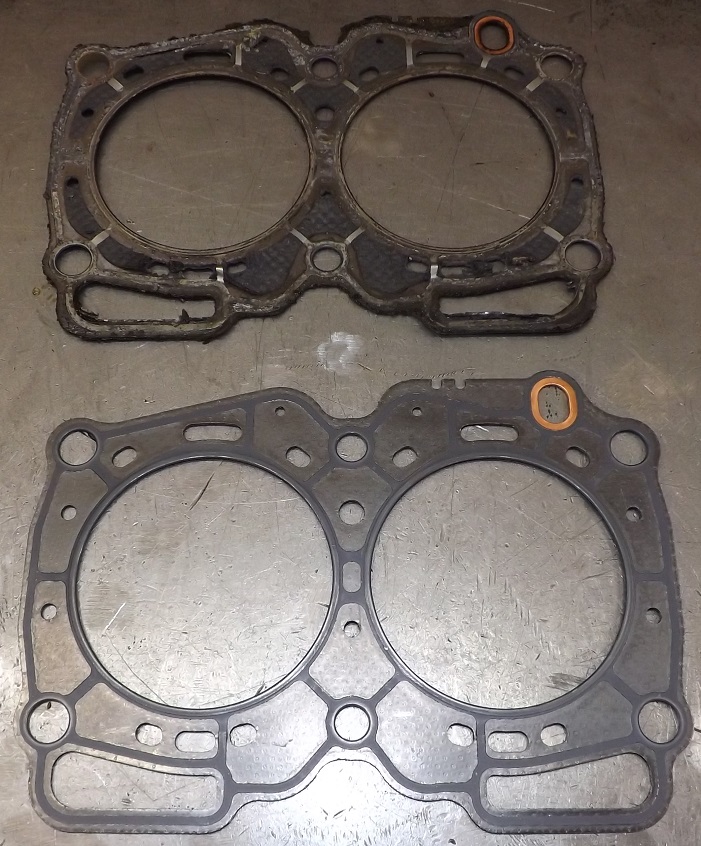

Replaced the head gaskets in the Impreza last weekend.  One thing I've been impressed with in every Subaru engine I've done head gaskets on is that you can still see the cross hatching in the bores and the ring gaps are tiny with a quarter million miles on them.
There were a lot of little dings on the quench area of the heads.  Those must have been caused by something the previous owner did.
Head gaskets definitely looked a lot different than the new ones but I'm used to the MLS gaskets so I don't really know what bad looks like with these.

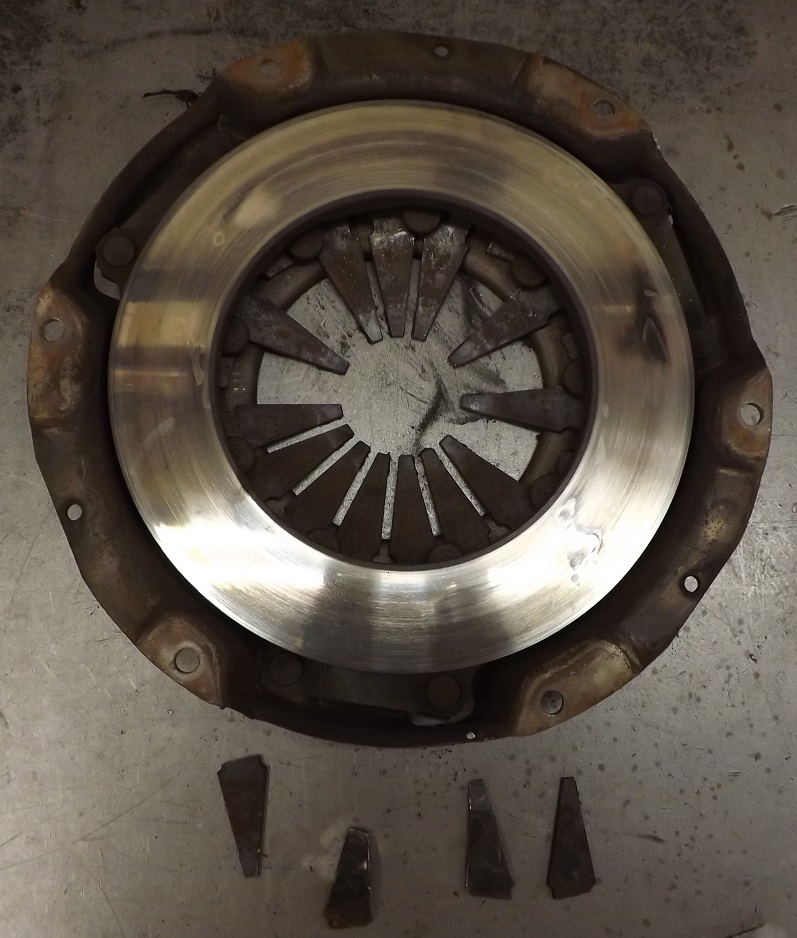

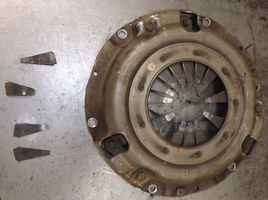

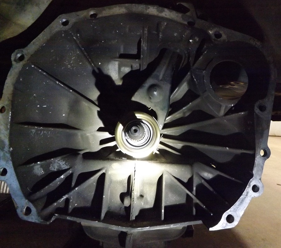

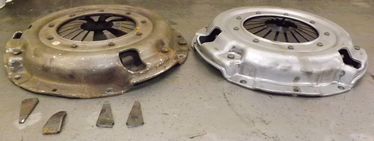

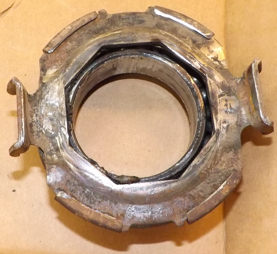

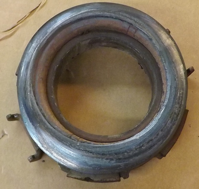

Knew the release bearing was bad, I could see sparks coming off it one time looking in the bellhousing when he hit the clutch.
Kinda figured this was the case too, some fingers missing so you can't really disengage the clutch anymore.  Ends of the fingers torched from the dead release bearing.  Not sure exactly why they broke though.  It's never been replaced while he's owned the car, maybe it's original?
Inside of the bellhousing is beat up from the shrapnel, there is one extra hole in it now.  Definitely not SFI approved.
