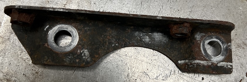

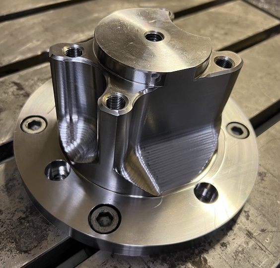

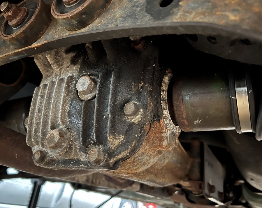

Finally took the diff stubs to heat treat.  Made some for R160 and some for R180 for using the female front CV axles in the rear.

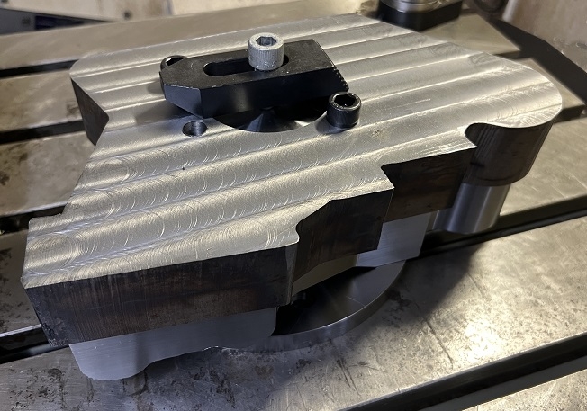

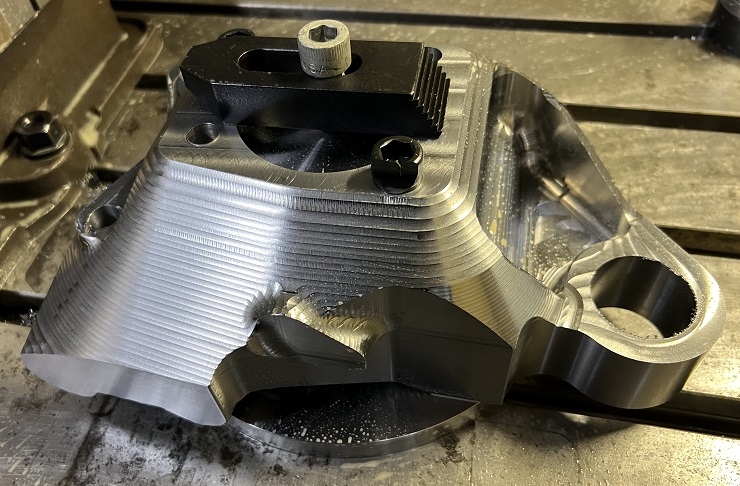

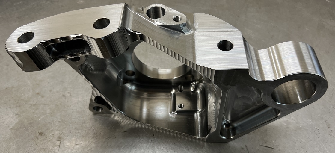

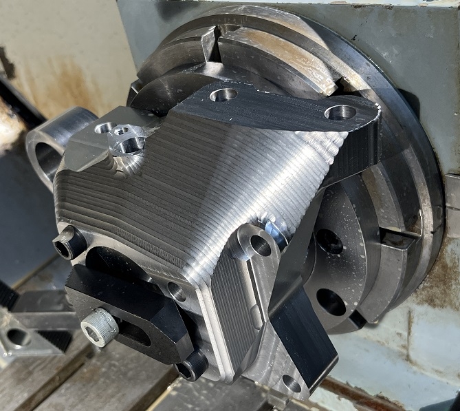

Figure you guys might want to see a little of how the sausage is made.  Billet knuckle fixture.
Ready for op4.
op4 finished

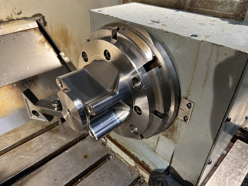

Made fixture to fit milling table and fourth axis.
Got it all set up on the fourth axis to do the side holes today but didn't quite get to making chips before I had to leave.

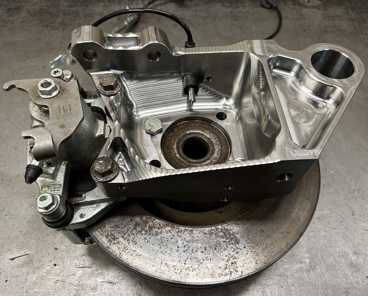

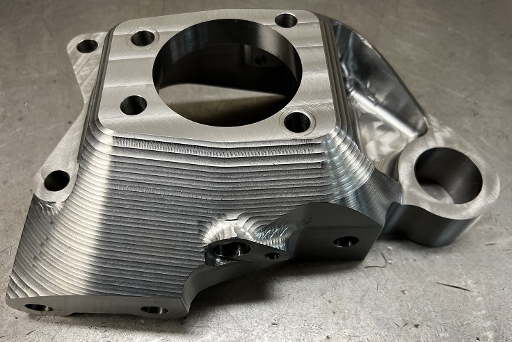

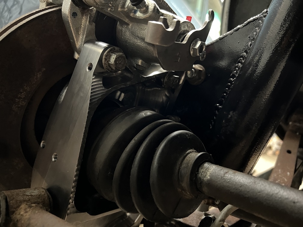

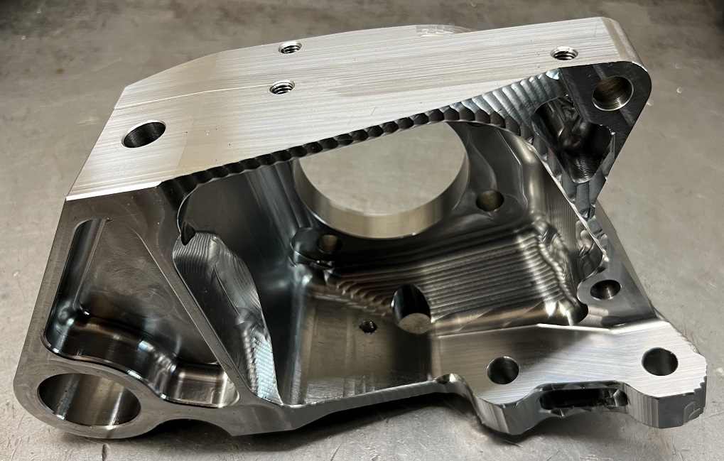

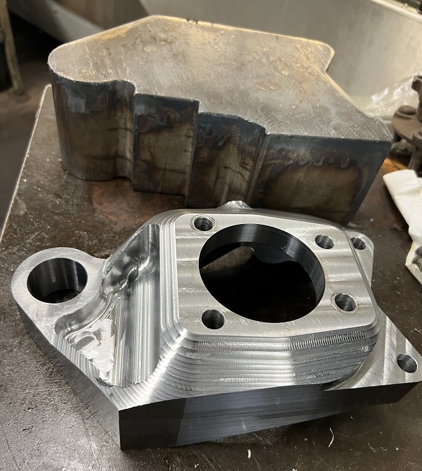

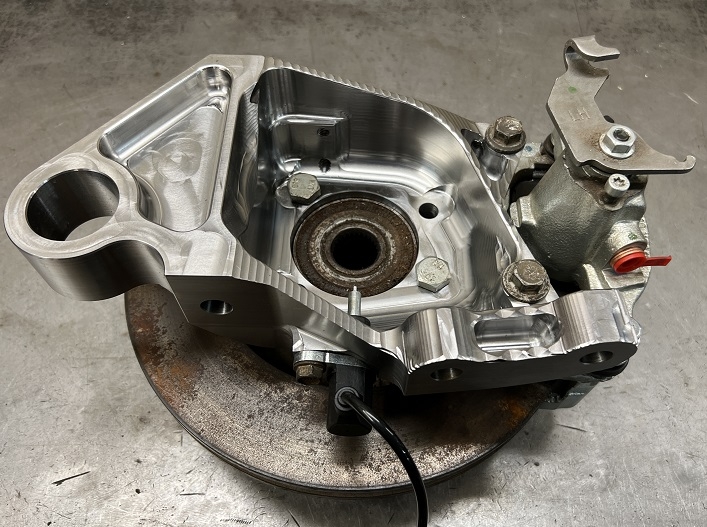

Finished machining the first billet knuckle.  No major problems, went as well as I could have hoped.
With caliper, wheel bearing, disc, and ABS sensor bolted on.
Edit: Just noticed I first started designing these almost two years ago now.  We 3D printed the first prototypes over 20 months ago.  Didn't realize they've been in the works that long.  Thanks again to slammo for helping with a cleaner more compact design.

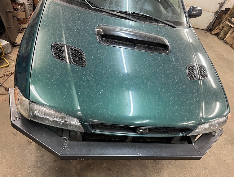

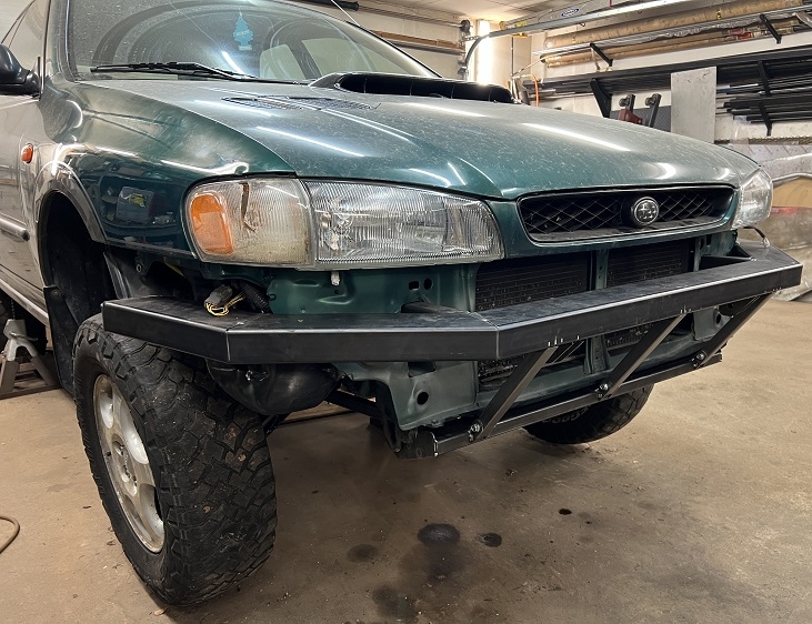

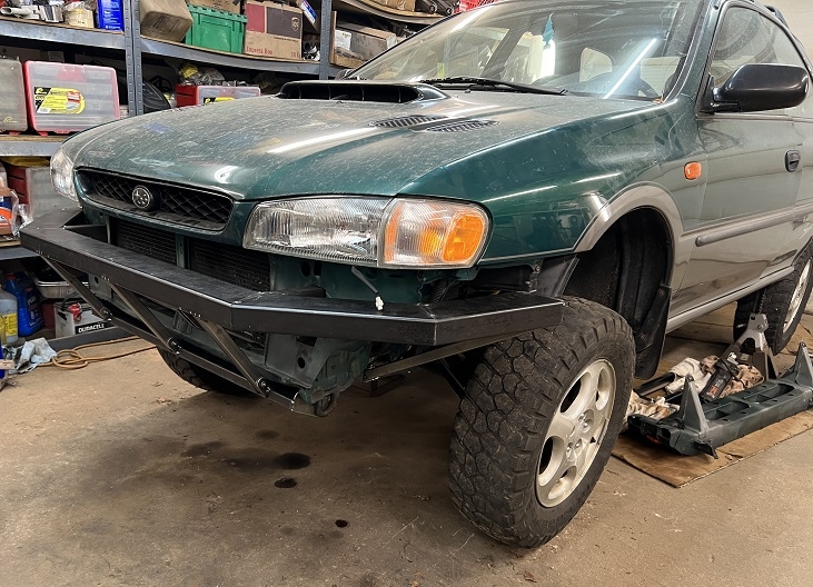

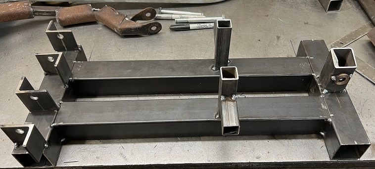

Some pictures of the bumper, most of the fitting is done now.  Ran out of 1" square tubing so we stopped here.  Got the tow bar mounts done, barely visible under the main beam.  Ran some tubes from the radiator support back to the swaybar mounts, barely visible.  Ordered some 1.25" receiver tubing but they sent 2".  Even says 1.25" on the shrink wrap but it's definitely not.  So we'll still have to add those, planning on having one in the center and one on each side like we did the white Outback.  Waiting until we get the EZ36 in to make the engine skid.

I understand why it is where it is, but that would look a lot better with the whole horizontal beam moved up so it only sits a quarter inch below the fenders, lights, and grille. Attach the beam to the top of the frame inserts, rather than the front?
Edited by slammo
It'd look better with the stock plastic bumper.
As you know I'm putting it that low to fit light bars and get more air to the radiator.

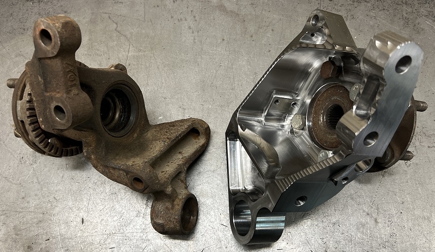

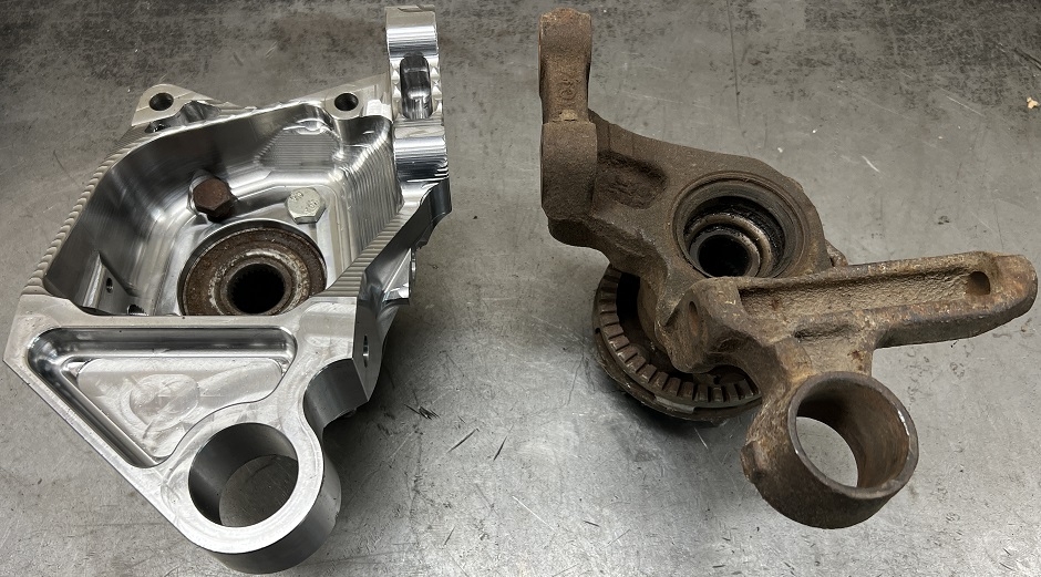

Billet knuckle vs stock knuckle
Stock knuckle with wheel bearing weighs 14#.
Billet knuckle with wheel bearing weighs 19#.
Bare billet knuckle weighs 13#.
We kinda knew this up front but after seeing them in person compared to the stock knuckles, aluminum would almost certainly be strong enough with this boxed design.  Would require steel sleeves for the strut bolts and long bolt but the machining would go a lot faster.
The brakes will probably be heavier than stock and CV axle will definitely be heavier but I think a ~10# unsprung weight increase per rear corner will be worth it.
Edited by pontoontodd

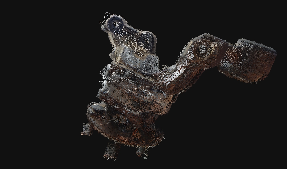

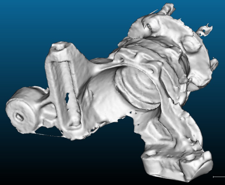

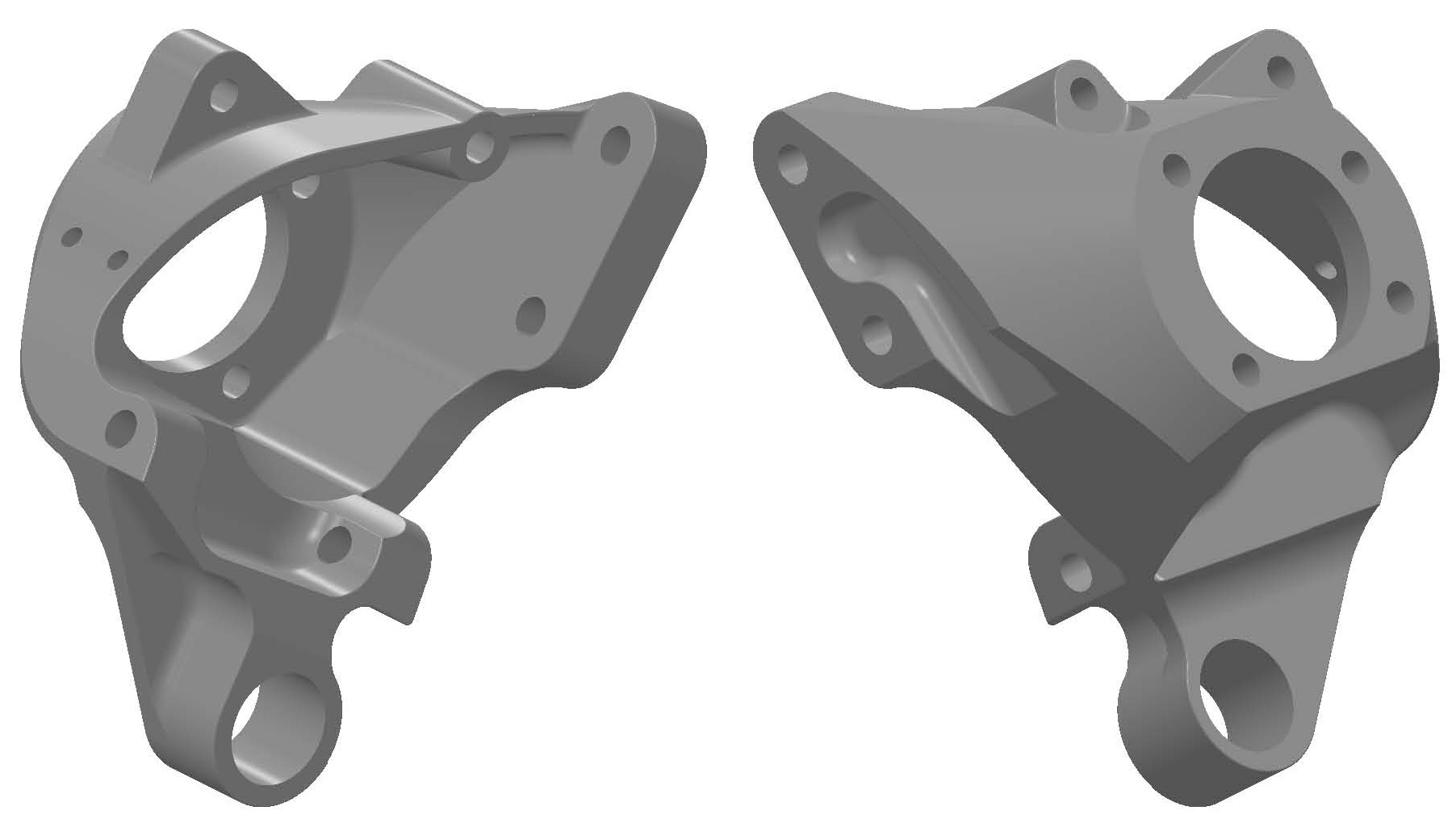

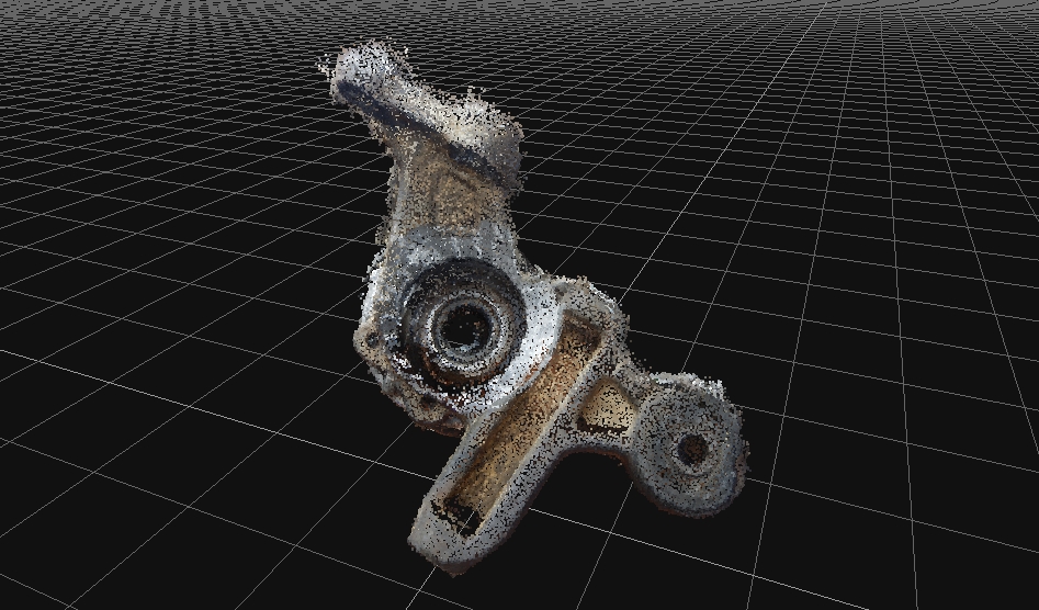

On 12/31/2020 at 10:36 AM, pontoontodd said:

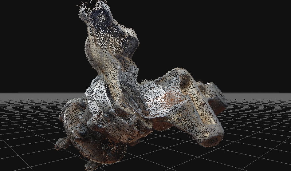

Used photogrammetry to get the mockup rear knuckle on a computer.
http://www.franavehicles.com/subaru/dpc1.jpg
http://www.franavehicles.com/subaru/dpc4.jpg
http://www.franavehicles.com/subaru/dpc5.jpg
I didn't do a good enough job to get a really clean model out of it but it gave me a decent starting point.
http://www.franavehicles.com/subaru/ccobj.jpg
Measured all the hole locations later to make them accurate.  Designed this in CAD to make it as boxed in / gusseted as possible but not super heavy.
http://www.franavehicles.com/subaru/7208I.jpg
Stock rear knuckle bare is nine pounds, this one should be about 14 pounds.  I think it will be a lot stronger.  The main point though is to get bolt on wheel bearings (same as front).  Also with some diff stub adapters we can use the big female front CV axles which are stronger and we won't have to carry as many spares.  It's also designed to use the same front rotors we normally use and a caliper with a lever for parking brake.  Z is going to 3D print a couple so we can test fit them before making them out of steel.
Billet knuckle looks great. It's come a long way!
YES! Heck of an upgrade!
K
Sweet work on that billet hub! Ditch the bearing to help reduce unsprung weight! :horse:
Seriously, you could make a set of aluminium billet hubs and carry the steel billet hubs as back up if one cracks out bush. Best R&D there is.

That would improve our sprung/unsprung weight ratio!  Think I'll just stick with steel and not worry about it.  Considering a wheel and tire assembly weighs 50#, 5-10# here or there isn't going to make a huge difference.

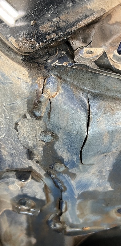

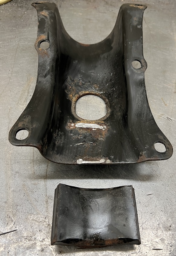

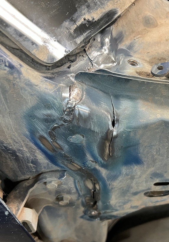

B did some work on the blue Forester.  It's been getting water on the passenger floorboards for a while now after (but not immediately during) rain or a trip to the car wash.  He cleaned out a couple drains near the blower motor, couldn't find anything obvious.  It seems to be leaking behind the rubber/foam on the firewall so it's hard to tell exactly where it's coming from.  Probably not the source of the leak but he also noticed the area in front of the passenger door hinges was mostly cracked.
He cleaned off the paint around the cracks.
I didn't get any pictures since I was working on my rear suspension but he got it all welded up and painted and put the fender back on.
He also replaced the tie rod and wheel bearing on that corner, they were both a little sloppy.

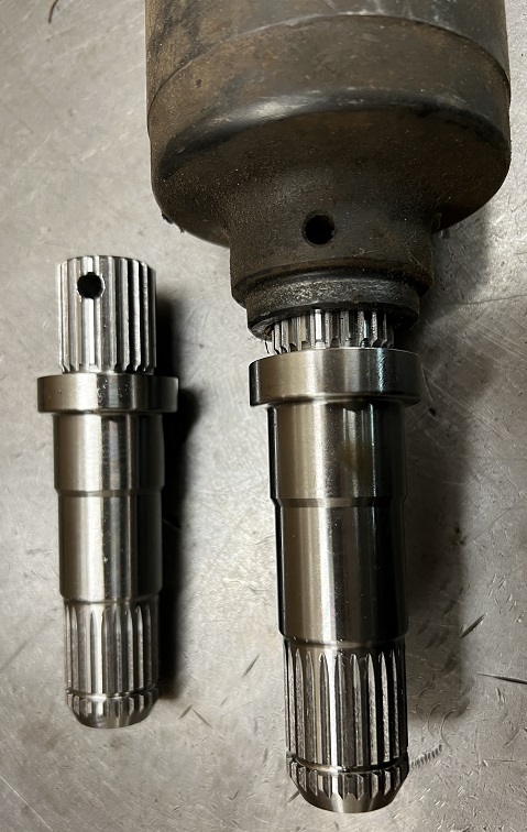

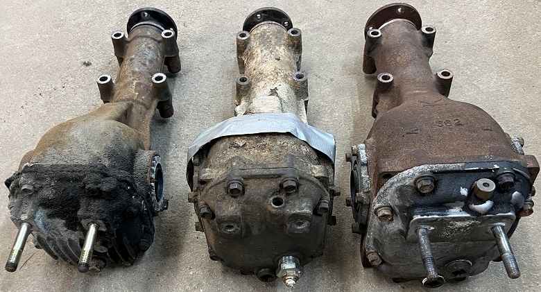

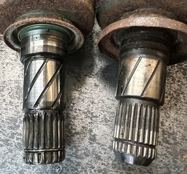

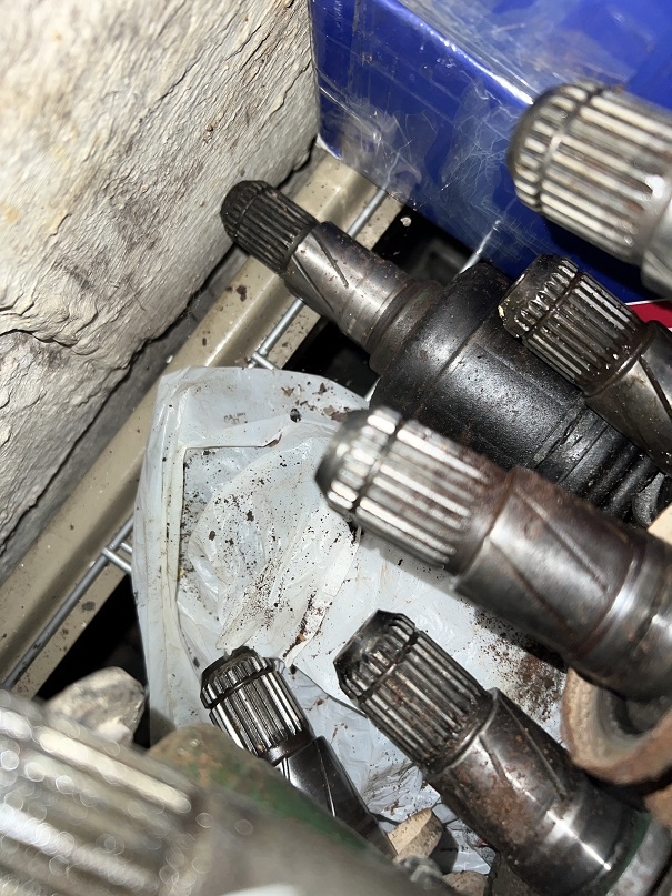

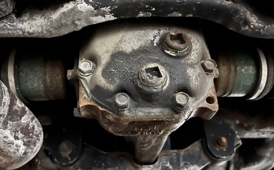

First issue I ran into trying to mock up the front CV axles in the rear for the billet knuckle was that the rear axles in this thing seem different than any other EJ Subaru rear axles I've run into.  This is the rear diff in the green Impreza:
All of our other R160s look like this, including the one in my red Impreza which is a year older:large.IMG_7052s.jpg.8c06aa04ce26c11c075841351cd7b5c2.jpg
Green Impreza axle on left, "normal" EJ rear axle on right.  I think the splines are the same, obviously the snapring groove is totally different, also the spiral cut bearing diameter from the green Impreza is smaller.
Just made sure I wasn't going crazy and took a look at some of my rear axle collection, they're all like the one on the right in the picture above.
Long story short I turned up a dummy stub for mockup instead of using one of the ones we'd made.  Ultimately it doesn't matter since I'm not going to use this diff but surprised me a little.  Need to swap the R180 in (finally got one) and put those stubs in to see how that works out.

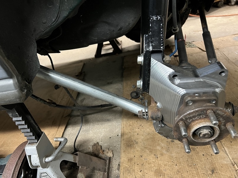

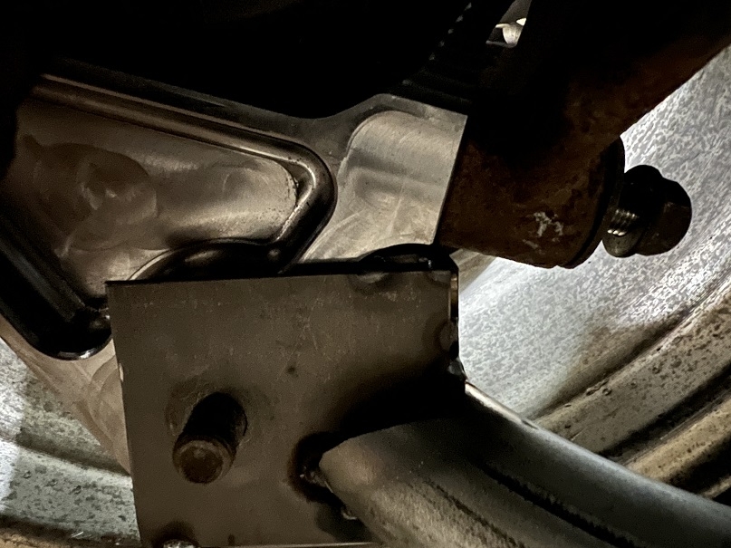

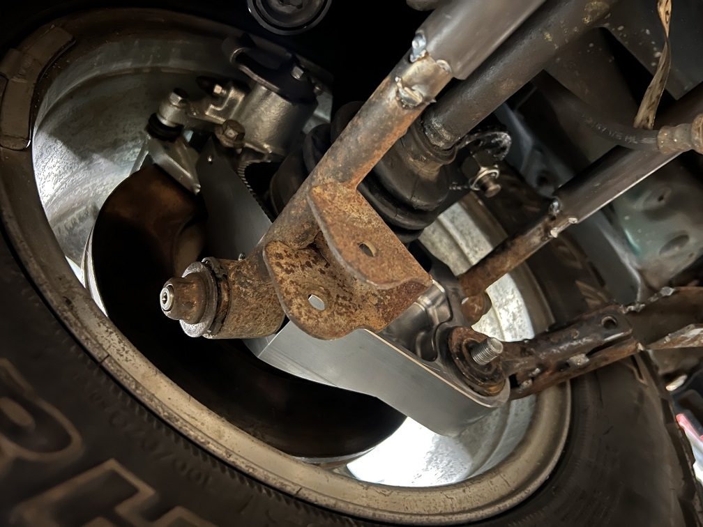

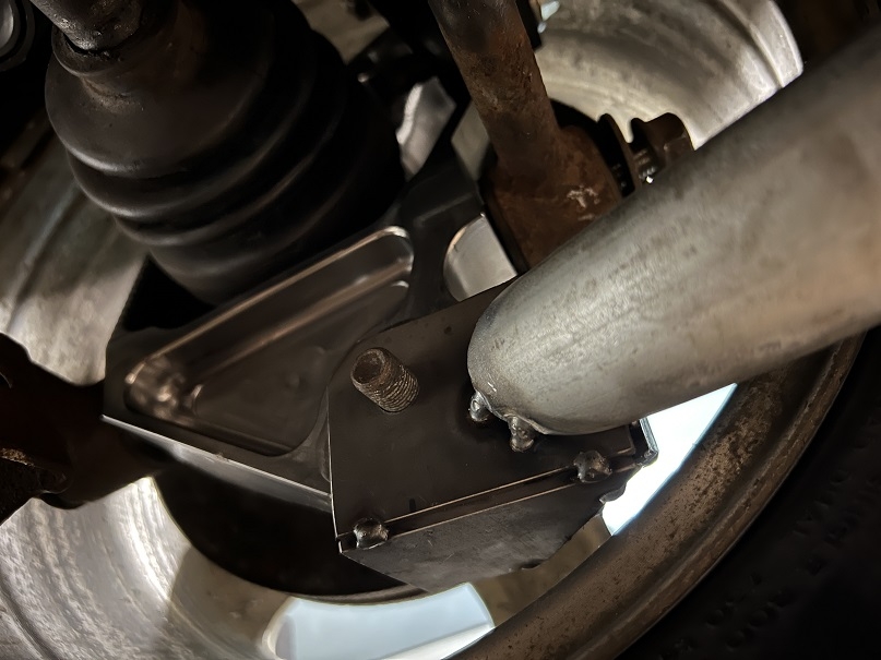

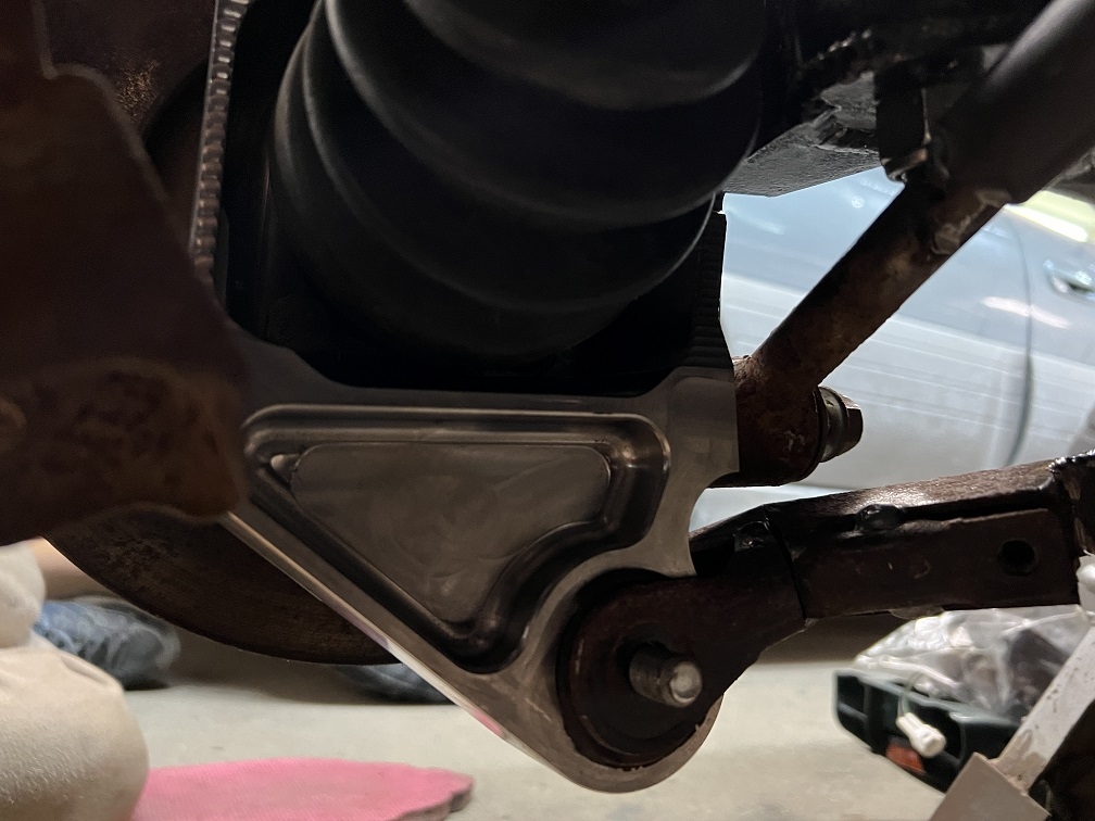

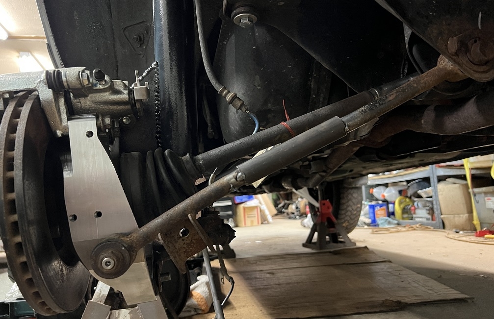

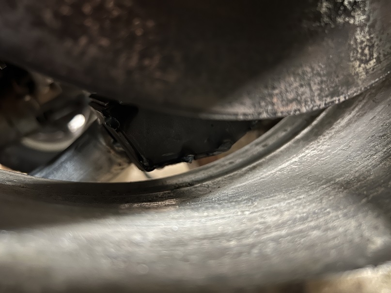

Mocked up some new links with the billet knuckle.  Surprisingly it doesn't seem like the trailing arm should be much longer, just needs a big dog leg at the rear end to clear the wheel.  Need to mock that up better with some round tube bends.  This is with the Impreza trailing arm bracket and no spacer.  Lateral links need to be a little over an inch longer as expected.  Surprisingly the tire doesn't rub the wheel well much worse than it did before.  Camber is zero at ride height in the middle of the adjustment as best I can tell.
Caliper bolt and strut nut are close to each other but can be removed and installed independently.
Hard to tell in this picture but decent clearance even with the "big" front axle installed.  Boot needs a strap but there's plenty of room for it.

Wonder if the R160 difference correlates to the one-bolt versus five-bolt design?
(photos from Torq Locker's website)
Knuckle mockup looks great, super excited for that! Hopefully the trailing arm dog leg doesn't cause any issues, that's not a lot of clearance to the wheel lol.
From what little I can find the one bolt design is also known as VA type and was used in early Imprezas.  The five bolt design is also known as T type and supposedly uses bigger internals.  The rear diff in my red Impreza does have a date of Dec 2021 on it in paint marker, presumably from a junkyard.  So someone probably put a later diff and axles in it fairly recently.

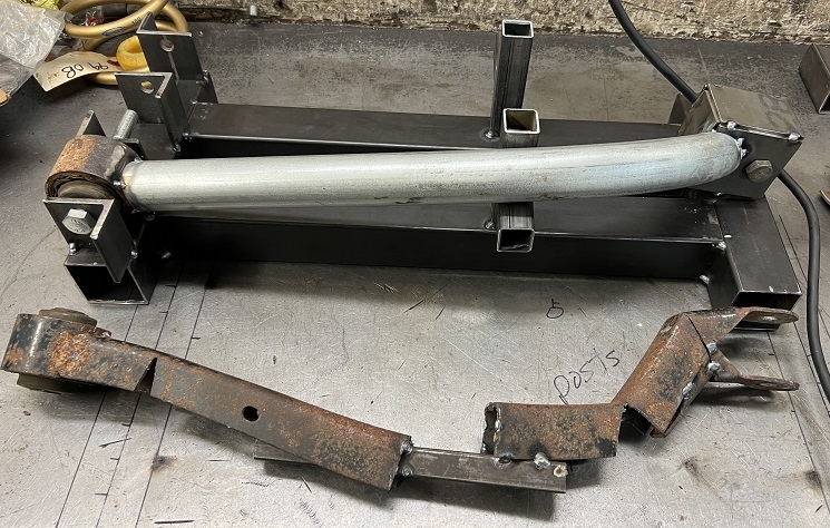

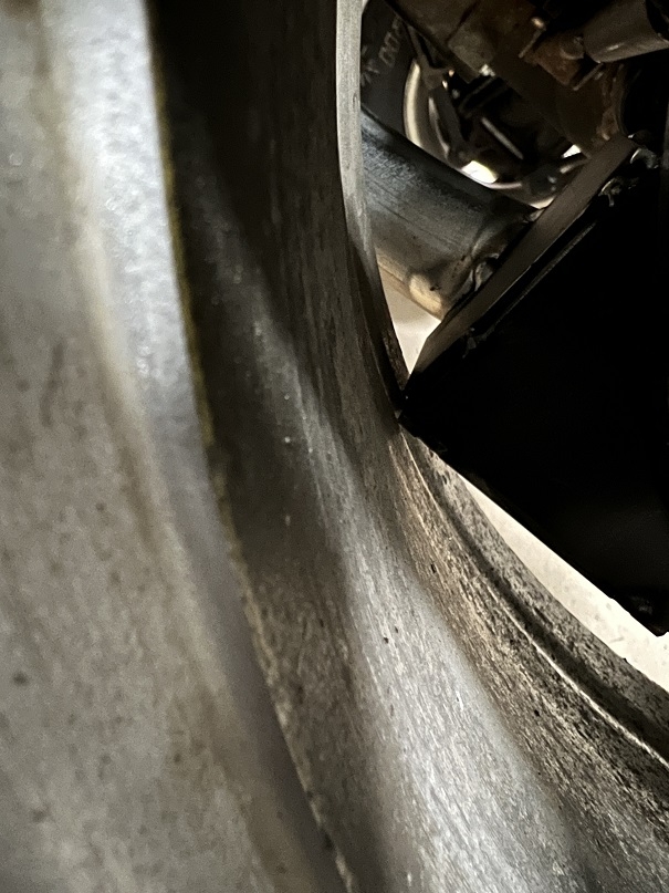

That semi posterior trailing arm mockup does hit the wheel at full bump.  First step was just figuring out how long we want it and how much dogleg (in each direction).  Next step will be a closer to production mockup using some conduit bends.

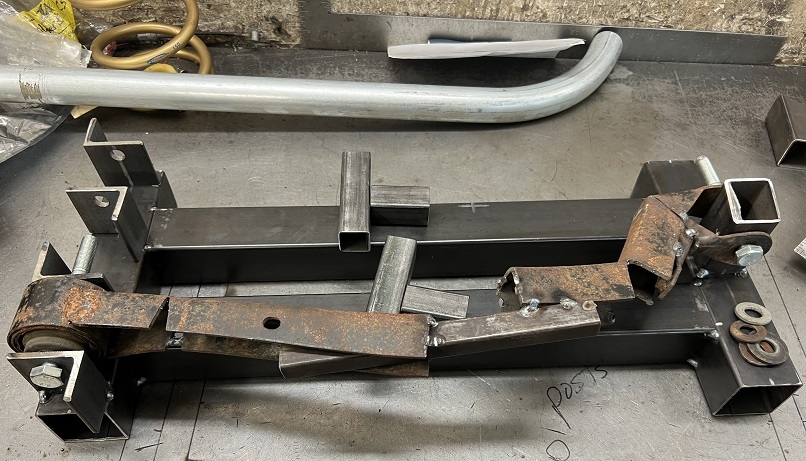

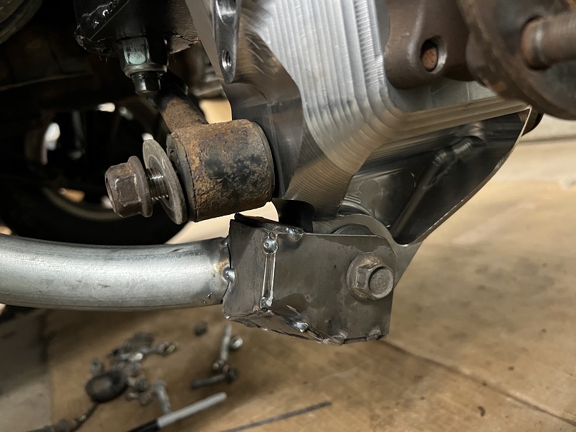

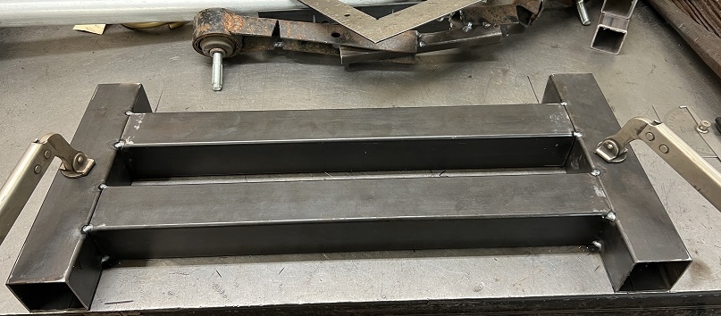

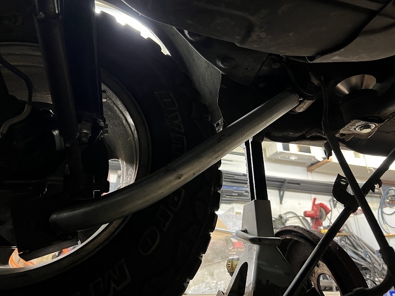

Made a jig and more sano mockup trailing arm.
Just used a piece of conduit we'd bent with B's tubing bender.  For the actual trailing arms I plan to use 1.5 x .120" 4130 and also turn the sleeve for the front bushing on the lathe.
Incredibly bad picture of it installed.
Initially hit the knuckle and lateral link at full droop.
Hit the wheel near full bump.
Modified the box clevis on the rear end for clearance.
So we've got a good plan on those now.

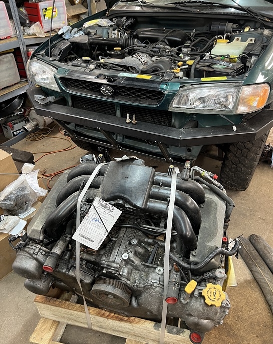

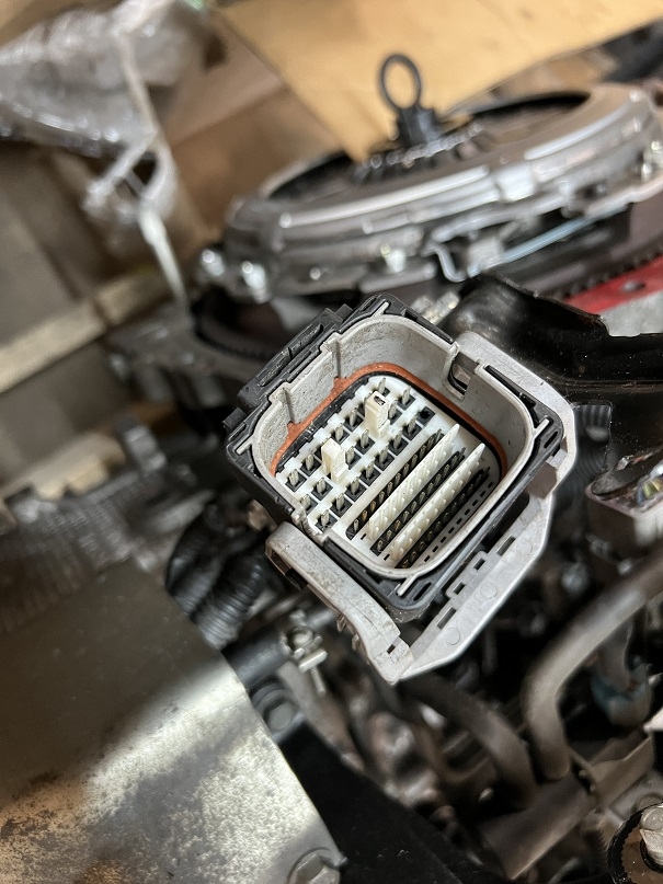

Picked up an EZ36 last week.
Kinda wished I'd tried harder to find one that's more complete though.  Junkyards of course normally sell them without accessories, so I bought those separate.  But that means I don't have the brackets for them.  Had a bracket that worked for the PS pump but the AC compressor is much different.  EZ36 on left, EZ30D on right.
Need to find a plug and pins to fit this.

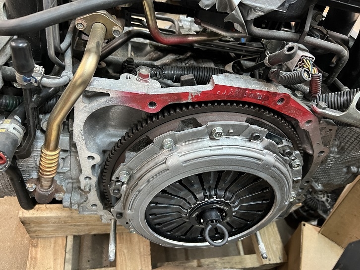

I got a resurfaced STI flywheel and Exedy clutch kit and B assembled all that and chased the threads in the block.  You can see here where the junkyard cut the wires and coolant hose to the throttle body (I assume).  They probably did this when they removed the throttle body, didn't even think about them stealing that, now I need to get one of those.  Have heard of people using non Subaru.  Plan on drive by wire but open to suggestion if there's something better than Subaru since I have to buy one either way.
Got a trans mount, still need to install low range in the 6MT.  Got a driveshaft and R180.  Have engine mounts on order.  Got some shiny headers from Australia, last set they had, hopefully we can make them work.

On the EZ, weird they’d sell it as a complete engine without the throttle body! There’s a massive array of drive by wire throttle bodies available out there these days. I’d probably pick one that you know will be on the market for a long time that’s easily available.
As for the plugs, got a self serve parts yard over your way to grab your own? Other option is to re-plug the engine loom to match an aftermarket ECU setup if you go down that path.

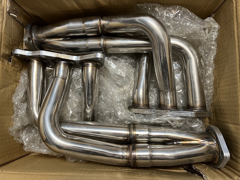

Love it! I can't believe you bought headers; car is going to sound good, too. How about doing those head gaskets now while it's out of the car instead of later when it's in the car?

That salt picture is definitely a worst case scenario but yeah it's bad.
I'm not too surprised they pulled the throttle body off, if you're replacing a blown up engine the one on it could probably be swapped over.  More pissed that they cut the wiring rather than unplugging that one connector.  I'd like to have as few splices as possible.
Know of any throttle bodies in particular that fit and are better in some way?
I can get the main car side harness plug here, they just listed it:
https://www.corsa-technic.com/item.php?item_id=1783
Headers weren't super expensive.  Supposedly +20ft-lbs through most of the RPM range.  Engine as expected didn't come with enough exhaust to work with so I was going to have to buy/make something either way.
I'm going to hope for the best again on the head gaskets.  Yes 90% of the EZ30s we've bought have needed them but those engines are twice as old as this one.  Also it's quite a job.

Couldn't find a good pic of a 3rd gen Impreza engine bay, so here's a bad pic instead:
It may be worth welding in some sheet metal as a brace there so you add support to both sides of the strut towers. Would be worth doing while the engine is out; just have to avoid the fuel and brake lines that run through there.
Edited by slammo
word salad
Lower 'frame' on the second gen pic is gusseted at the firewall; that certainly looks stronger. Good point.
K
Edited by travelvw
On 1/7/2023 at 9:46 AM, slammo said:
2nd gen Impreza:
OK, I didn't see those lower "gussets" at first but I like the idea.  Should be plenty of room there since I'm not running a turbo.  I really want to minimize the welding on this body as I think that's going to make it rust faster but will definitely take a look at mine and see what we can do.  Also reminds me it might be a good idea to do a strut tower brace that attaches to the pitch stop mount.  But maybe that's why the wiper arm on my black Outback keeps scraping the windshield when we beat on it?

Biggest thing we accomplished was swapping in the R180.  Left to right, "one bolt" (earlier) R160, "five bolt" (later) R160, R180.  Some studs and plugs swapped over.
Definitely one good reason Subaru has a Lego reputation.  After swapping over those studs the R180 bolts right in.
Weights are 37# (1 bolt R160), 47# (5 bolt R160), 57# R180.  5 bolt R160 is definitely a 4.11 open diff, I assume the 1 bolt is open also but probably 3.7 or 3.9.  I was shocked how much weight difference there was between the R160s.
Had to trim one of the little diff mount brackets so it would sit flush on the R180.
While we had this out I cut the tuned mass damper (?) off.
Surprisingly only weighs 1#, seems heavier.  Thinking by adding 20# of rear diff we've ruined whatever NVH tuning that was supposed to accomplish.
STI driveshaft appears it will just bolt in.  Looks to be a little on the short side, anyone know if the splined part towards the rear is supposed to telescope?  There's definitely splines under the rubber cover but we couldn't get it to budge.
Looks like we need to make the rear lateral links a little longer than what we'd mocked up for the R160 but I think then they'd work with either diff.  Still need to machine the RR billet knuckle, started programming that the other day.
With the above, are you saying the one bolt came before the five bolt R160? Or is there and early and later version of the two diffs (that I don’t know about)?
Asking as the five bolt came before the one bolt. I know the 1980 brumby/BRAT models run with the five bolt diff and you could bolt one any five bolt r160 into the back of them.
The one bolt I believe appeared mid to late naughties, but I think the five bolt is still to be found in those years as well depending on which vehicle model you look at - I could be wrong though!
Cheers
Bennie
