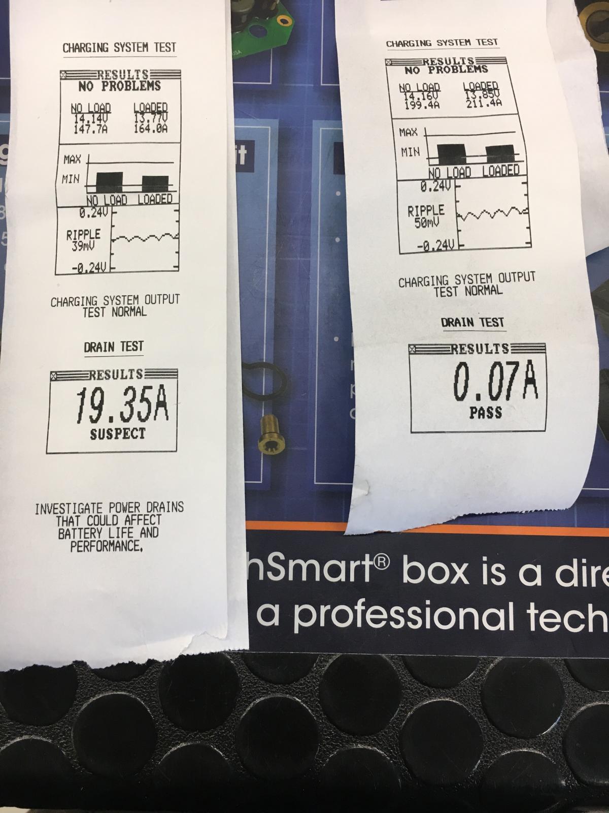

Figured out the problem when I went to Advance Auto Parts to have them check the starting and charging system. Turns out the old battery was starting to go and even with the car off it had nearly a 20A drain. A new battery installed and tested showed far less than 1A drain. I even made sure to run the new battery for a while and then repeat the charging test under identical conditions.
So for $71 I have a nice new battery and it works just fine. In the meantime I did clean up a ton of engine grounds and made other connections nice and tight.

You say that the old battery had a "20A drain"; and the new battery has "less than 1A drain".
How was this 'drain' measured?
I ask, because if the 'drain' was a leakage current via the wiring harness and through the car, then that points to a problem on the car itself, and not necessarily a bad battery.
The difference before and after might be because of the intermittent nature of your original starting problem.
A large leakage drain, such as the 20A you mention, could be the alternator diodes failing, for instance.
If however, the 'drain' is a leakage internal to the battery, then I don't know how this is measured. Other than to disconnect the battery, and to monitor the battery voltage across the terminals.
Did the store say how they measured the 'drain' on the battery?
They measured it by using their device which examines the electrical system (starter, alternator, battery, etc). I didn't get a look at the device manufacturer, but it connects to + and - on the battery and also has a probe going over the + wire. They had me variously start the ignition, turn on and off the headlights, put a load on the engine, and turn off. It then gave me the print out which I linked above.

There is a bunch of information in those printouts, but not know what they are really measuring makes it hard to know what it can mean.
