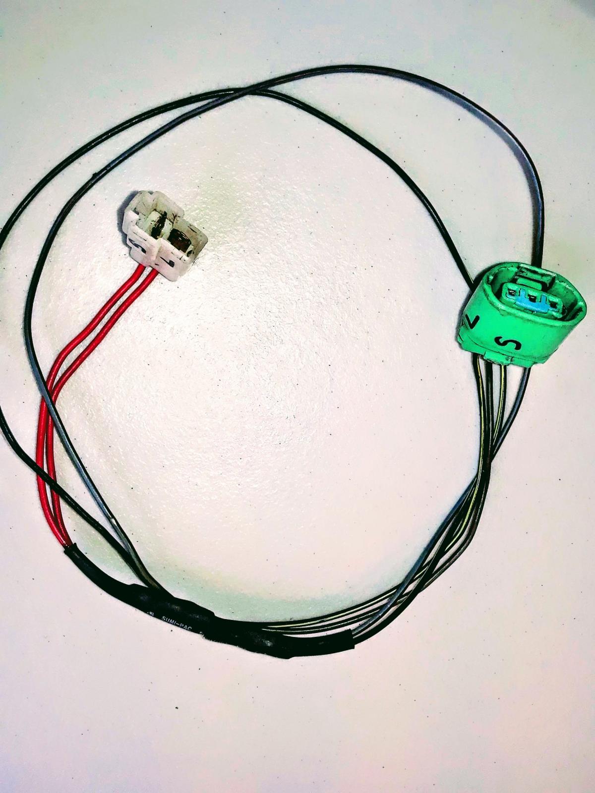

So last week my stock alternator died.
I replaced it with my GM 1 wire alternator 60 amp , which i keep for just this type of circumstance. :P
Since the tension bolt does not match up.
I installed it with my Redneck wood shims method of tightness.
Then on Monday i was able to get an JY alternator from a 2002 EJ25, $17.50  :)
Below are the wiring diagrams I used.
Now with everything on still have 14.1 at battery.
post-50214-0-26436400-1519178501_thumb.jpg post-50214-0-92516900-1519179320_thumb.jpg post-50214-0-39459000-1519179430_thumb.jpg post-50214-0-65482100-1519179464_thumb.jpg
Good upgrade. One piece of advice: Get rid of the scotch locks and attach the wires correctly. Solder them and use heat shrink tubing or use shrink type but connectors. Scotch locks are hinky at best, ruin wires, provide a poor connection for loaded circuits and let in moisture which leads to corrosion and electrical Gremlins. This is not meant to offend, but inform. If you want a little more info, I did a lengthy write up on electrical here: http://www.ultimatesubaru.org/forum/topic/159953-wiring-dos-and-donts-a-guide/

the EJ alternators are mostly 90 amp, and a direct bolt in. just have to swap pulleys, and connect the electrical.
and yes i will make those connection heat shrink.
