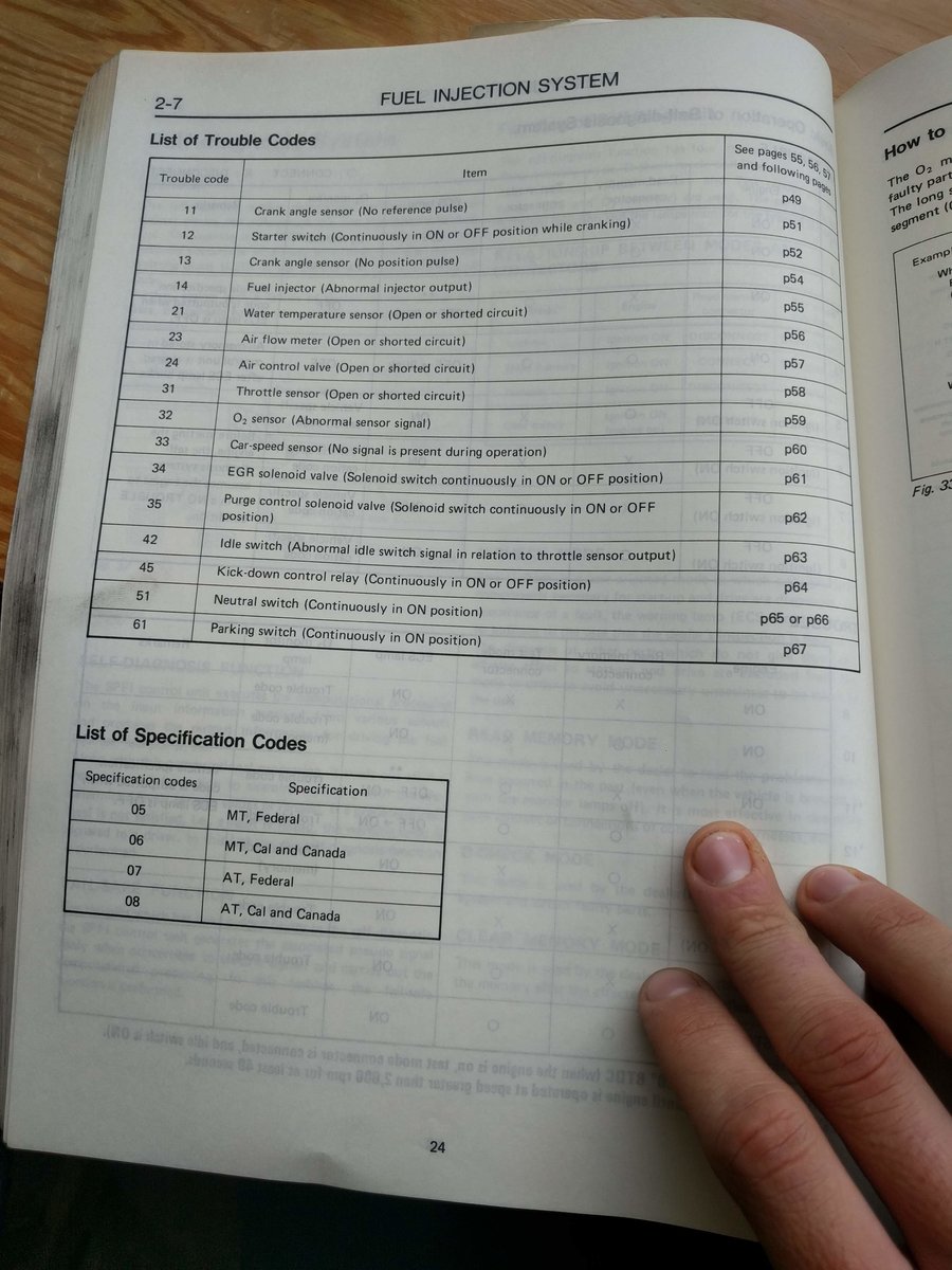

June 25, 20187 yr 9 hours ago, Speedwagon said: It is just flashing 6 fast with the key in the on position. Yeah I think 6 is just saying it's a Canada or California 5MT. a spec code, not a trouble code. From Le book: Edited June 25, 20187 yr by Brianmitchtay
June 25, 20187 yr Author 6 hours ago, Dee2 said: Is the distributor rotor turning when you crank ? Yes, it turns
June 25, 20187 yr Author 3 hours ago, Brianmitchtay said: Yeah I think 6 is just saying it's a Canada or California 5MT. a spec code, not a trouble code. From Le book: Is that a factory manual? Does it have a procedure for testing the crank sensor?
June 25, 20187 yr 17 hours ago, Speedwagon said: Is that a factory manual? Does it have a procedure for testing the crank sensor? Yes it certainly is, let me pull it back out and see if it does.

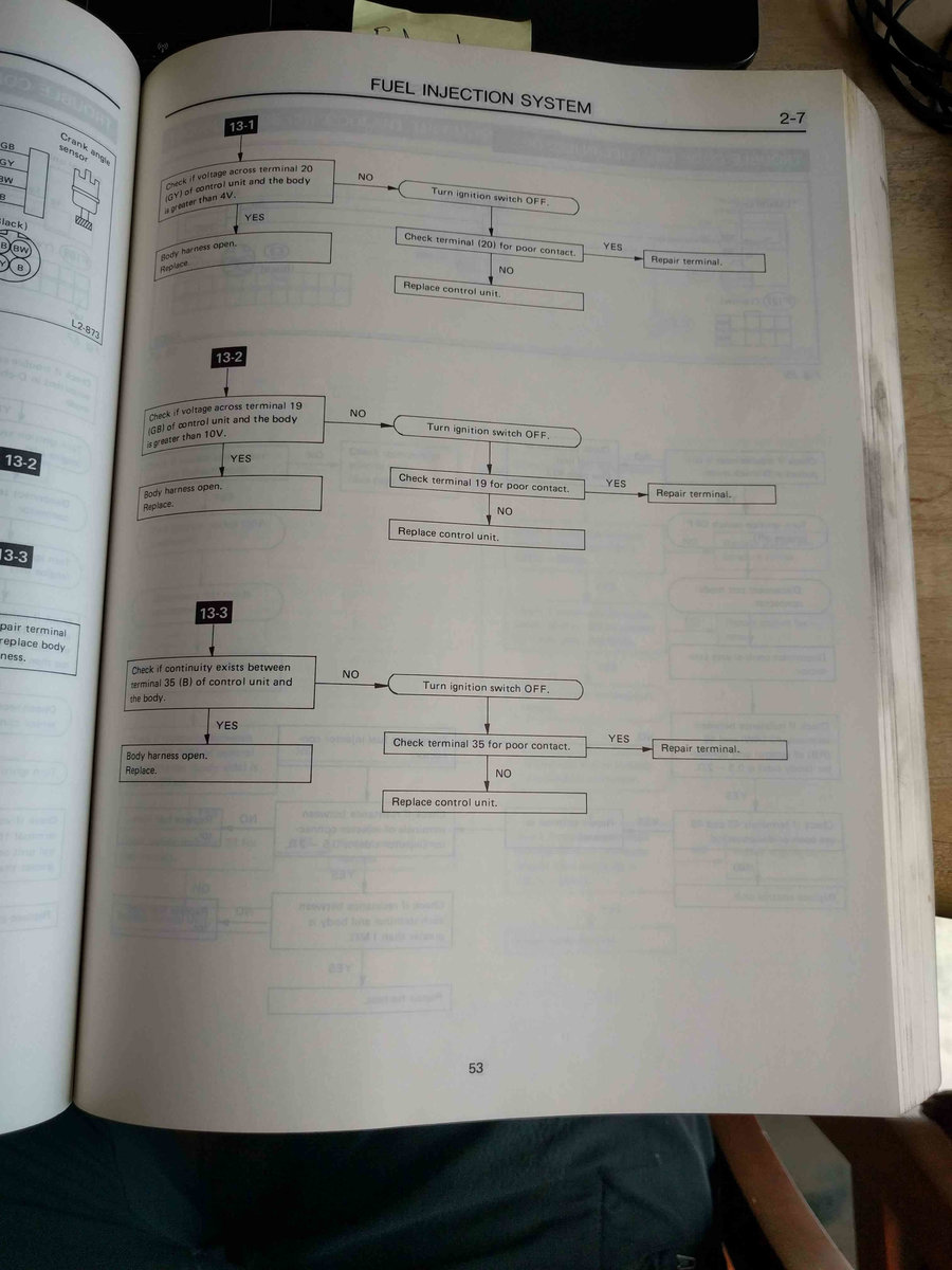

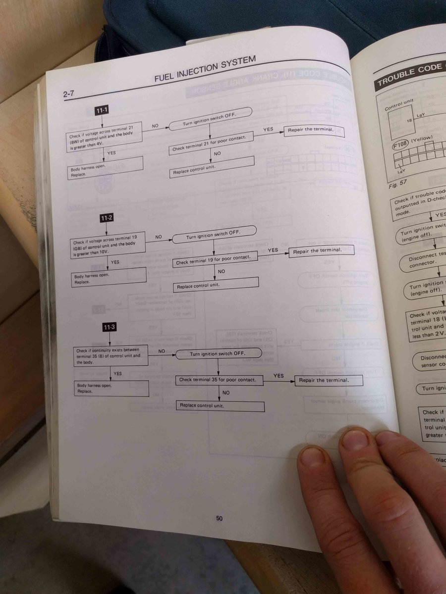

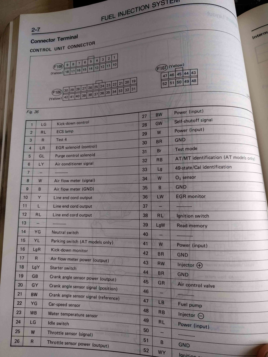

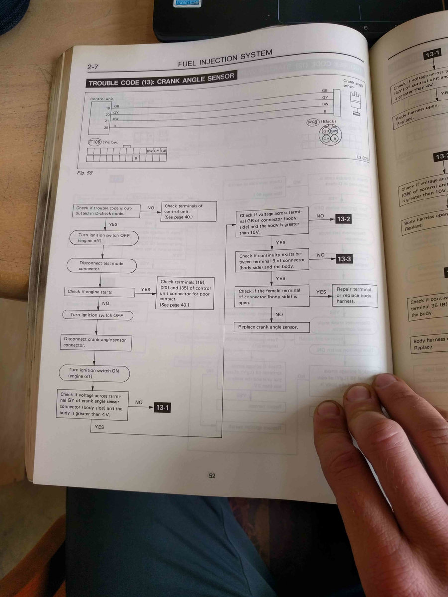

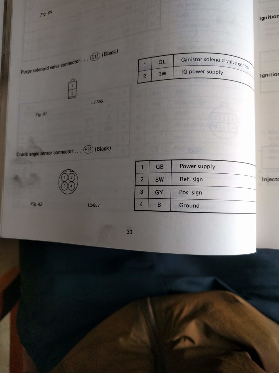

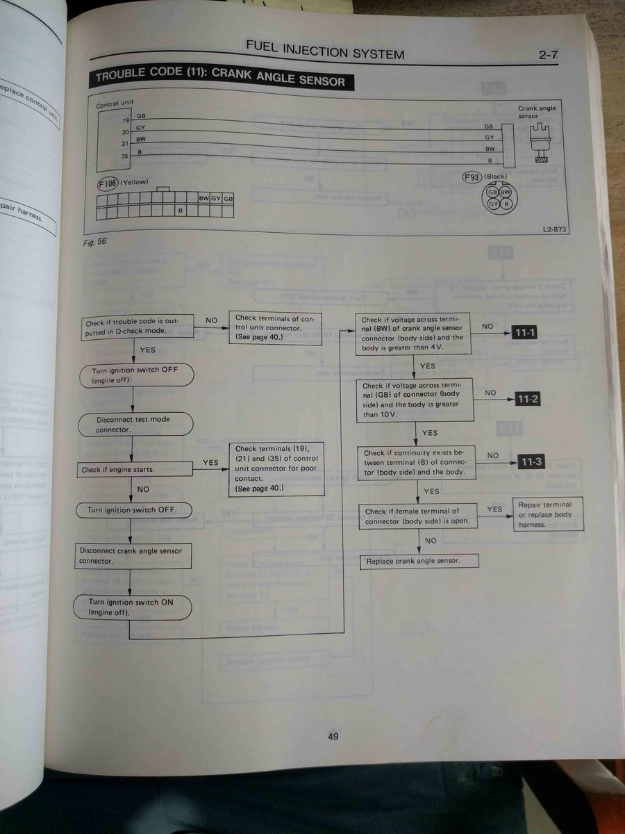

June 25, 20187 yr Ok so far as I can tell, in the SPFI section of the fuel injection chapter there's some info on troubleshooting the two possible trouble codes, 11 (no reference pulse) and 13 (no position pulse). also a wiring diagram of the sensor. I'll post those as well as the diagram of the layout of the control unit connectors. That should probably be what you'd need to check all the wiring. It says there's a more thorough write up of the distributor and ignition coil setup (including crank angle sensor) in another volume - Chapter 6-1 Engine electrical system. If you'd like I can pull that one out and see what it says. I'll be at the library all day today so just say the word if you see this post in time. Edited June 25, 20187 yr by Brianmitchtay
June 25, 20187 yr Hopefully this helps! and good luck! All the wires around my SPFI control box are so stiff and old that when I move them around to check continuity and resistances I always feel like I'm probably breaking more wires and causing more harm than good. ha

January 18, 20206 yr Author It's only been a year and a half, but I finally fixed this! Thanks to Brainmitchtay for those pictures! That helped me isolate it, and replace the disty fron a JY one. With that, it fired right up! After I got the new car about the same time this happened, my motivation to fix it just wasn't there. Edited January 18, 20206 yr by Speedwagon
April 7, 20214 yr Hell yeah man! I'm stoked you got it figured out and happy that my pictures helped - even if it took a while.
