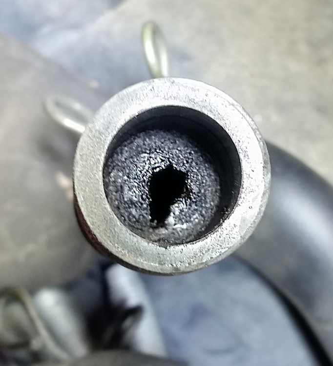

Sidenote, as we tear into the car to get the engine out I noticed this when I pulled the PCV assembly.  Not quite 100% blocked in any of the PCV hoses, but getting darn close!
My first impression is that there's not much I can do to avoid this besides running a synthetic oil, but what do the experts think of this?  @Gloyale@idosubaru @GeneralDisorder
Edited by carfreak85
That is the poster child for synthetic oil, and regularly replacing the PCV valve and cleaning or replacing the PCV to block hoses/fittings. Don't neglect to remove the separator plate on the back of the engine and clean that also.
With new rings, and synthetic oil, this will basically become a non issue going forward.
