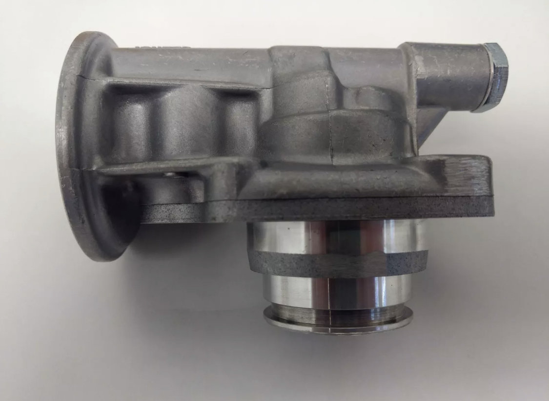

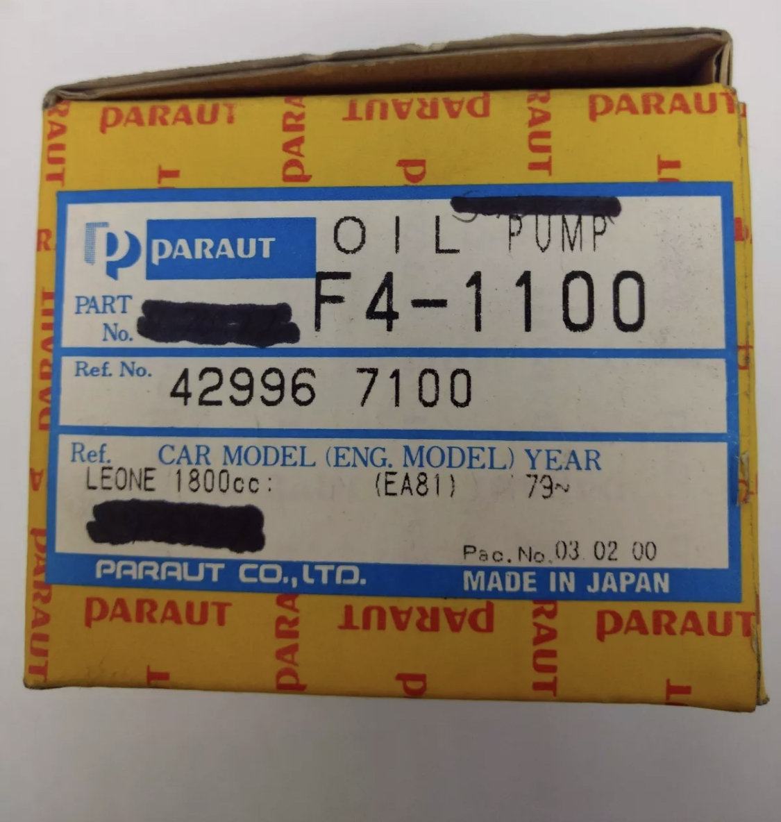

Thank you for the reply. The oil pump I found is for a 1.6 and 1.8 OHV. I will buy it in hopes that it is compatible with my 84 EA81 brat. Here are some pics. Any thoughts
Sorry to be a pain but time is running out. Can someone please chime in to confirm this will fit my 84 EA81?
Thank you in advance!
It looks a bit odd, but I never had an EA81.  It doesn't look like earlier or later ones though.  The 2 steps look funny to me.  The earlier pumps and the ea82 pumps have one round part past the flange, and a short shaft sticking out.
I just purchased the pump. I’ll have to wait and see if it matches up to the pump I have on the car now. If it is the wrong one how will I know? Will it fit and bolt on the engine block either way?
Excellent news! I needed to make a quick decision buying it and took a gamble. I know they are hard to find. Glad I took a leap of faith! Thank you to everyone here, couldn’t do it without you!
