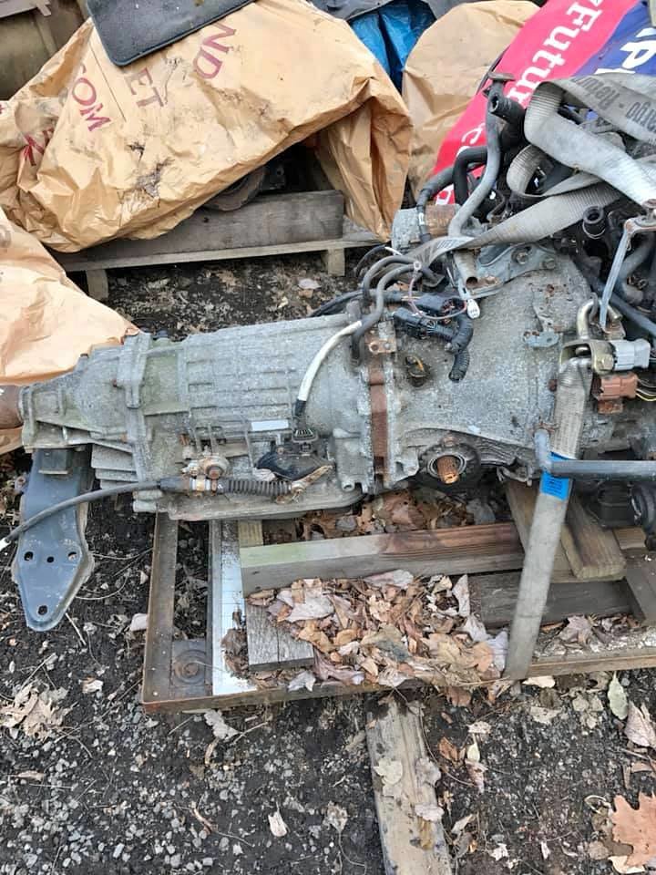

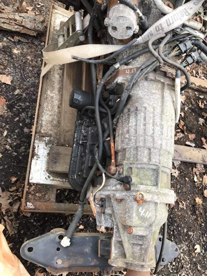

is there any reason to fear a transmission that was stored outside with the axle stubs in and tail sealed? i found a 100 dollar 123,000 mile 4.11 legacy transmission.
Bugs and animals leave debris and weather exposure. Probably fine but there’s definitely room for stuff to happen.
How long has it sat and where?  10 years on a weedy, shaded, over grown, cluttered side of a building is different from a clean, dry area with less debris, vegetation, etc.
heres the 2 pictures. the guy said its been there for a couple years and it was covered but not sure with what.
