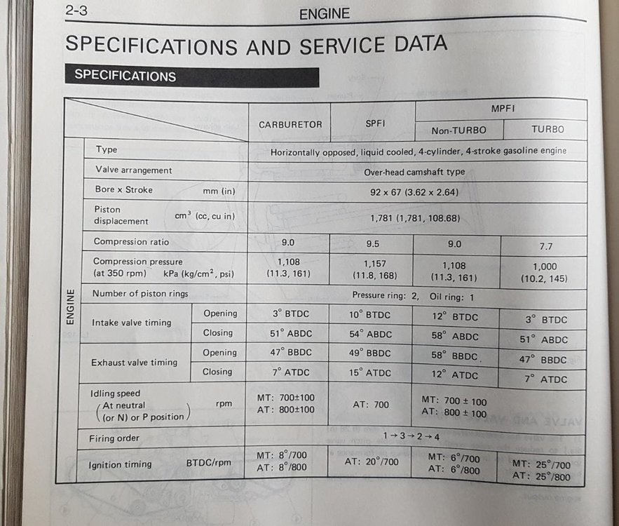

Are you sure it’s 25 degrees before TDC? I remember my MPFI being 20 degrees BTDC.
Might be worth adjusting and seeing if the behaviour changes.

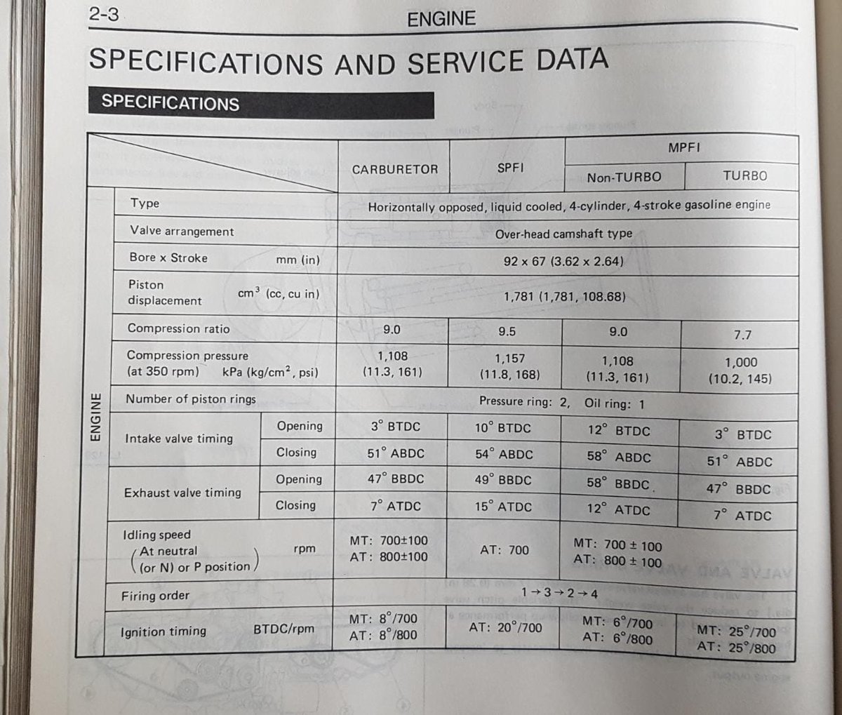

You know.. I just had a moment of realization..
So the FSM indicates that ignition timing is 25 degrees BTDC for a Turbo MPFI AT.
But now, my car is NO LONGER turbo. I removed the Turbo, I overhauled the engine with the right pistons to make it a non Turbo Car... An EA82 MPFI Naturally Aspirated. So I'm thinking... Should I then set the timing all the way back to 6 degrees BTDC in this case!!??
I've learned the hard way with these cars that timing that is too far advanced will make your car run and idle poorly. At least that was certainly true with my '88 SPFI Wagon. The whole "computer" in these cars complicates it some, at least between the ears, for those of us used to carbs, points, etc. I say that about the computer because in old cars, a vacuum can for a high performance car is different than one for a base car, and so is the total mechanical timing curve.
One would think the settings would be different for timing, etc from car model to car model and ECU to ECU since the "computer" supposedly controls ignition advance, at least from what I've read on here. In other words, are you forcing a Turbo ECU to work with a non-Turbo engine? If so, does it really make any difference at any setting, including at idle when you connect the green connectors? Just throwing that out there since timing CAN obviously cause driveability issues.
Just in general principle, I'd start at 6 BTDC and go up from there. You'll find the sweet spot with some trial, error, and logging your changes.
Edited by subaru1988
Try 8 degrees like the carb.
Looking at the valve timing The Turbo cams have the valves open for less duration that the MPFI non-turbo.
The valves are open longer with the non-turbo cams.
The Turbo forces air into the cylinder so the valves do not have to be open very long. The NA uses the piston to pull air into the cylinder so the valves are open longer.
The ECU controls the injectors as to how much fuel is added to the air going in.
It kind of makes sense that at higher rpms the pistons cannot pull in enough air and fuel to get a good burn. Or, am I over thinking it.
Back in the day, to get more horsepower we used cams ground to open the valve quick and hold it open as long as possible, then close it quick.
I’m no expert on timing but definitely time it to non turbo fuel injection specs if they differ.

Ooh, this changes things!
The vacuum advance device in the distributor is different between NA and Turbo on the old flapper AFM units. This is to take into account when on boost.
As stated, cam profiles are different and the mapping of the ECU will be different, especially when it expects boost and it’s not getting it. I’m not sure if these RCUs were that advanced or if they just threw more fuel into the cylinder when it expects boost to be present.
Switching to the NA ECU probably won’t work either as wires maybe different and there is most likely more wiring for the turbo ECU for the knock sensor and boost readings.
Why was the turbo removed anyway? With the NA compression and modern high octane fuels you should be ok running the factory boost on those pistons if you can go back to the original boosted setup.
