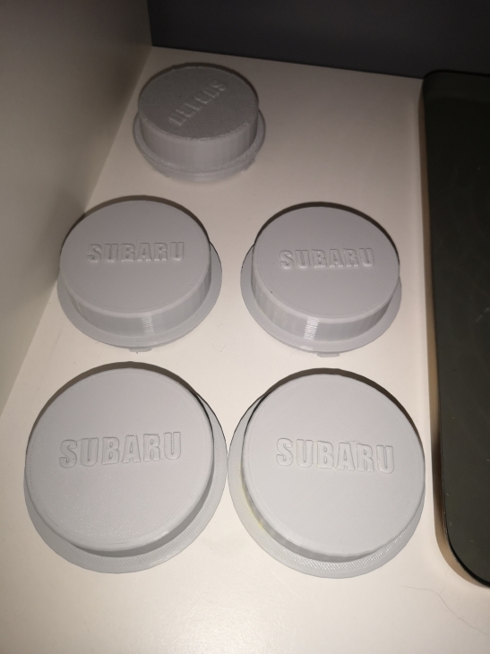

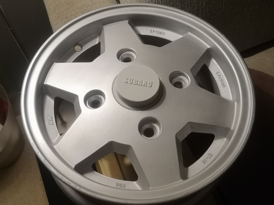

April 23, 20214 yr I did a thing with my 3D printer. have had these wheels for years without the center caps and decided that it's time to do them now:
April 23, 20214 yr Author 8 hours ago, tomhyyt said: have had these wheels for years Sweet wheels, JDM? Do they have name/brand or are Subaru? And the caps look nice on there.
April 23, 20214 yr 5 hours ago, 6 Star said: Sweet wheels, JDM? Do they have name/brand or are Subaru? And the caps look nice on there. I believe these are European made aftermarket wheels. 13" RW spyder markings as can be seen on the rim. I've seen couple of these sets available here in Europe

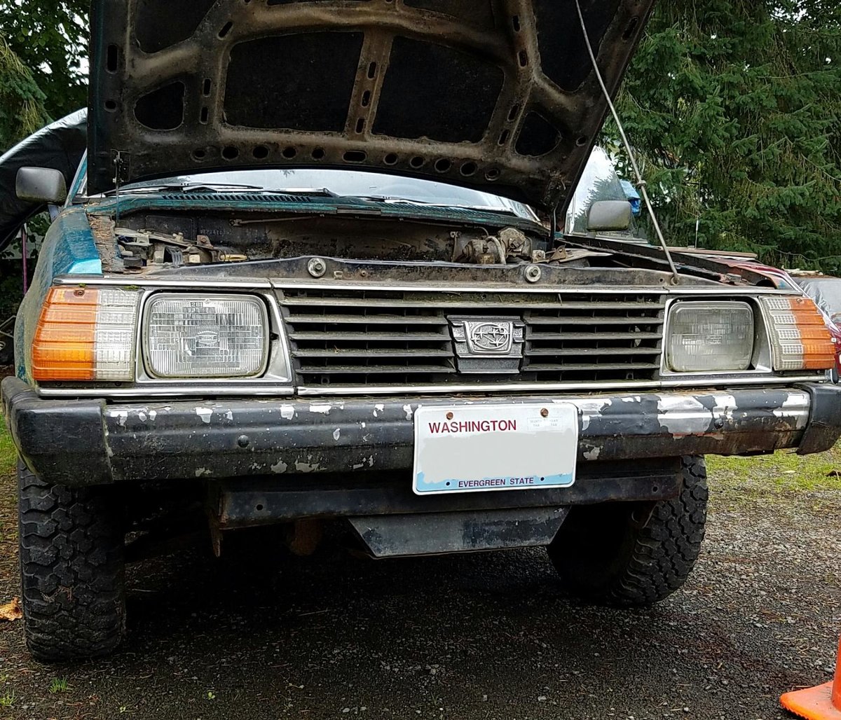

April 29, 20214 yr Author Been hard to start the '82 Brat recently. Usually takes a couple pumps of the pedal before it will cough to life. Strange, 9 times out of 10... when turning the engine over for several seconds with the ignition, it will fire AFTER releasing the ignition to the Run position. Only sometimes will it fire before letting go of the "start" position.. Cleaned the plugs, as they appeared to be fouled. Managed to start the Brat with only 3 spark plug wires connected. (D'oh) forgot to reconnect one. However cleaning the plugs did not solve the hard starting issue. Anyway, have been putting her to work hauling fire wood. The engineers made the size of the bed just right for the performance of the EA81... Loaded to the rails, conservatively, with wet firewood; the clutch is able to handle the load without strain or spinning, and the little EA81 torques right along. P.S. Added photos to my previous post. Edited April 30, 20214 yr by 6 Star Better description of Brat symptoms
May 1, 20214 yr @6 Star - you need a new ignition switch. You’ll find it’s not providing power to ignition when in the cranking position. Got a targa tip brat there too? Noice! They’re very sought after down here now. For me, just driving mine. 450km round trip last Saturday from central Vic into Melbs, our the other side then back again. Today headed down south for the Trentham spud fest, across to my old’s about 40km away then back home again. After that it’s back to the weekly duties to and from work. I need to regrease my front CVs. Not looking forward to that. Cheers Bennie
May 1, 20214 yr Author 9 hours ago, el_freddo said: @6 Star - you need a new ignition switch. You’ll find it’s not providing power to ignition when in the cranking position. Got a targa tip brat there too? Noice! They’re very sought after down here now. For me, just driving mine. 450km round trip last Saturday from central Vic into Melbs, our the other side then back again. Today headed down south for the Trentham spud fest, across to my old’s about 40km away then back home again. After that it’s back to the weekly duties to and from work. I need to regrease my front CVs. Not looking forward to that. Cheers Bennie That would explain a lot... Thanks for the tip Bennie. Will have to dig through the parts bin... Yup, she's no beauty queen, but she loves to do work and outdoor activities. Washing the '82 Brat is something I have NOT done to it recently, or EVER for that matter. Found her in the woods down by Tacoma, she had been sitting a good 8 years or more. All that was needed was a carburetor, as it was missing. After getting her home, installed a Weber 32/36, and flushed the fuel tank, she started right up. Couldn't bring myself to remove the patina... And the 3rd eye still works... She came with a 3" Lift Kit installed. The Trans Spacers are only 2", so the trans sits up slightly higher. No markings on any of the lift components... but the huge sticker on the back window is for Tough Country... possibly a custom order through them at the time of the build, whenever that was... 14" Pug Steels with Cooper Discoverer STT's And, she has the "Super Coil" that has the bonus techno box on top that somehow reads the position of the distributor and (recurves?) for the situation at hand. She just keeps on going... have lost track of all the things hauled and jobs done over the 5 years I've owned her. Regreasing CV's... something I should probably do to a few of the Subes...
