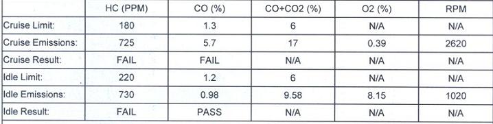

Ok now what do I do? They say my idle is way to high, its at 1400rpm! Its a ea81t and I have no idea how to adjust the idle? Any clues? I'm in a rut here... I was hoping to pass today, I can go back tomorrow and try it again. This really sucks.:mad: AND the car blew a cv joint. And it was reman cv joint.:eek:

Well i figured out how to adjust it and took it in. And I failed horribly!:boohoo: I dunno what i'm gonna do now. This car is a pos! Everything is going wrong lol, I'll just have to dump more $$$ into it. Its really fun to drive I just wish it ran good.:-\

my car failed horribly, then i got it good and hot and went back, passed with flying colors, get it good and hot and burn out that stuff thats been sitting in it for the las few months, get some new fuel and try again.

There's no limit on NOx? Sweet! Ok. Change your oil. Put a new air filter on it. Crank the timing up 5-6 degrees. Or more. Stop before it pings, well a little is ok for our puposes. Is the gas tank about a quarter full? Pour about 8 bottles of DRYGAS in there.
Changing oil removes fuel contaminated oil that the PCV is huffing.
Clean air filter= more air.
Timing increase gets fuel burning earlier so HC and CO go down.
Alcohol removes HC from equation, also lowering CO numbers.
Sorry, premium wasn't a good choice. It is slower burning, so HC and CO can go up.
Sorry for the choppy english. I get excited when I think about fooling "The Man".

Stop crying Matt. The car you have is MINT! Its one of the only running EA81T's ive heard of. Washington emissions cannot be THAT bad. Hell, if Eric can get a EA81 with a 32/36 weber to pass smog, im sure you (or someone who actually knows how to work on a subaru) can get it to pass.
Here are a few ideas:
Make sure your idle is within spec's
Make sure your timing is within spec's
Make sure ALL of your exhaust is 100%! The turbo might have a cat before turbo, and one after the turbo. Make sure they are good and not clogged.
Also, drive the car for an hour or so, get the catalytic converters good and hot before it is tested.... they work better the hotter they are.
And stop whining! If you dont like the car, sell it. If you want a carb'd wagon to lift... buy one. Don't ruin a perfect EA81T Wagon.
