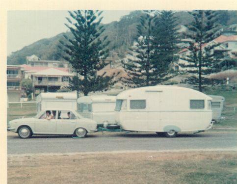

Don't worry the 1100 goes very good, had one of those to in the sport as well as standard sedan, the sedan would sit on over 70 easily and my dad's car would fit the family of 5 and still tow the caravan to the beach over a 1 hr drive then, i am going to see if i can post that picture here, i have on file, if it doesnt appear that means i don't know how to post.
Thierry
Thierry
Dear god that poor little engine...hauling that big camper.
:lol: good stuff!
I definitely like the blacked out center between the tail lights and the black bumper. Looks like a racer like that.
Thierry
Cool photo Thierry! Poor little Subie seems to be working very hard:grin:
Surprise surprise the car did it easily, 1100cc motor but performance better than the mazda 1500 of the same time.

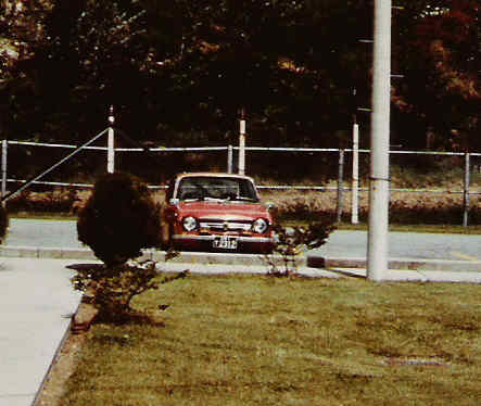

IMHO, there was no better setup for suspension and brakes on old Subarus (all the way through the stage2 leones) than the FF-1. The four wheel independent torsion suspension combined with the in-board front brakes and lightweight steel wheels made for one of the lowest unsprung to sprung weight ratios for a production car.
You have to drive an FF-1 to feel and understand how well they really handle and how much fun they are to maneuver. Even assuming it was possible to do it, reconfiguring the brakes or suspension (toward disks and struts for example) would be step backwards in fun and handling performance. The car is so light that even adding 5 pounds to each wheel would be noticeable.
At least try the stock setup first (for a comparison to anything else), and see how much fun it is.
-Cheers
P.S. I drove an FF-1 for 8 years (from '76 till '82) and did all my own work on it. Let me know if I can help with anything. I still remember the car quite well. I really wish I still had it:
