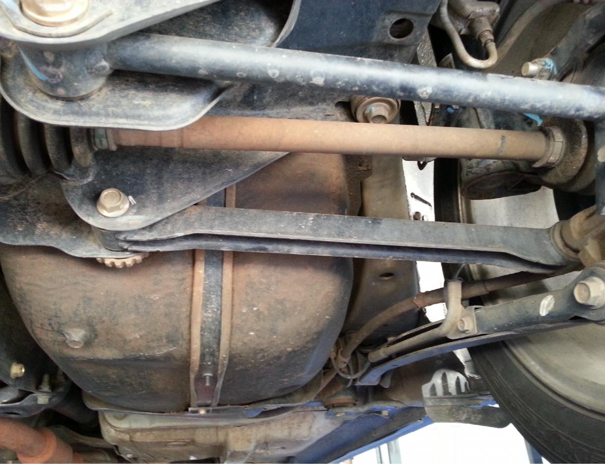

Trailing Arm Brackets - When performing a lift, the rear trailing arms start to pull the rear tires closer towards the front of the rear fender wells, as well as causing issues with suspension geometry. To fix this, trailing arm brackets that "move" the pivot point are required.
97-99 Outback trailing arm brackets have a pivot mount that is over 1" lower than an Impreza bracket, which will correct the geometry and keep the tire farther away from the fender.
Forester brackets have pivot points that are farther rearward, and move the tire away from the fender, but don't provide as much geometry correction.
Adjustable length trailing arms can also partially solve the trailing arm issue (See: Cusco and OBX trailing arms) but should probably also be used with Outback brackets.
"Spacers" for the trailing arm bracket. Some people have made custom spacers that lower the trailing arm down, which can be especially useful for cars with quite a bit of suspension lift and need more than the stock brackets can provide.
Note: I can't confirm this yet, but apparently some trailing arm brackets from various Impreza and Forester model years have DIFFERENT bolt patterns, I need more information on this.
Photo of Outback vs. Forester trailing arm mounts:
