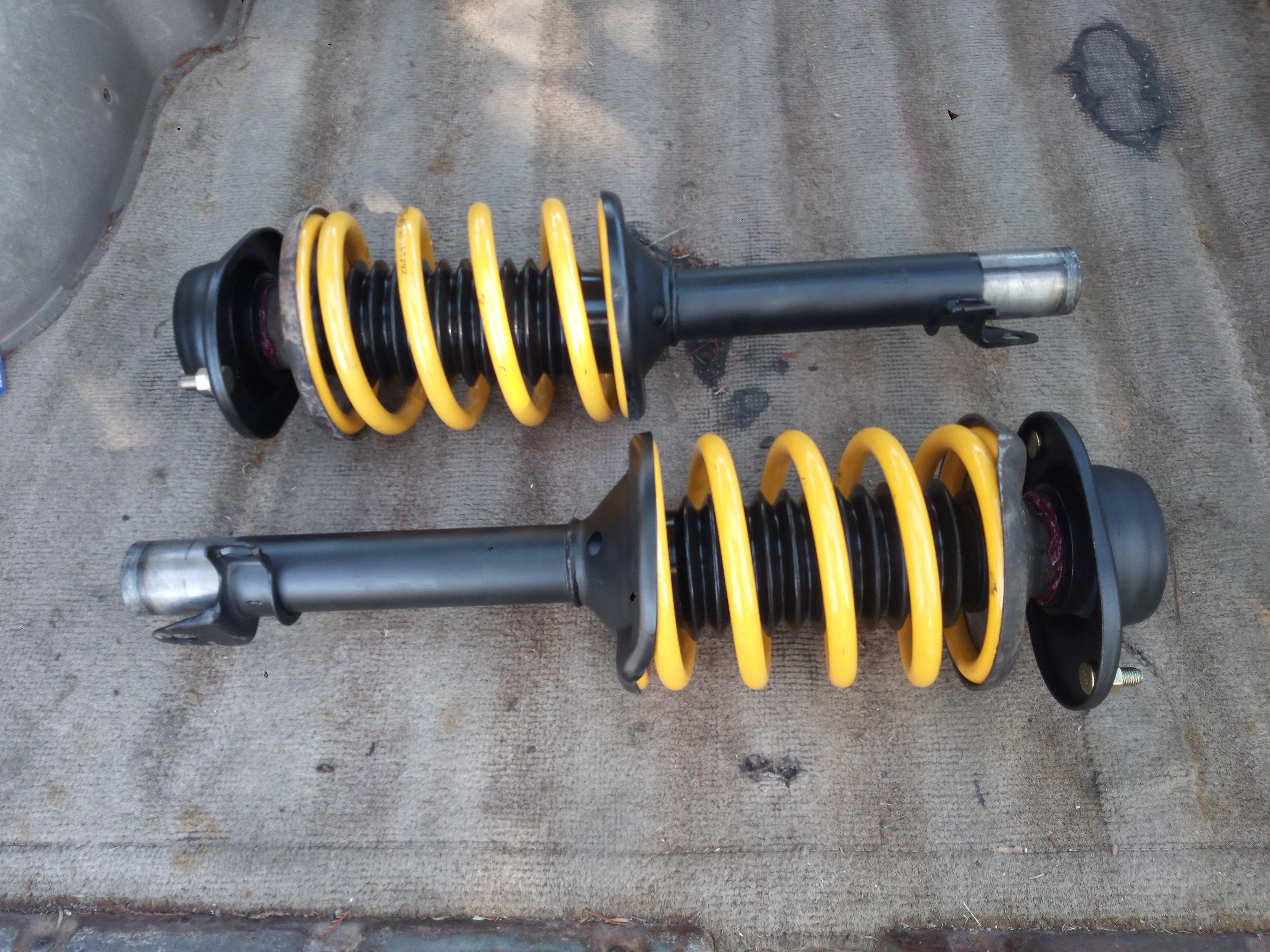

Good to know. I guess it goes to show that just reading through specs on the Internet isn't a substitute for checking things in person. Also turns out the Nissan Rogue struts are 49mm in diameter.
