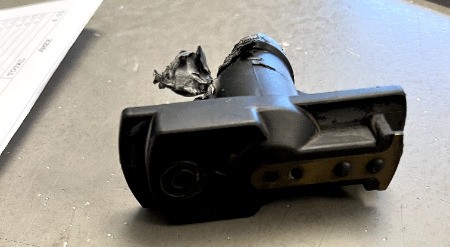

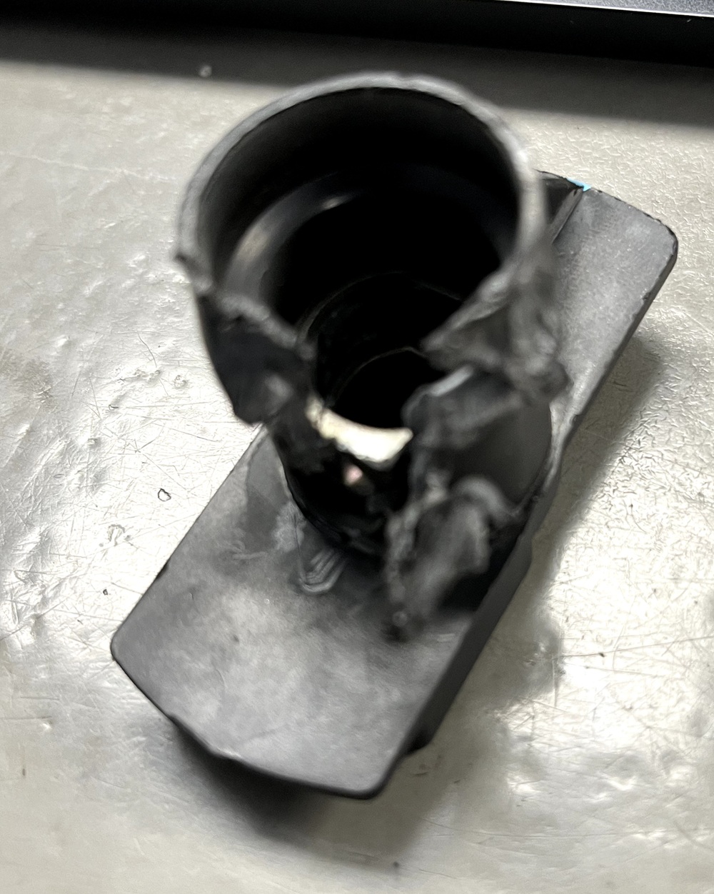

Howdy all, I have my 88 GL in the shop getting its engine resealed. I got an update from them an apparently the distributor rotor had melted in the distributor, or potentially tore it somehow? It wasn't melted/torn at the head, but at the base of the rotor head. Luckily it turns out I have an extra, however would anyone know why something like this would have happened? It was an older part, and I don't when it was last replaced, so it could be that it was just on the way out anyways. I hadn't had any issues with anything ignition or engine electrical before. I'm a bit worried that they're going to put the replacement in and the same thing might happen, it not immediately, maybe a few 100 miles down the freeway. Attached are some photos of the damage the shop sent to me. Any wisdom would be appreciated. Thank you! -Philly
