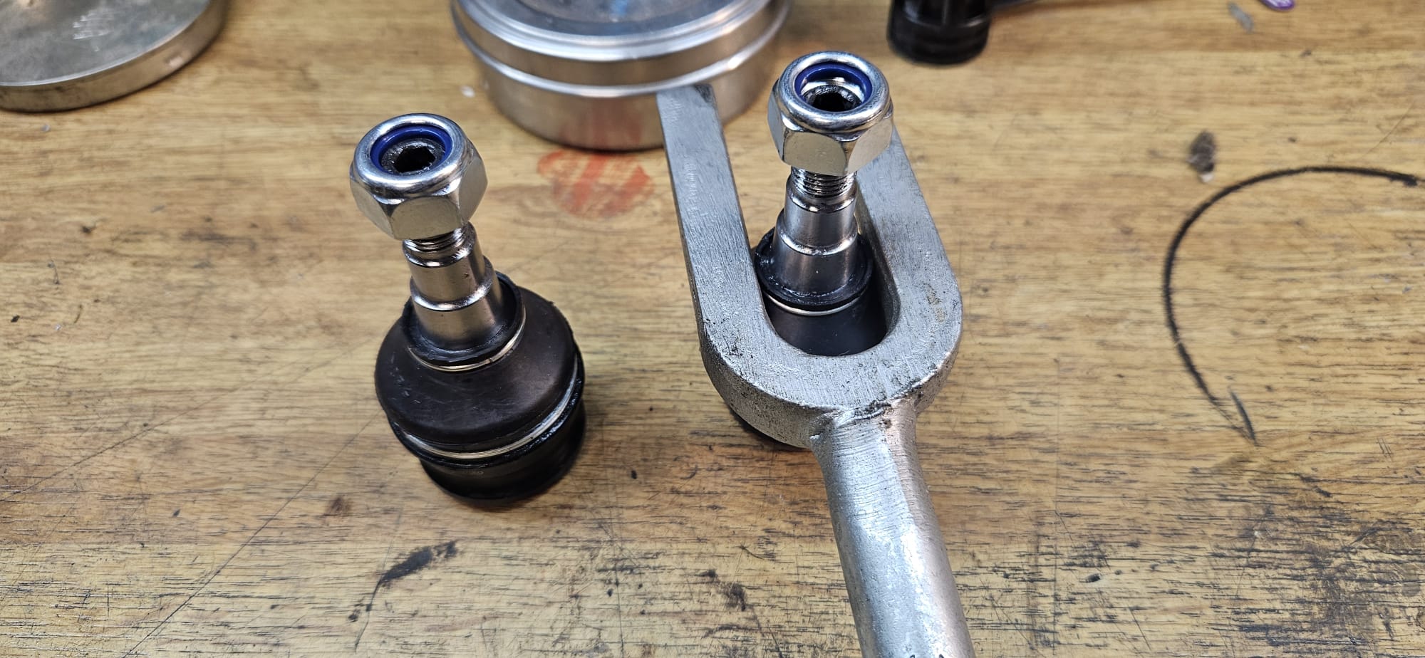

My 05 forester started doing clicks and clacks in the front suspension over low speed bumps, seems like its time for suspension ball joints. no fee play in the steering ones. Received already my skf joints, but before trying to install and getting stuck, some questions: 1. does my fork tool look like the right size and shape? 2.how bad is freeing the tapers on these? Car has no rust but the joints where never changed in 20 years.. 3.any other tips in terms of work steps? tnxs!
