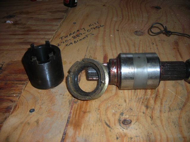

Dealing with right rear bearing 89 gl wagon
Photo attached, hopefully. Photo of the stubby shaft with bearing. Left side shows that nut that needs removed and what a pin socket looks like.
Short answer is no. To remove the stubby splined shaft, have to remove that nut on the backside of the knuckle. Right way requires something called a pin socket. Or if you are good with a hammer and punch, you can loosen it that way.
