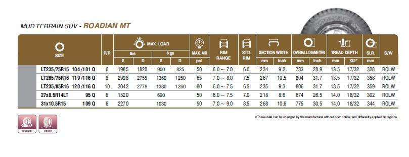

	I have these Nexen Rodian M/Ts on my 3/4 ton Dodge: I noticed that they list the 27x8.5-14 size in their downloadable spec sheet for the tire: However, it doesn't seem to be available in the US. Maybe a barrage of emails and calls to Nexen USA would get them to market it here.
