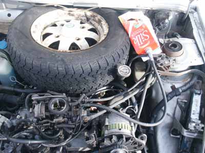

getting home with no fuel pump
archemitis replied to archemitis's topic in Old Gen.: 80's GL/DL/XT/Loyales...
oh ya, this only works with carbureted models. and you have to have the hose draining into the carburetor, the carb wont suck it in. the needle and seat inside the carb will stop the flow of fuel into the bowl, when the carb has enough fuel inside. -
i always say theres no way to get stranded in a subaru, especialy a carbureted ea81 with pushrods. say your fuel pump breaks, shorts out, falls off. theres no need to sit there like a chump and wait for the tow guy. idealy i would use an oil bottle so it doesnt disolve the glue on the paper, holding my soy milk carton together, but that was all i had. crawl under the car, and fill the container a little more than half full, use a knife, or even screw driver to bore a hole about half the size of the hose going from your fuel filter to your carburetor. shove the hose through the small hole, and it should seal pretty good. heres the crappy part, you have to vent the bottle, so poke a hole in the highest point(thats why you dont fill the bottle up all the way. so ya, you might have to do it a couple times, depending on how far you need to go, but it works! i also had a motorcycle gas tank i was going to use, but i decided i would have had to run it home with the hood in the back since it wouldnt close.
