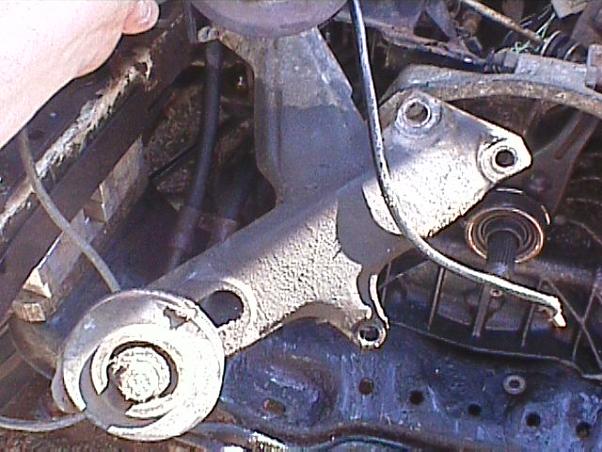

CV axle not fitting correctly
bratman18 replied to simpreza2's topic in 1990 to Present Legacy, Impreza, Outback, Forester, Baja, WRX&WrxSTI, SVXNo prob at all! I completely understand. I've looked at pics and done the same thing before. I'm glad you see it now though! Yeah and don't grow up too much! It's not good for you:)
bratman18 replied to simpreza2's topic in 1990 to Present Legacy, Impreza, Outback, Forester, Baja, WRX&WrxSTI, SVXYes that it there and in the center of the diff. side retainer (#12 in photo) is the stub shaft coming out of the tranny!
RX Tranny in First Gen. Brat
No there is no computer for this tranny. The wires are for reverse lights and other switches/signals. oh yeah and the hi/lo light too. But no there's no computer needed.
bratman18 replied to simpreza2's topic in 1990 to Present Legacy, Impreza, Outback, Forester, Baja, WRX&WrxSTI, SVXI think that maybe the angle is messing with you?! Again I still see exactly what I would expect to see. The end of the cv shaft that we see just needs to slide onto the stub sticking out of the tranny.
bratman18 replied to simpreza2's topic in 1990 to Present Legacy, Impreza, Outback, Forester, Baja, WRX&WrxSTI, SVXI personally see exactly what is supposed to be there. I think its just a little hard to see because it's so shadowy.
bratman18 replied to simpreza2's topic in 1990 to Present Legacy, Impreza, Outback, Forester, Baja, WRX&WrxSTI, SVXI see the male end sticking out of the tranny in the picture! And the female end (cv shaft) Just needs to slide onto it. And for whatever reason its not reaching. And yes the little hole circled is not a rust spot it's the hole for the pin to go through after the cv axle is in its correct position.
bratman18 replied to simpreza2's topic in 1990 to Present Legacy, Impreza, Outback, Forester, Baja, WRX&WrxSTI, SVX+1
