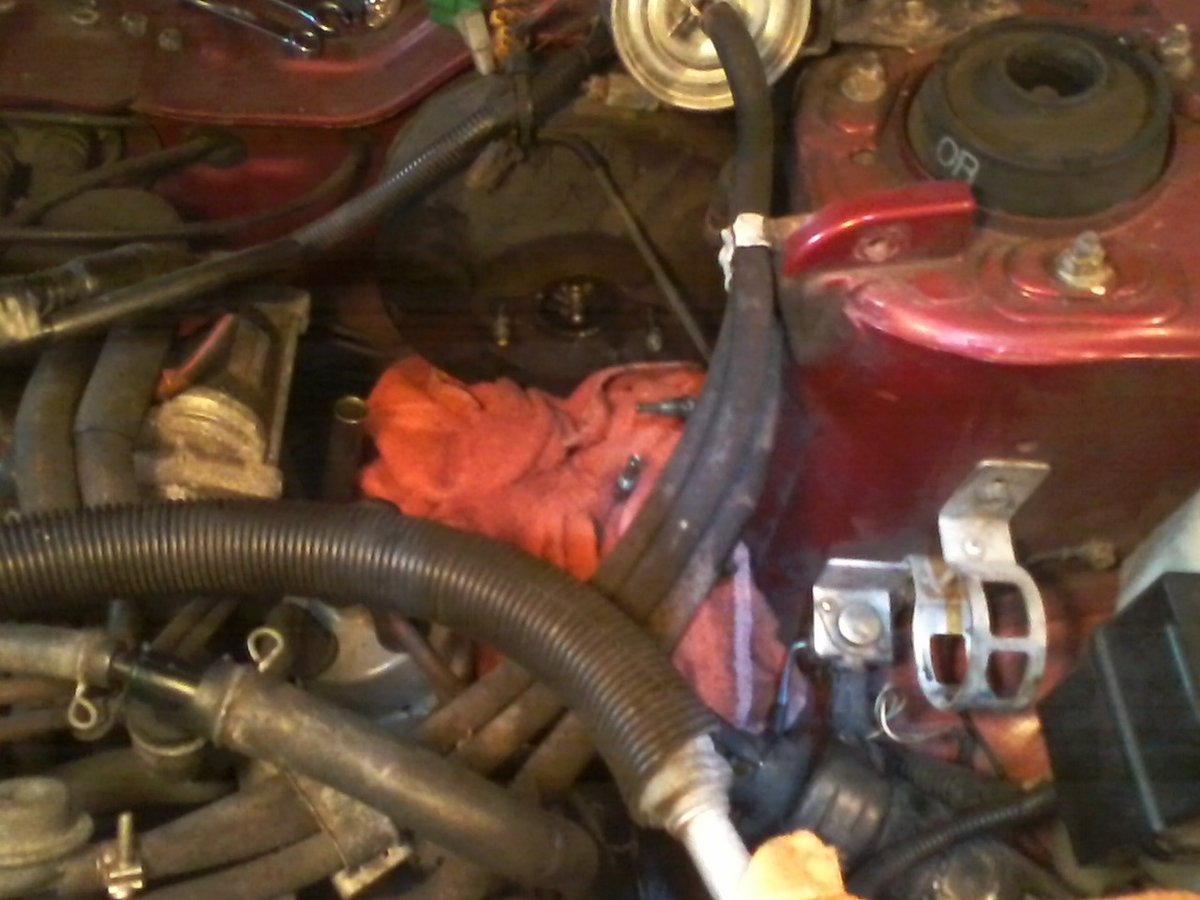

I tried to use the camera to see on top of the tank but it didn't provide anything useful. The lens only focuses about two inches and only when it is perpendicular to the object. Also difficult to direct the cable because of too many bends to get on top. Tried one more bleed to use up last of brake fluid. Didn't get any air bubbles from any wheel. Just clean fluid. Not sure about pulling the MC forward, it would have to be completely removed. In effect starting over...which is a possibility. To bleed the MC, I used the method described by CZNY above. -

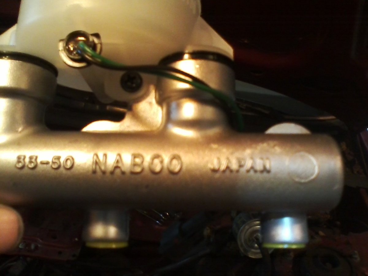

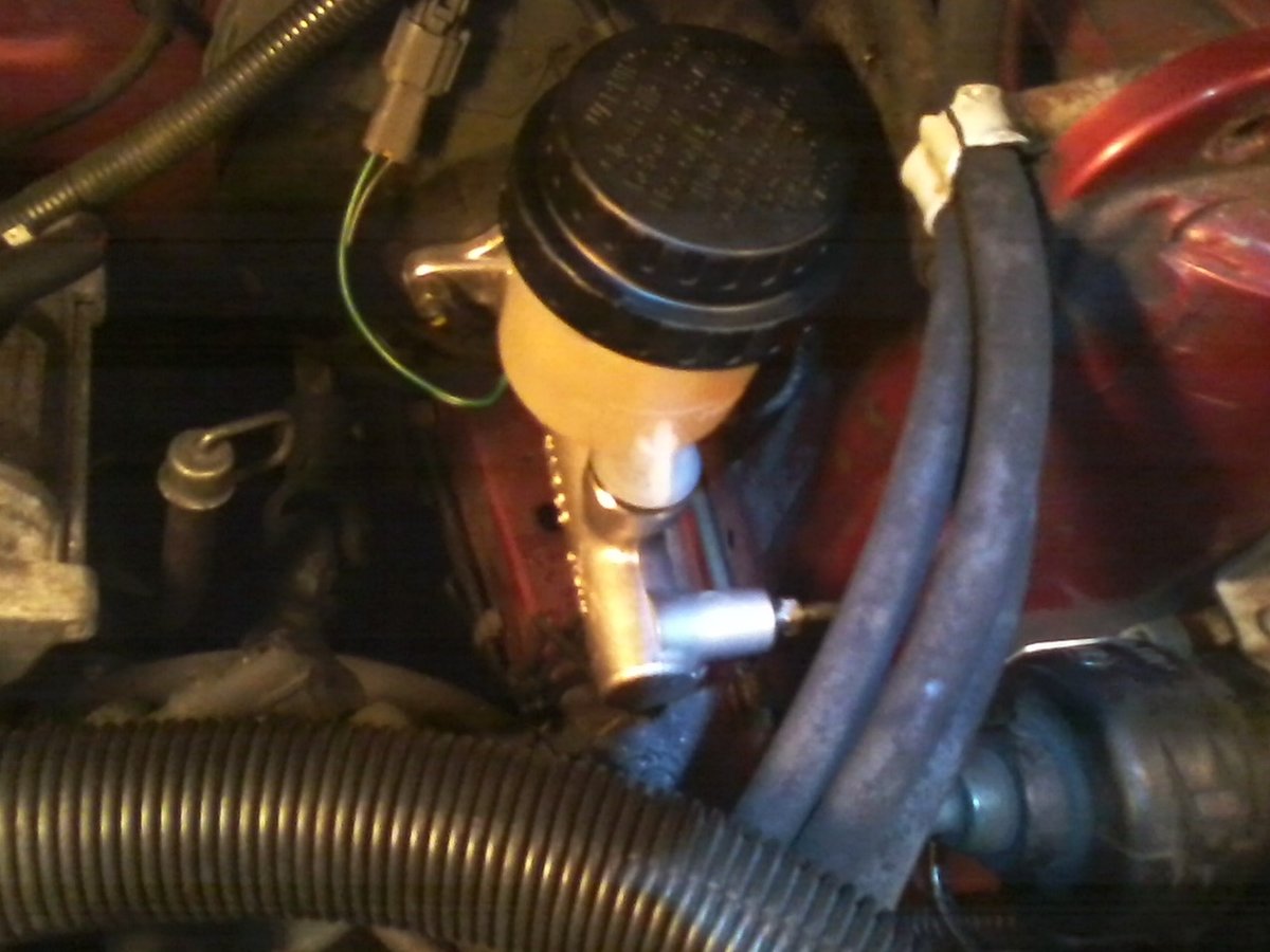

Well....Good news, bad news. good news. Finally got the part and time to work on it. Step 1 - get the old MC out Only had to move a few things out of the way - tire rack, AC line, battery cables and coil. The replacement is a Beck Arnley and is a new unit with a new reservoir and is made in Japan at a good price from RockAuto. I installed it dry and did a bleed on the car with the brake pedal. Only noticed some improvement, so I did a couple of brake line bleeds to see if that would help. Bad news... Pedal is still going to floor. I checked the brake booster and it seems to be working as it should be. I double checked the manual adjusters on the rear wheels. I opened a rear wheel and checked the brake pad thickness which is 3 to 4 mm. 1.5 is minimum. So, I'm at a loss. Not sure what went wrong. Planning on doing more research to see how best to diagnose this so I don't end up redoing things too many times. Also, I'm searching for the plastic plugs shown in the NAPA video to see if I can use those to block ports and test circuits separately. I can't seem to find those plugs. If anybody knows where to get some that would be helpful.
