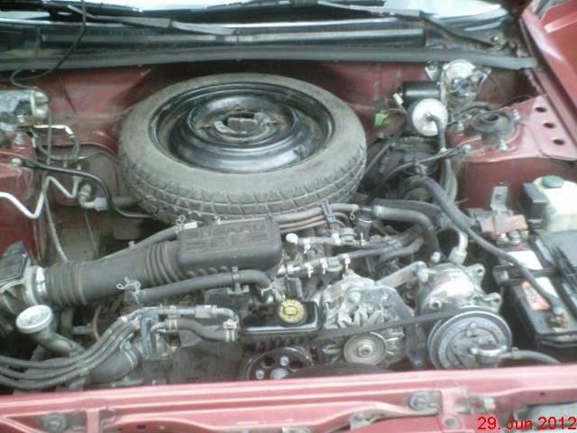

Ea82 alternator alignment.
Dee2 replied to 90loyaledasher's topic in Old Gen.: 80's GL/DL/XT/Loyales...
That looks correct. Below is a picture of mine. As I recall, at one point I lengthened the slot on the rear bracket on the AC so the AC could be pushed away from the alternator. This made more room for the alternator. You may need to do something like that if you can't find a belt to work. If you're not using the full length of the slot now, then the AC belt may be too short pulling the AC too close to the alternator. -
